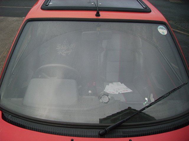

jord294 95 Posted November 26, 2008 since doing this conversion i've had no problems whatsoever i did replace the washer jets though, and i actually straightened the o/e wiper arm, but still use a 18"wiper blade hopefully you can make out the wipe line Share this post Link to post Share on other sites

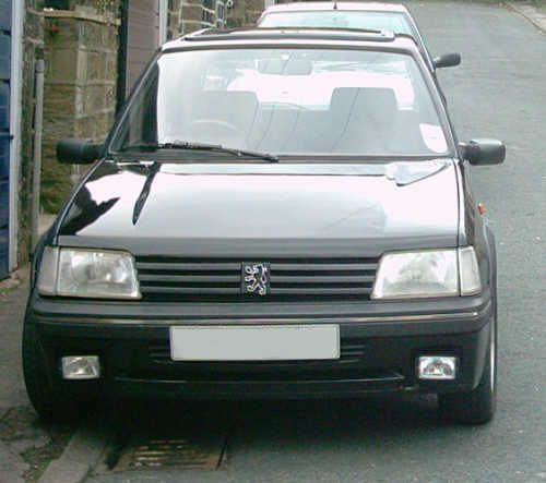

GLPoomobile 958 Posted November 26, 2008 I never had a single problem with mine, because I didn't cut it too short. It covered a sweep of about 150 degrees, so if you imagine where your tax disc would normally be, my wiper would sit above that and sweep to the same position on the drivers side. TBH, I think it looks gash (in hindsight). I removed mine because I never liked having the unswept section in the top corner by the A pillar (to the right of your field of vision when driving). It just annoyed me. Share this post Link to post Share on other sites
dirtdog 4 Posted November 26, 2008 That's exactly what I needed, cheers! What did you do with the hole for the other motor? Leave it open or cover it? I can't make it out in the pic' Share this post Link to post Share on other sites

jord294 95 Posted November 26, 2008 just trimmed a rubber grommet. it blends in well Share this post Link to post Share on other sites
