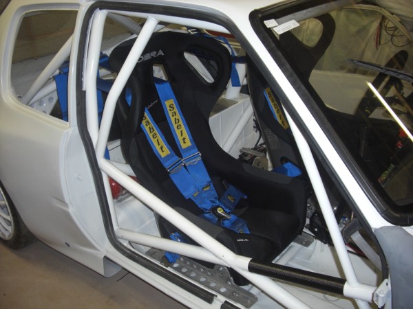

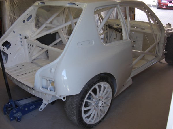

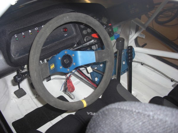

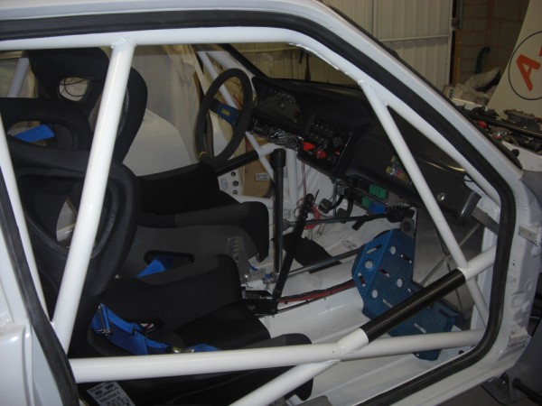

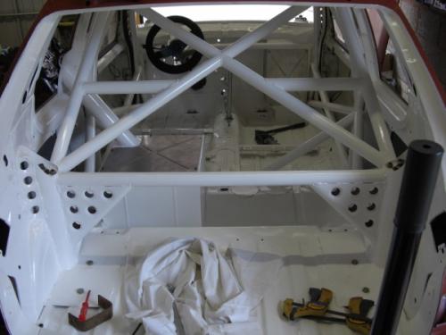

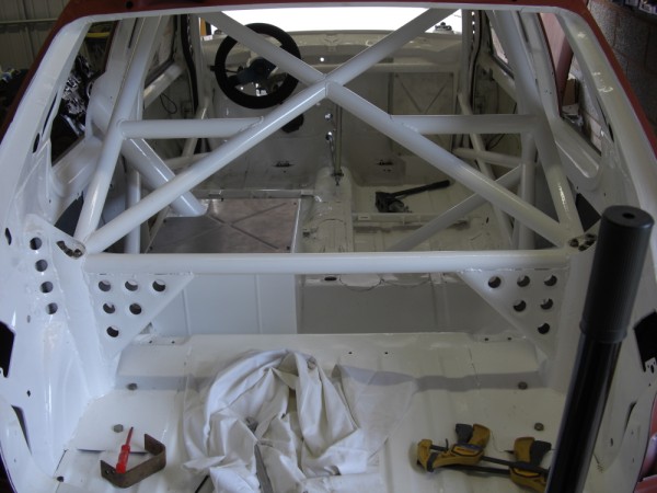

Hi, some pictures of my 205 project, nearing completion in the next few weeks.
Craigo
wow that looks fantastic, love the roll cage!! what engine is going into it?

I'm moist, despite it being LHD.
LHD, built as the factory intended, no brake master cylinder clearance issues, perfect line of travel for the clutch cable, good weight balance between driver and gearbox, lots of options for nice carbon dashes etc from France etc etc !

Where did you get the kit from? Whats the fit like? and of course how much did it cost?
maxirallye
Ordered it in from France, not sure of the cost with the current value of the euro, must be around £1200 with the carriage. Fit was crap, lots of work.

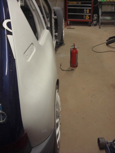

One more -

Looking very tasty. Thats an amazing amount of re-enforcing on the rear!

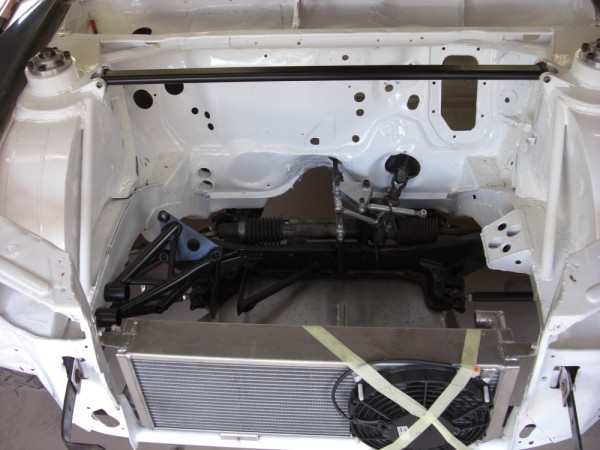

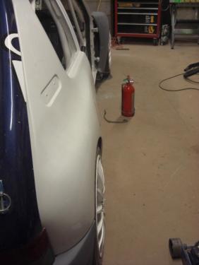

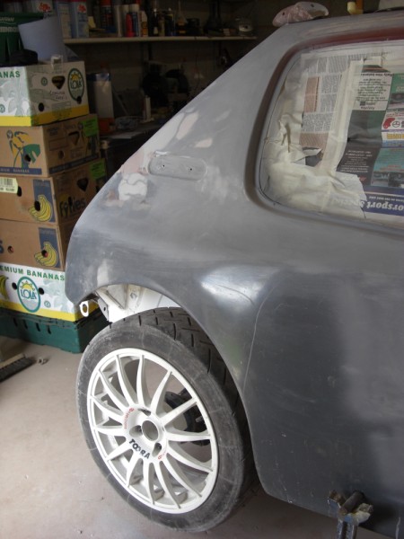

Whats with the larger inner arches? Did you need lots more clearance for running in tarmac spec?
Was that a LHD shell or just cutting out the holes that are there on the RHD shell?

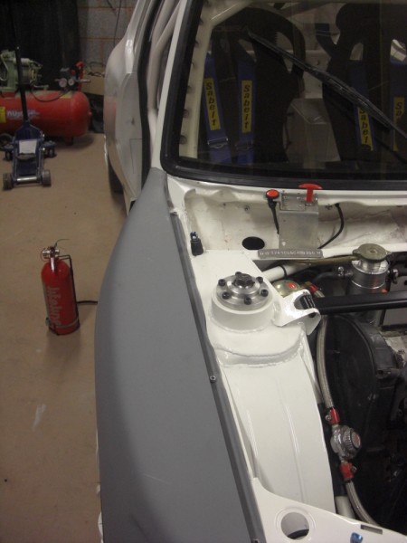

Out of interest what have you done in terms of wide tracking the suspension and what size wheels are those.
Also are you going to get it log booked before the end of this year or will it have to conform to the new 2009 rule changes?
Hi,
Rear is coilovers and tubes/rosejoints, tubbing of the front is so front can run as low as the back, clearance needed for the 17 inch slicks. Shell was originally a bare shell direct from France in LHD.
Cheers James
Hi James, front is tubes/rosejoints running aprox 406 width. 17 inch wheels.
Car should be log booked within the next couple of weeks, certainly would not pass after the end of the year with the re designed rear suspension, moved front strut tops, etc, and and would not want the extra weight penalty!
