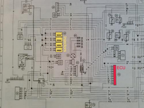

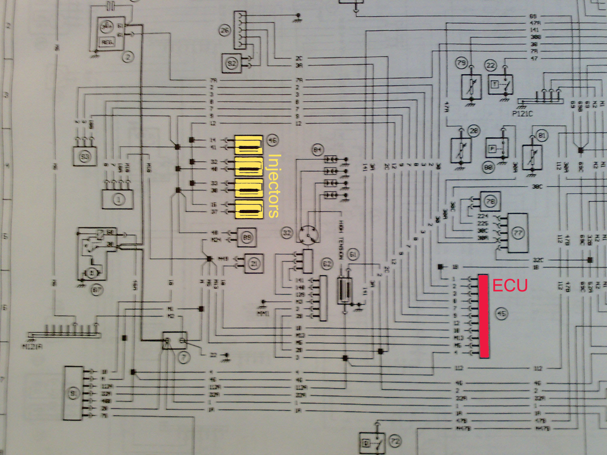

well ive taken a quick picture of the haynes as i cant find a relay in there, The wires just seem to bunch up and go to the ecu
89 is SAD
91 is Tachametric relay
93 is throttle switch
1 is air flow sensor

Tachymetric relay would be my suspicion, as that supplies power for the injectors as well as the fuel pump
Check that you've got constant +12v at one of the thick wires on the tachyrelay plug (brown IIRC), +12v switched ignition at one of the thinner wires (yellow IIRC) and an earth (green IIRC). The constant feed comes from the black power distribution box under the bonnet, and the switched feed comes from the brown multiplugs under the dash. Assuming that's correct all correct, you should get +12v at the other two thick wires (both white IIRC) when cranking or engine running - if you don't, the relay is probably shot.
You can test it by using a couple of bits of wire to short the three thick wires together, effectively giving constant power to the fuel pump and injectors. If it then starts and runs, you know the relay is definately at fault.
