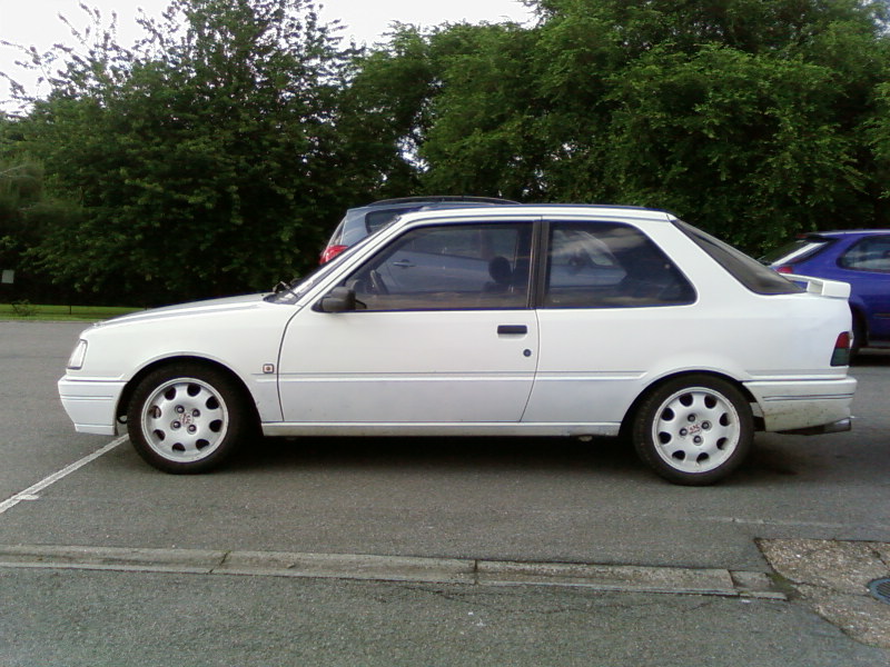

Rich_p 23 Posted August 19, 2008 Right I am about to get some 200lb springs made up for the front of the 309 track car. Is it worth getting them made any lower than the car currently is? (ignore the rear that will be reset to match the fronts when the springs are on.) I'm thinking maybe another 20mm or so lower than it is currently, so the arch sits just above the tyre? The car is not used daily so ground clearance isn't really an issue. I need to get the current springs sent to them (Faulkner) to help them make the new ones, alternatively has anyone had any made up that they could supply me with specs for? I'm assuming springs for a 205 will give a similar effect on a stripped 309? Share this post Link to post Share on other sites

brianthemagical 1 Posted August 19, 2008 If you start lowering the front too much it'll affect the roll centres and the section of the camber curve the suspension opperates in. So basicaly it depends on what suspension components you're running. If you measure the spring length at ride height then that should help no end in determining how the springs need to be made. Share this post Link to post Share on other sites
