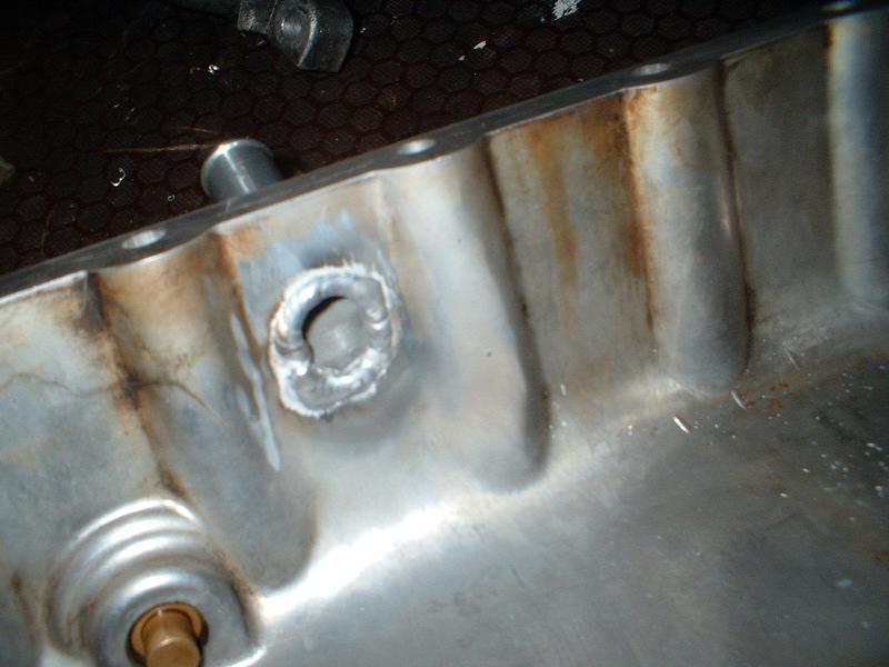

vern 0 Posted August 6, 2008 (edited) Basicly it is a piece of pipe welded/brazed into a hole in the sump, I have a genuine brand new TT pipe if interested, or I have a black powder coated sump, with a pipe that needs properly brazing in as it is only soldered at the moment. Edited August 6, 2008 by vern Share this post Link to post Share on other sites
pdd144c 0 Posted August 6, 2008 As Vern said, or weld a fitting into the sump and run a Goodridge style hose. Share this post Link to post Share on other sites

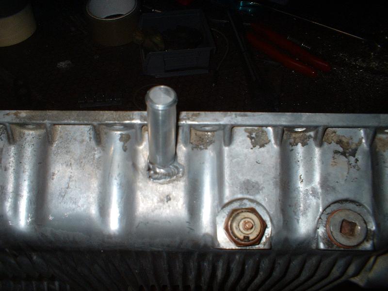

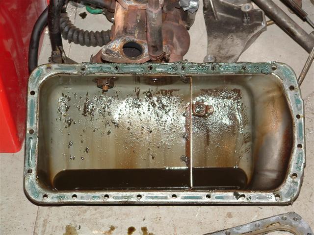

Henry Yorke 270 3 Cars Posted August 6, 2008 TT Sump with TT baffle My CTI Mi finned ally sump Share this post Link to post Share on other sites
saveloy 8 Posted August 7, 2008 What the hell is that Henry? What sump is that? It isn't an XU9JA item. You could have, atleast, put a 90 degree bend in that return pipe. Share this post Link to post Share on other sites
