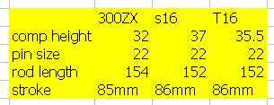

James_R 3 Posted July 24, 2008 http://www.306gti6.com/forum/showthread.ph...5829&page=1 This thread might be of some use, was amazed 300ZX pistons and rods woudl *just fit* (well almost) Share this post Link to post Share on other sites
M@tt 77 Posted July 24, 2008 nice find james. it's shame he had to go with forged rods in the end (due too too much float) instead of the 300zx ones as it would have been a great simple cheap source of uprade Share this post Link to post Share on other sites
James_R 3 Posted July 24, 2008 (edited) Not had a chance to look in to it at all yet, but I was wonder if you use an 86 or 88mm crank would be able to use s16 rods, but I haven't looked to see the pin size of the 300ZX small ends etc... Be handy for anyone rebuilding a GTi-6 or s16 since cast bigger bore pistons aren't available, somthing I'm looking at in the future. *edit* Qucik hunt on the wossner site broght up this info; Edited July 24, 2008 by James_R Share this post Link to post Share on other sites
