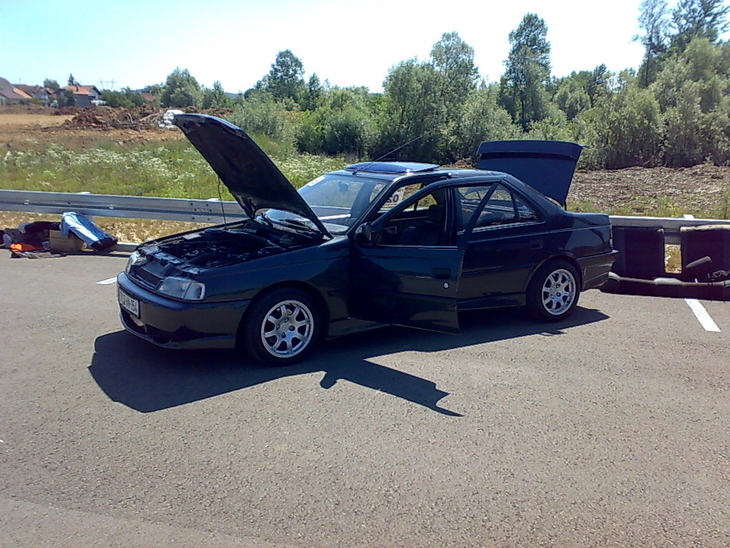

Sejo 0 Posted July 11, 2008 cybernck said: well, a couple of nights ago i drove friend's 405 Mi16 with a rebuilt DFW engine,petert's inlet cam (not sure which stage though) and petert's chip (along with some other mods, such as a thin copper headgasket and a XM throttle body) and i must say i was very pleasantly surprised as the engine felt very revvy and responsive and kept pulling strong to 7000 rpm (didn't dare to take it higher) therefore i can wholeheartedly recommend it . I´m proud to own the Mi16 cybernck is talking about Mods done to the engine as above, with peter`t-s STAGE I inlet cam. I`m more than satisfied with the power I have now. Cybernck-s words describes it as it is and I think this guy knows what is he talking about after having experience with cars like 205 Mi32 and 405 T16 Share this post Link to post Share on other sites
pete1986 2 Posted July 15, 2008 ^^ That 405 looks pretty slick ^^ cybernck said: well, a couple of nights ago i drove friend's 405 Mi16 with a rebuilt DFW engine,petert's inlet cam (not sure which stage though) and petert's chip (along with some other mods, such as a thin copper headgasket and a XM throttle body) and i must say i was very pleasantly surprised as the engine felt very revvy and responsive and kept pulling strong to 7000 rpm (didn't dare to take it higher) therefore i can wholeheartedly recommend it . So whats the benifit of a citroen xm throttle body? Share this post Link to post Share on other sites
Sejo 0 Posted July 16, 2008 pete1986 said: ^^ That 405 looks pretty slick ^^ So whats the benifit of a citroen xm throttle body? XM TB is bigger. you get approx 25% more air for the engine. Share this post Link to post Share on other sites
