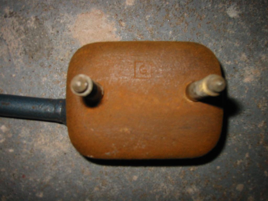

welshpug 1,682 Posted June 4, 2008 the offset of the 2 studs that go through the shell, on 1.9 ones that is, 1.6, base model and 309 ones are all the same and not offset (front to back) Hence why they are marked D and G, Droite et Gauche fit a 1.9 and 1.6 mount and the beam will sit on the piss, fit 1.9 ones to the wrong side and the beam will sit too far back. Share this post Link to post Share on other sites
Henry Yorke 270 3 Cars Posted June 4, 2008 (edited) 1.6 / 309 look like: _____________ | | | | | | | O O | | | | | | | ------------------ 1.9 look like: _____________ | | | | | O O | | | | | | | | | ------------------ Gold star to the first person with a pic of both side by side! Edit: Damn, the spacing didn't work!! Edited June 4, 2008 by Henry Yorke Share this post Link to post Share on other sites
welshpug 1,682 Posted June 4, 2008 cant do a pic of them side by side, this do? you can clearly see the letter "D" for Droite on the mounting and that the studs are not central, I can take a pic of the 1.6/309 brackets tomorrow If I remember. Share this post Link to post Share on other sites
Henry Yorke 270 3 Cars Posted June 4, 2008 Here is pic of a 1.9 one Share this post Link to post Share on other sites
