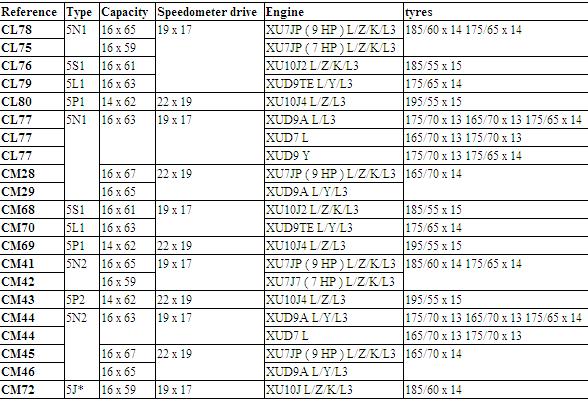

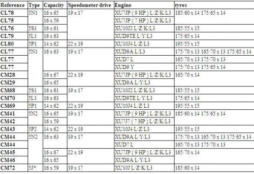

ifcho 0 Posted May 13, 2008 (edited) Here's a table from servicebox, showing the gearratios on the 306s Edited May 13, 2008 by ifcho Share this post Link to post Share on other sites
welshpug 1,680 Posted May 13, 2008 excellent!! which section did you find that in? Share this post Link to post Share on other sites
ifcho 0 Posted May 13, 2008 well it's from the repair manual's section. I found a torrent, containing the full version of the peugeot servicebox software...but I don't know if it is allowed to post a link here, so I haven't anounced this... Share this post Link to post Share on other sites
