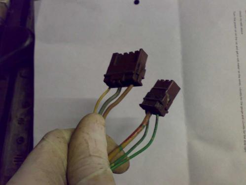

felix2566 2 Posted April 28, 2008 Could some one confirm that the plugs in the picture below are all earths from the fan? They are connected to the fan loom. Cant match the wiring up to my manual, but then it is (manul) for a 205 and my car is a 309! Share this post Link to post Share on other sites
welshpug 1,681 Posted April 28, 2008 there should be wires B85 from the shuntbox to the fan switch, then 58 + 58a from the switch to the fan + resistor, the M58 earth, with some wires thrown in for Diagnostic purposes Share this post Link to post Share on other sites
felix2566 2 Posted April 28, 2008 OK cheers, Will have a look at what numbers I have. How do you know all the numbers, you got the manual in front of you? What is the shunt box? Share this post Link to post Share on other sites
welshpug 1,681 Posted April 28, 2008 lol, yup! shunt box is the black box on the slam panel with a few fuses in it and takes power from the battery. same wire numbers and layout as the 205 in most cases though so the 205 manual will help you on the 309. Share this post Link to post Share on other sites
