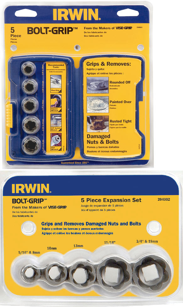

It will be tricky to get the old bolts out, I used Irwin nut removersand just went very carefully not to snap the bolt.
