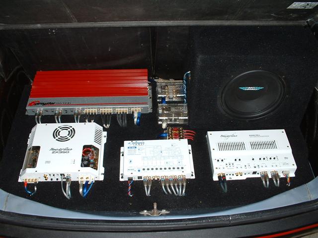

Most of my pictures are lost on Ben Allens site somewhere :( but here's a work in progress one:

i got to ask paint guy what are all the amplifiers running, are they running front and rear components to as well as the sub

No rear speakers in my car, as I find the 205 doesn't need them :)
The red amp (top left) runs the 1" tweeters and the 6" midbass units separately. It also has 2 spare channels to run a pair of 3" midrange speakers when I get the time to fit them.
The Phoenix Gold amp (bottom right) runs the sub.
The other two items are an active crossover, to split the musical signal before the amps so that each speaker only gets that part of the frequency spectrum that it can handle best, and an equaliser to help even out the frequency response.

i see i do like the sound of yours thats something i have never tried before with the equalizer and crossover units i have always used the standard settings on the amps and headunits, the only downfall i am finding with mine is the weight issue is so noticable the car lags so much now i want to keep them because of the work i put but at the same time i like the speed of the little thing and to go for something like yours little ten inch sub and some really good quality, im in a debate what to do
