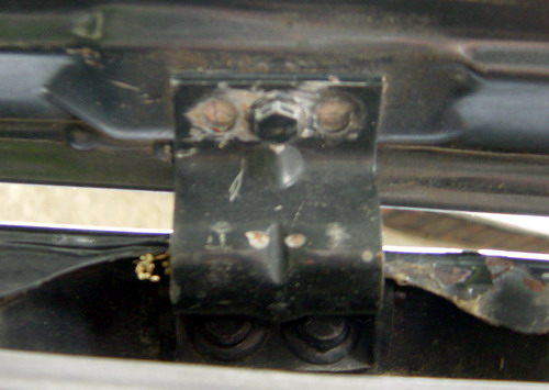

GLPoomobile 958 Posted February 18, 2008 (edited) Firstly, make sure your hinges are correct! The replacement tailgate I bought had had it's hinges removed and the bolt pattern was different compared to the hinges on the car, so I had to drill them out. You can get new hinges from pug though. On my replacement tailgate I had also had the wiring and washer tube cut (i.e. the person who removed it didn't want to waste any time doing a proper job). I have to confess I did it the cowboy way and cut my existing washer tube (leaving some extra slack) and used a washer tube joiner (one of those plastic tubes with barbed ends). Did the same with the wiring, and just crimped it all up the pikey way with bullet terminals. Also, be careful of your paint work when mounting the boot. I laid some towels over the rear edge of the roof to protect it. Edited February 18, 2008 by GLPoomobile Share this post Link to post Share on other sites

Atari Boy 11 Posted February 18, 2008 I need different hinges, grrrrr. Share this post Link to post Share on other sites
cybernck 403 1 Cars Posted February 19, 2008 ^ not necessarily, there are ways around it . Share this post Link to post Share on other sites
Atari Boy 11 Posted February 19, 2008 I think that might be the way forward, GLPoomobile has given me a tip or two on how to do it Share this post Link to post Share on other sites
GLPoomobile 958 Posted February 19, 2008 cybernck said: ^ not necessarily, there are ways around it . Exactly how I did mine. You have to drilll the hole/s you need into the hinge, because the tailgate has captive nuts that the bolts screw into, so you can't drill into the tailgate to match it to the hinge, it has to be the other way around. There should be casting marks on the hinge for the extra hole/s. I drilled mine oversize to allow for adjustment of how the tailgate lined up once in place. Get it right then tighten the bolts. As it was a rush job I just put a lick of primer around the holes to prevent rust and blocked the remaining holes with silicone sealant. Job done bit not a pretty solution. Share this post Link to post Share on other sites
