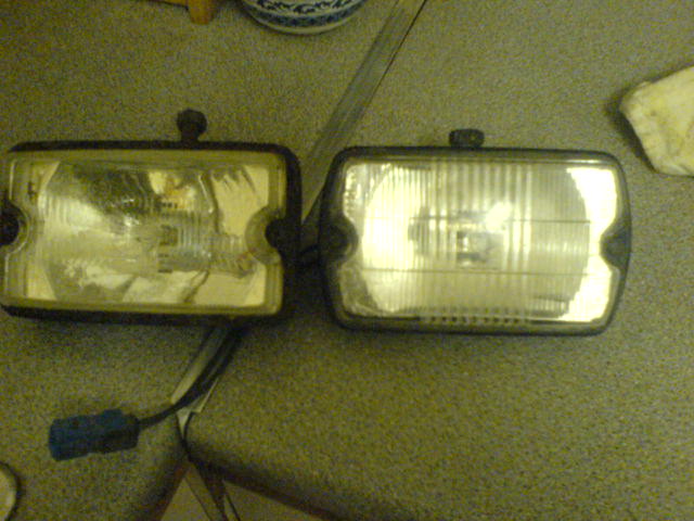

I have a couple of sets of citroen fogs ( cibie) which are very similar shape to the pug ones, and look exactly like the ones that were on a 306 s16 at the local scrappy. The mounts are for a different angle fixing, but I can see if they fit into a 205 valance if it helps?
Pug gti lamp on left for comparison

Yes they do, But you can just screw the lens into the 205 housing, easy as that
steve@cornwall
Just tried lens-swapping, no- go with the ones I have :D The lenses are slightly too tall, and the curve on the ends left a big gap. So I guess mine are similar to 306 type, but not exactly the same.
