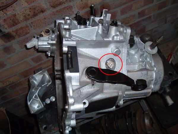

Ryan 99 Posted December 31, 2007 There's a switch on the front of the gearbox that controls the reverse light: Share this post Link to post Share on other sites
Ethos 0 Posted December 31, 2007 There's a switch on the front of the gearbox that controls the reverse light: Thanks for that... can it be accessed from on top of the car or so I need to get underneath? Share this post Link to post Share on other sites
Tom Fenton 1,650 Posted December 31, 2007 Reverse light is not part of the MOT. On the gearbox near the clutch arm is a switch that screws in, with a 2 pin plug attached. Exactly what it looks like depends on the year of car. If you unplug the wiring, and bridge the 2 pins, the light should come on if everything else is as it should be. If this is the case then it suggests your reverse light switch is u/s. Share this post Link to post Share on other sites
