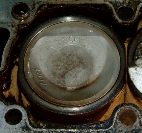

madspikes 41 1 Cars Posted November 10, 2007 (edited) Can I still use this piston? The marks are no deeper than the writing in the casting. Also is there anyone in my area Dorchester / Dorset can give me advice on which cylinder head I should look at rebuilding... and where to get it skimmed. Thanks Mad. Edited November 10, 2007 by madspikes Share this post Link to post Share on other sites
wardy18 33 1 Cars Posted November 10, 2007 ive got two block with pistons like this and will still be using them, as long as there are no filings that can come off and no other scoring on the liners it should be fine! Share this post Link to post Share on other sites

jeremy 71 Posted November 14, 2007 Just out of curiosity why is the piston so high in the liner? Share this post Link to post Share on other sites
