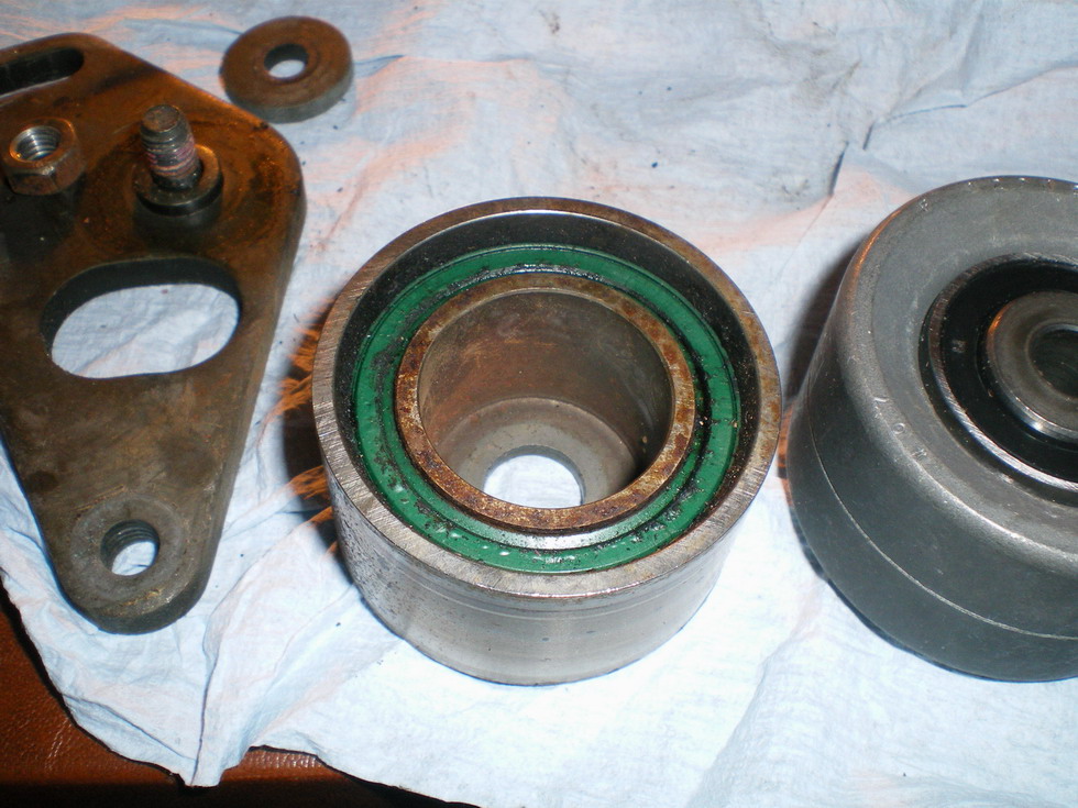

jerseypug 1 Posted October 31, 2007 it doesent look like a m8 bolt (that was included with the other tensioner) i have tried to include a picture) the one i am after is on the left Share this post Link to post Share on other sites

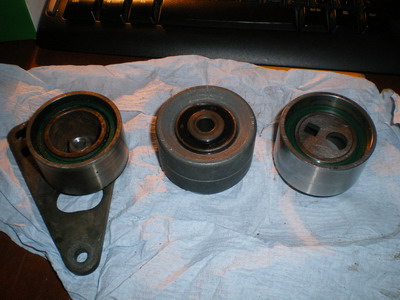

jerseypug 1 Posted October 31, 2007 this shows it better Share this post Link to post Share on other sites
welshpug 1,678 Posted October 31, 2007 what the?! 100% its an RFY lump?? Share this post Link to post Share on other sites
Miles 331 1 Cars Posted October 31, 2007 You have from left to right, S16 (XU10J4), GTi6 and all XU10J4R's and Mi16 and S16 etc used on loads of Pug's Share this post Link to post Share on other sites
welshpug 1,678 Posted October 31, 2007 very odd, that tensioner and bracket isnt shown on the datasbase! Share this post Link to post Share on other sites
Alastairh 47 Posted October 31, 2007 Yeah, as Miles said http://ben.loaded.net/gallery/view_photo.p...d=12102006361_G Al Share this post Link to post Share on other sites

B1ack_Mi16 67 Posted November 1, 2007 thanks for everyones help. i will try and get one tomorrow And just so you know, the front S16 tensioner comes complete with the plate. Share this post Link to post Share on other sites
welshpug 1,678 Posted November 1, 2007 And just so you know, the front S16 tensioner comes complete with the plate. so the part number I quoted a few posts back is correct, just that the plate isn't shown on the pictures Share this post Link to post Share on other sites
jerseypug 1 Posted November 24, 2007 just received the correct one. (disadvantages of living in an island) ended up getting a Citroen ZX 16v. just got to remember where all the pipes and connecters go now so i can get it back together. thanks again for the advice Share this post Link to post Share on other sites
