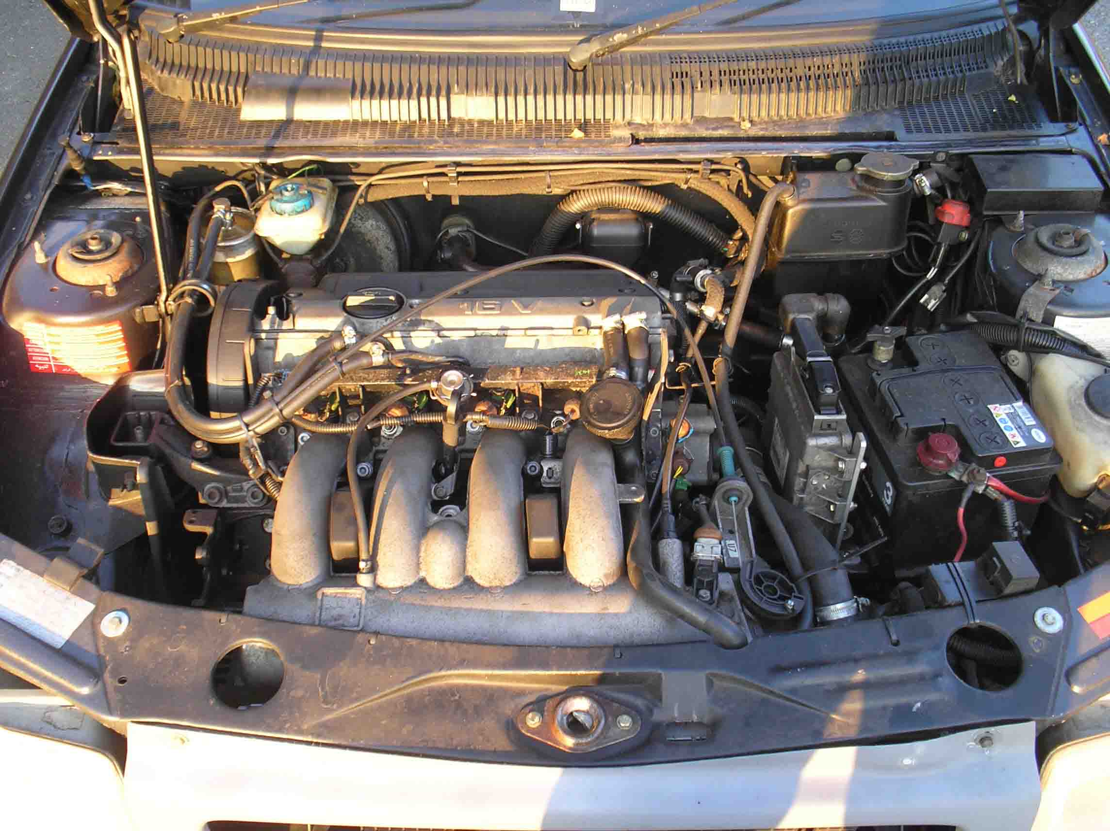

ross009 0 Posted September 26, 2007 (edited) Ive bin offered a 2.0 16v engine out of a 306 xsi for a good price and its low mileage but i didnt even realise the did a 16v xsi so am i right in thinking this will be the 135 bhp xu10j4r engine? is it worth putting this engine in my 205? i think i read somewhere its the same bottom end as the gti6 engine so if you get a gti6 complete head and inlet manifold it gets you up to somewhere near the 160 bhp they come with? also will i be able to use my 1.6 gti gearbox with this engine? whats the wiring like to put these engines in? any other specific things that need doin to get them in a 205? any advice on this would be great tks Edited September 26, 2007 by ross009 Share this post Link to post Share on other sites

welshpug 1,682 Posted October 1, 2007 the XU10J4R (or RFV) has camcovers identical to the GTi6 (XU10J4RS/RFS), but a black plastic intake that tapers towatrds the front unlike the gti6 wherre the runners are straight and alluminium. fitting is the same as fitting the GTi6, bar maybe the exhaust manifold, I cant remember who it is thats fitted one of these very recently on megasquirt. this engine is found in the 406 as you said, and nearly all P2 and all P3 306 XSi's, its NOT the S16 engine which is the RFY same as the 2.0 Mi16. earlier XSi's were 8v, i.e all P1's, earlyu XS's were 1.6 TU's, adn later ones were 1.8 16v XU7's. definitely and engine worth using, a more modern unit that the old Mi's and no oil starvation/surge issues. Share this post Link to post Share on other sites

Richie-Van-GTi 74 2 Cars Posted October 6, 2007 it is me that has one of these fitted on megasquirt, or at least it was on megasquirt. I used a gti6 exhaust manifold and had to drill a new hole on the lower mount fork about 1 inch further out so the manifold didnt knock against the bulkhead, then just hacked and rewelded a standard downpipe. Inlet side mine is on bodies so I cant comment on clearance here. The engine is quite tall in the engine bay and if you have an upper strutbrace Id suggest swapping to a small wasted spark coil from an AX or 2.0 8v engine and using leads, removal of the standard coil pack means moving the strut brace otherwise. The other coil pack plugs straight in though so not a massive headache to swap. Share this post Link to post Share on other sites
steve031286 0 Posted October 6, 2007 (edited) Hello m8! the inlet manifold does touch the slam panel so you will have to cut it out slightly. youl need to cut a piece out for the oil breather hose aswell! just so you are aware youl need to remove the battery and put it somewhere else if you want your air filter to be in the bay. other wise it will dip down by the gearbox like mine! not good in the wet! as for exhaust manifold clearence youl find just enough but its very close to the gear linkages. The coil pack cover on the top needs to be cut just a little for the brake master cylinder. i have a 1.6 gearbox with a gti-6 and it is awesom youl be really pleased with the results. mine runs at about 180 tho cos had few bits done to the engine aswell. good luck m8! Steve Edited October 6, 2007 by steve031286 Share this post Link to post Share on other sites

petert 616 Posted October 7, 2007 (edited) I've just finished help doing the same conversion, XU10J4R into 205. You need a lower top engine mount but it otherwise fits fine. We tossed all the std. management away and fitted a Haltech E6X ecu. Gearbox is 1.9L gearset with 4.06 CWP and Quaife centre. The exhaust downpipe bolts straightup but the radiator needed moving forward slightly, though not as bad as a full length Mi16 inlet. Naturally it goes heaps better than the 8V ever did. Edited October 7, 2007 by petert Share this post Link to post Share on other sites
