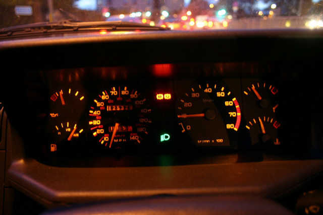

pug_ham 245 3 Cars Posted June 27, 2007 Veero said: Does anyone have a pic of what the gauge should be? I mean what temperatures the notches approximate to? See attached image for normal running tmeps but these are also dependant on what temp thermostat you have fitted, this is an 8v iirc. I have an 82' one on my car (also an 8v) & normal running temp is just below the fourth line as in the picture, maybe slightly lower than that but when it gets hot enough for the fans to switch on its sat two marks above there. Graham. Share this post Link to post Share on other sites
Veero 1 Posted June 27, 2007 Ah ok cheers Graham. Mine runs in the same sort of place when moving around, maybe a smidgen higher but climbs quite quickly when becoming stationary and the fan doesn't seem to keep it there and it will climb to the penulitmate mark fairly quickly in traffic if I don't turn the interior blower on full heat. Not sure what temp stat I got, it was the only 2 stage one listed for the XU9J4 iirc. Someone had a piccy of a French 205 temp gauge with numbers on the gauge itself? Cheers Veero Share this post Link to post Share on other sites
