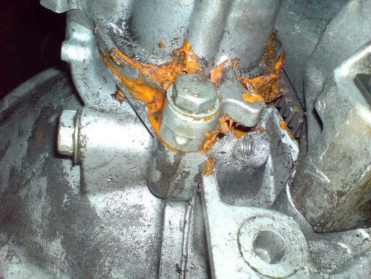

Ok I bought a gearbox that has apparently been rebuilt recently and stuck it on my car. Finally got round to filling it with oil today and the thing leaks...I was meant to be driving round Europe on monday for 3 weeks including a day or two at the nurburgring, so much for that idea!!
Anyway, what do i do? Its leaking from the diff area and as far as I can see the 'box has to come off. You can see in the pic that someones gone mad with sealant but unfortunately this hasn't worked. Also you can see part of the box has snapped off where the thread of the bolt finishes, interestingly there was another hole in the top of the bellhousing but figured it was small enough not to matter.

If the 'box performs reasonably OK, I'd go for option 2. It is not as difficult as it sounds.
Option 1 may not work for reasons below and options 3 and 4 are just too horrible to contemplate!!!
I say this as it looks like an unsuccessful attempt has been made to repair cracks and one wonders just what other horrors lurk within. To me it looks like a bit of the casting is missing completely as I can never recall ever seeing a part of the flywheel exposed like it appears to be in your picture.
Depending on what was wrong with your old 'box, you may just get away with swapping over the first and second line gearsets and not have to worry about the 'diff and resetting its preload.

Doof,
If it is just the speedo drive housing leaking, you can swap this (to get you going) very easily and you'll not need to take the 'box off.
There is a big "O" ring on the housing and I'll bet this is missing in yours.
I'd still strip and check it when time permits but that'll get you going.
A bit of chemical metal will seal the end of the broken thread.

thanks for the replies Jim, where exactly is this O ring? Is it in the hole where the speedo cable goes?
jim21070
On the joint between the diff case proper and the speedo drive housing. It is about 2 and a half inches in diamater.
Undo the three bolts that hold the speedo housing to the diff case and pull gently, the ring will then be seen.

It looks like the diff bolt has been tightened up too much and cracked the main box casing which make that case U/S I'm afraid but the pic might be telling lie's,

Am i being stupid by thinking about wacking a load of chemical metal around where its leaking?
Richie-Van-GTi
yes if you intend to travel long distance, you may end up stuck a long way from home with totally fubar g/box.

The bolts holding the speedo housing on were bloody loose, well not hugely but i got at least a turn on them with a spanner and the leak seems to have stopped!!!!!!!! I'm so stupid!!
The only worrying thing is the cracked off bit of thread and the hole in the housing at the top. I'm gonna try and fix it up so i can drive it tonight then go out and give it some serious thrashing to test things out.

Good result Lewis. A bit of chemical metal on the broken end of the threaded hole will be fine for now. Just make sure it is very well de-greased and it'll stick like the old proverbial. Don't use too much or you may never get that bolt out again....
