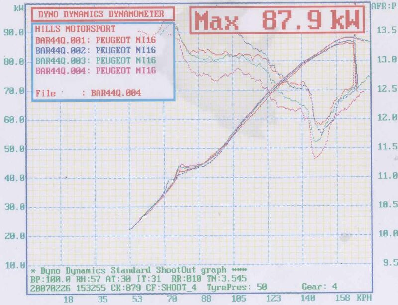

petert 616 Posted April 18, 2007 (edited) 4.1 is a 2 row, eg 139 1.3 is a 3 row, eg, 354, 161, 158 etc. From my experience, the 158 is the most desireable of all. Note this comparison between a 161 and a 158, 2 runs of each. Ignore the extended rev. limit on the 158, but note the broader and higher peak. Engine was Stage I cam and 10.8:1. Edited April 18, 2007 by petert Share this post Link to post Share on other sites
