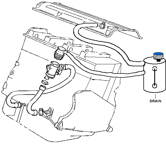

After a bit of thinking and searching i'm going to use this set up on my 8valve.
Should be fine and is pretty tidy.
309PUG
Hi,
Definately not, this is how I originally had it, you will be amazed how much oil passes through the cam cover pipe, it will fill your catch tank in next to no miles.
Mine is plumbed in like your sketch but the cam cover pipe is connected in its original position.
Chris
rescue dude
Hi,
Chris
Sadly i won't be surprised about the oil because i've had it all over my engine bay more than once. :huh:
Remind me where the cam cover pipe was originally?
309PUG
The cam cover pipe is fixed to the bottom of the oil filler pipe (has small 'T' piece for cam cover pipe to attach) near ish the oil filter.
Hope that helps.
