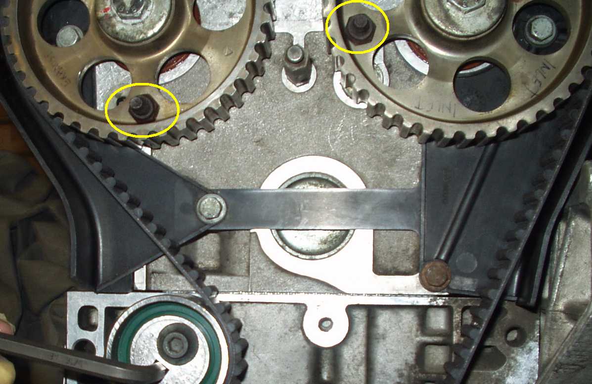

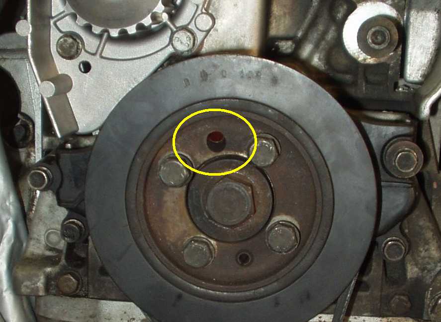

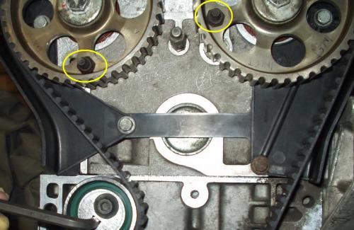

Higgy 0 Posted February 22, 2007 As Miles said, just lock the crank pulley and the two cam pulleys with drill bits etc. Then when you remove the old cambelt the engine can not rotate, so you can not screw up the timing. Here is a pic of my Mi16 with the cam pulleys locked (I used exhaust manifold bolts from the 8V): Here is the crank pulley. Either undo the 4 bolts and remove outer pulley or just place drill bit through circled hole and line it up with the slot on the block casting. Hope this is of some help. Higgy. Share this post Link to post Share on other sites

Higgy 0 Posted February 22, 2007 Ok got you. With the Mi16, you put the belt on, rotate the engine (socket on crank pulley bolt) a number of times then get the engine crank pulley back into its locking position, the cam pulley locking holes should (must) line up also. If the locking pins go back in, then your timing is spot on. If all the locking pins dont go in then the timing is OUT When I did mine there was something about lining up the white marks/lines on the cambelt with points on the pulleys. But I've just been through the Haynes, Pug & Cit rebuild manuals and can not find it. I recommend that if you are still worried, when you start the engine for the first time, disconnect the injectors and turn the engine over just a bit. Then re-check if the locking pins fit. Higgy. Share this post Link to post Share on other sites
