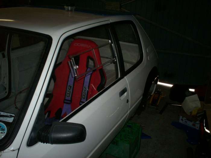

OMP cage (awaiting delivery)

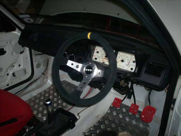

Mountney suede 90mm dish. £57 delivered, brand new seemed a good price to me. :rolleyes:

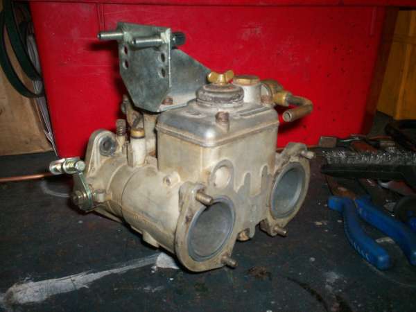

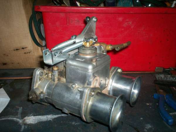

and some weber 40 DCOE
Before a rebuild: post-8046-1181813180_thumb.jpg
(still got another to do!)

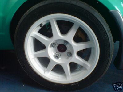

and my wheels, compomotive 16x8's
That will do for the moment but theres more bits on the way. :unsure:

they are not TH's look like Gp A Cosworth rims, very nice though
Jrod
Nope they are not Th's, I sold the Th's a while back. Indeed cosworth wheels they are. :rolleyes:
