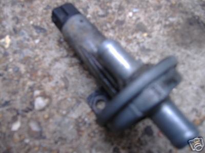

Guest BrainFluid Posted January 17, 2007 As said, on close inspection my car (1.6 gti) has no blooming SAD. After looking at a pic of one on the site that shall not be mentioned...where do the two coolant hoses that attach to the sad go to, I cant see a break in any around there so will need to trace back the way. Also I'm presuming that the electrical connector on the sad is the coolant temp sensor yes? Share this post Link to post Share on other sites

pug_ham 245 3 Cars Posted January 17, 2007 No coolant hoses attach to the SAD, just two air pipes. One from the bottom of the inlet manifold & one to the pipe between the AFM & TB. Even the Motronic cars have a SAD. The later models don't have the coolant temp sensor housing fastened to the thermostat housing which is what you might be missing. Graham. Share this post Link to post Share on other sites

Guest BrainFluid Posted January 17, 2007 Hey graham . didnt notice your post there I was going on this pic... Is that wrong? do you mean this one... I cant find either! Share this post Link to post Share on other sites
Guest BrainFluid Posted January 17, 2007 A-ha I see what you mean, that sad in the second pic is attached to the thermo housing in the first pic. I think I'll have a much closer look tommorrow as I fit the inlet manifold back on! Share this post Link to post Share on other sites

pug_ham 245 3 Cars Posted January 18, 2007 Nate, your car is a 1991 so it is very possible it won't have this; Why do you say its not the original engine? But it should have an SAD (second picture), on the later cars the pipe runs directly from the side of the thermostat housing to the bulkhead for the heater matrix & the SAD should be bolted sideways onto the thermostat housing underneath the dizzy. On the plate in the above picture for the middle thermostat housing. The picture above you posted goes to the two bolts after the pipe on item 1. The pipe from the SAD doesn't go the the TB but to the pipe running between the AFM & TB. If you've taken the intake piopes off, was there a pipe from the hose mentioned to the oil filler cap & another from the larger hole? That one should go to the SAD. Graham. Share this post Link to post Share on other sites
Guest BrainFluid Posted January 18, 2007 Thanks Graham, your a star you are! I know that the previous owner had the engine replaced. I'm pretty confident that I know what your saying. I can recall the pipe that comes off the hose that joins the AFM and the TB so I'll trace that back then. I'll be honest this is the first ECU car that I've ever owned. Its all so new but I'm getting my head around it all. Most of all, thank you for your patience! Share this post Link to post Share on other sites
