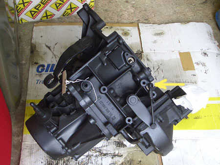

The easiest way to describe where it is on an STDT is on the block at the back to the engine side of the PAS pump mount & a nightmare to get to.
It bolts through the block in a cut out on the gearbox. I've only swapped mine from above & youare working by feel as you can't see the bolt you are aiming for.
See the yellow arrow for the cut out's position in the gearbox.
Graham.

Thanks for that.
