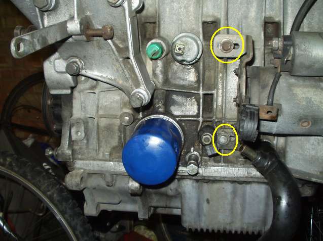

I had 8mm allens for the starter to gearbox. But I had hex head bolts to hold the starter to the block.
See here in yellow:
(I love the file attachment feature :P )
Higgy.

Wow, higgy. You mean you actually refitted that end plate with your starter? :P Mine went straight in the bin, it didn't fit the replacement starter as it was the newer smaller drive style. :P
