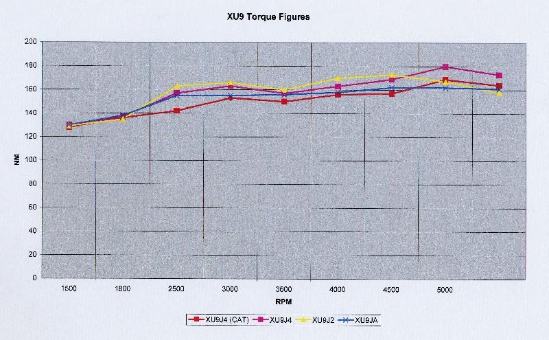

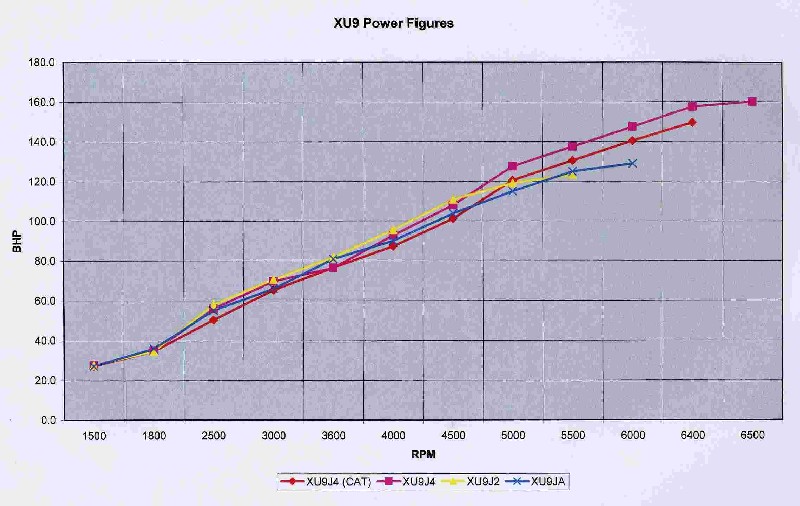

These are official - from that pdf:
(Courtesy of Grim.badger)
Looks like the XU9J2 is best as a daily driver!
Edited by KRISKARRERA

Those rollers read slightly lower than most, for example, Colin Satchell's 1.93 Mi16 gave 183bhp at the wheels there, but 200bhp at the wheels at Emerald previously. On some rollers I expect Huxley would see nearer that!
It's a much better head than most people think :rolleyes:

I should point out that those graphs are bodged a bit see
In defence of the XU9JA that super flat torque curve has got to count for something, plus it's a much closer match to the MI16 than I thought until about 5000/5500 rpm. As a daily drive I'd say the XU9JA has the crown as the graphs suggest a much smoother drive.
Sean, would you still say yours is technically an XU9JA as surely by changing the valve size and camshaft its not an XU9JA in the same way the valve sizes and camshaft distinguish the XU9J2 from the XU9JA (I think)? Maybe an XU9McKeown as it was built specifically for you?
Sandy
So let me get this right, you'd prefer less torque over most of the rpm range for a flatter curve? Strange boy.
The XU9J2 has the same valve sizes as the XU9JA and the cam has less lift on overlap, but the basic inlet port design is much better, using making good use more of the valve curtain area.
As a daily drive (pottering about town and motorways) I think it would be better, but I've not driven either of the Mi's so I can't really comment on the fun factor. I think I've driven the XU9J2 that was in a Xantia and found it annoying as the power wasn't consistent through the range and had flat spots. Thinking about it the engine probably wasn't in the best condition if it was doing this as it felt nothing like my XU9JA. Also having to pull a Xantia won't have helped :)
I would like an MI, at least for a while, but I think I'd start collecting points if I got one :rolleyes:
So it's just really the inlet and cam that's different on the XU9J2?
