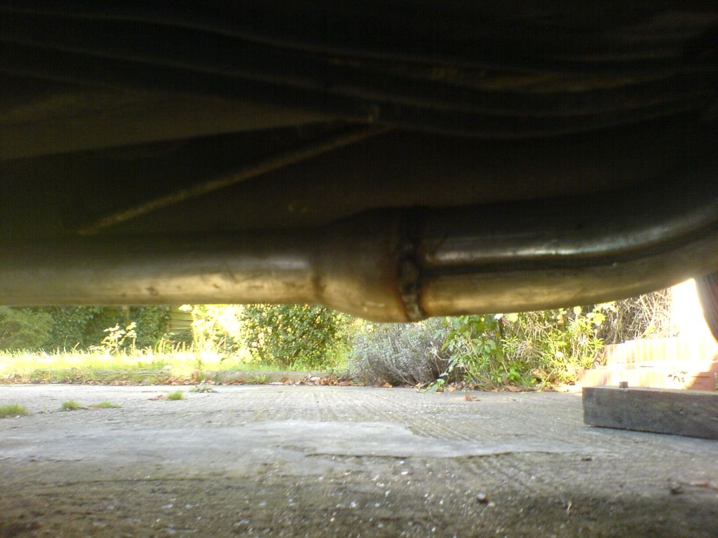

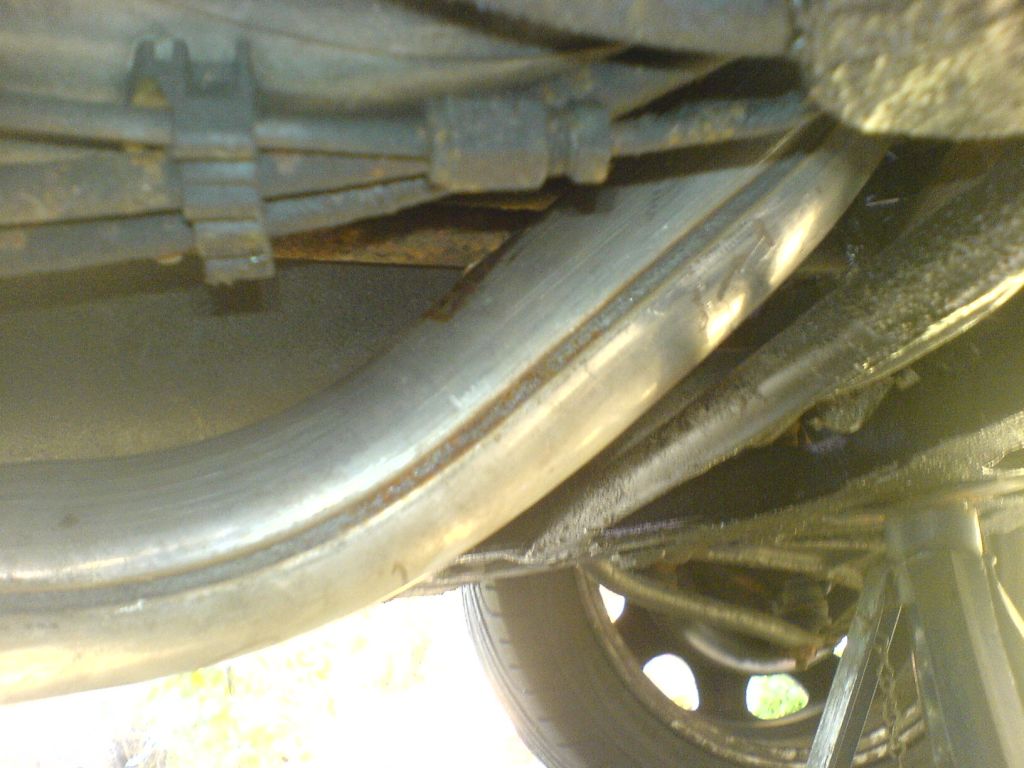

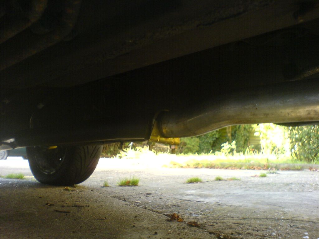

maturin23 10 Posted October 27, 2006 (edited) These are pics of the Arvin downpipe I fitted to my 1.9 Mi16-engined 205. Manifold was re-angled - bought from a guy on the forum who was supplying them on an exchange basis, but I just can't remember his name The exhaust is the one-silencer PTS Group N from Auto Five - (and I've realised that the bracket is not best positioned!) All fits without any cutting. It definitely hangs lower than it should, but given there's no central box I have no problems with speed bumps/car parks with a 30/40mm suspension drop. I'm very relieved it all went together nicely! Edited October 27, 2006 by maturin23 Share this post Link to post Share on other sites

jackherer 543 Posted October 27, 2006 All fits without any cutting. It definitely hangs lower than it should, but given there's no central box I have no problems with speed bumps/car parks with a 30/40mm suspension drop. whats the centre rubber hanger like? is the exhaust pulling it towards the back of the car or is it hanging vertically as it should be? Share this post Link to post Share on other sites

maturin23 10 Posted October 29, 2006 The central hanger isn't spot on - the exhaust and hanger are about an inch out - it's definitely not a perfect fit, but key for me was having a good downpipe/manifold joint, getting through that bulkhead/cross member gap without fouling and no contact between the silencer and the body at the very back of the car. It ticks all those boxes so I'm chuffed! God knows what is different to the old standard exhaust set up, but it fits better and I've not had the grinder out yet... Share this post Link to post Share on other sites
