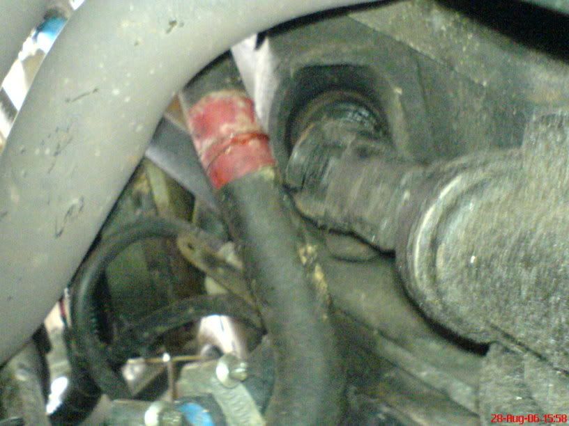

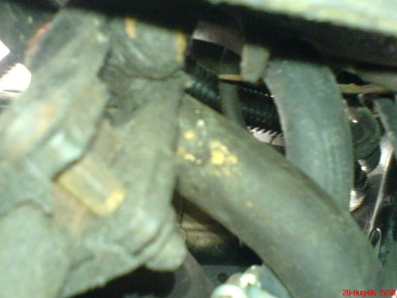

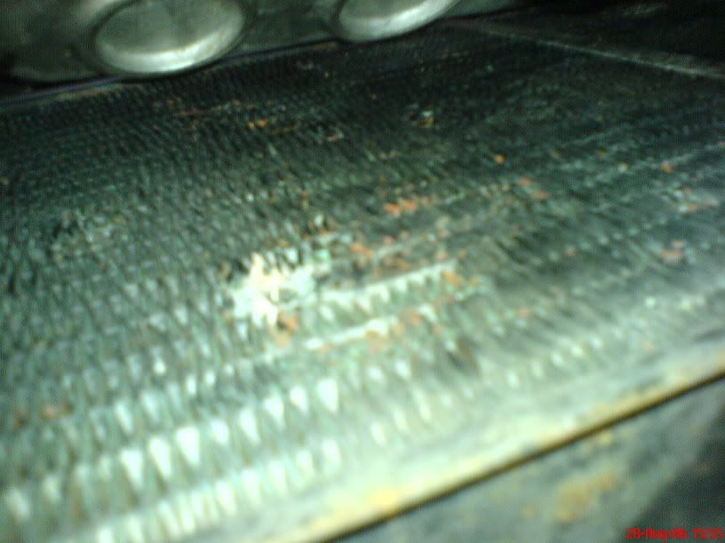

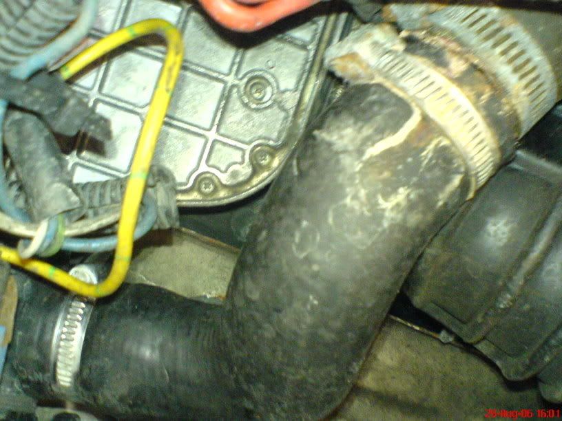

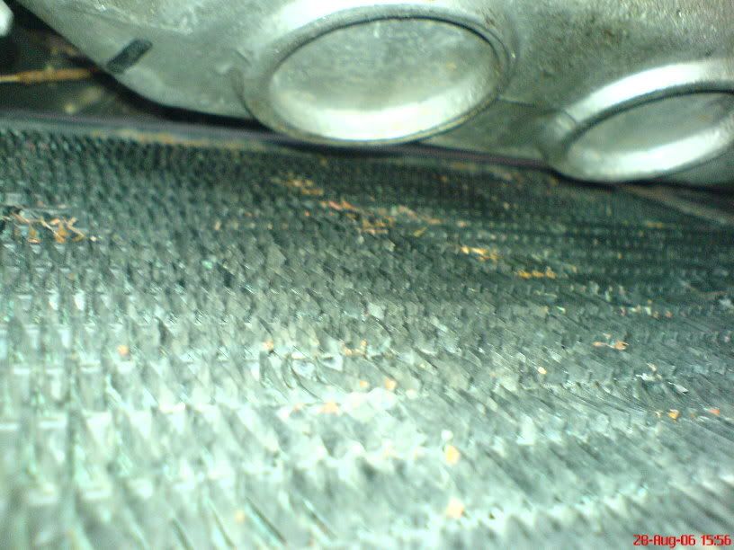

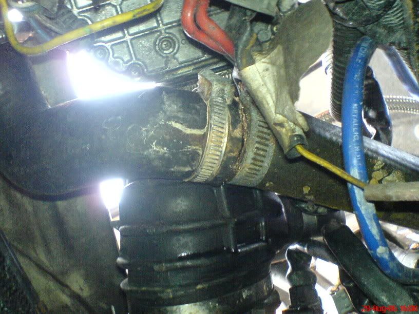

TaffyTim 6 Posted August 28, 2006 Started the car up this afternoon after driving it daily since my last coolant posts and again its almost empty of liquid. I found 5 mins and lifted the car up to see if i could spot any major leaks (after the coolant being topped up) and found a few areas that looked suspicious. 1st thing that came to sight was was the radiator: http://img.photobucket.com/albums/v645/taffytim/leak004.jpg then after taking this photo i noticed the top of the rad looked like its been leaking too: http://img.photobucket.com/albums/v645/taffytim/leak005.jpg then there was this pipe that came from the rad: http://img.photobucket.com/albums/v645/taffytim/leak011.jpg bit of a better shot of the join in the pipe!!! http://img.photobucket.com/albums/v645/taffytim/leak010.jpg I then noticed that theres a pipe going down by the steering column that is getting o bit of ware: http://img.photobucket.com/albums/v645/taffytim/leak007.jpg same pipe different angle http://img.photobucket.com/albums/v645/taffytim/leak008.jpg Any comments on these pipes and possible cause of water loss is welcome, as when i was down there with the engine on I couldnt see any obvious leakage. Share this post Link to post Share on other sites

M@tt 77 Posted August 28, 2006 the pipe that's joined in 2 looks a little suspect if you ask me thing to do would be to pop the bonnet up after having taken the car for a bit of a run which will allow the coolant to get up to temperature. You'll probably find it's only leaking under pressure ie when the engines running, and then have another look HTH Share this post Link to post Share on other sites
TaffyTim 6 Posted August 28, 2006 the pipe that's joined in 2 looks a little suspect if you ask me thing to do would be to pop the bonnet up after having taken the car for a bit of a run which will allow the coolant to get up to temperature. You'll probably find it's only leaking under pressure ie when the engines running, and then have another look HTH ok that makes sense, Ill have a gander tomorrow. Also good point about head gasket, this was my initial fear but im hoping its ok. Do i need to be looking out for white smoke from my behind to test this theory? Share this post Link to post Share on other sites
M@tt 77 Posted August 28, 2006 yeah white smoke and bubbles in your coolant expansion tank with the engine running and lots of mayo in the oil filler cap are the usual signs Share this post Link to post Share on other sites
welshpug 1,682 Posted August 29, 2006 just slap some red samco on there, that pipe at the back on mine wore through, took me ages to figure it out! plus the rest were pretty mank after 17 years! Share this post Link to post Share on other sites
TaffyTim 6 Posted August 29, 2006 just slap some red samco on there, that pipe at the back on mine wore through, took me ages to figure it out! plus the rest were pretty mank after 17 years! New set of Samcos! The cost of these mi's is never ending Would love to do it though. Wasnt there a group buy on the go, I'll go see whats going on there. Share this post Link to post Share on other sites
