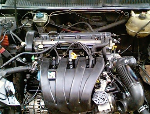

pugpete1108 62 1 Cars Posted July 30, 2006 just seen this on ebay and have also seen a few at my local scrappy: can the 205 engine mountings/gearbox etc be used to fit this engine in a 205? and what is the power output ? i think its from a 406 2.0 16v Share this post Link to post Share on other sites
cybernck 403 1 Cars Posted July 30, 2006 yes, it will fit . http://www.smallmove.f2s.com/16v205/articles/406.htm Share this post Link to post Share on other sites
pugpete1108 62 1 Cars Posted July 30, 2006 yes, it will fit . http://www.smallmove.f2s.com/16v205/articles/406.htm oooh oooh lots of questions, does the be1 box fit?, will a mi16 inlet manifold fit? (as i am going custom bike tb's) and the top mount ,is that the standard 406 jobbie ? also what sort of power do the creat as standard , and finally what is the engine code for this? cheers pete Share this post Link to post Share on other sites
jim205GTI 3 Posted July 30, 2006 Is that engine by chance also the one that is in the 306 xsi? looks mightily similar if it is the reputed power output is 140 bhp but ................. if it is one the 306 gti exhaust manifold is supposed to see some gains when fitted ...... i would do it to mine but want the mi in the 205 first Share this post Link to post Share on other sites
Miles 331 1 Cars Posted July 30, 2006 Yes it does fit, Use a 306 top mount as the 406 uses the extra brace to stop the engine moving around, 137bhp but will never make GTi6 power just by swaping manifolds. Any Mi inlet manifold will fit inc the S16 thing, the GTi6 exhaust is the best thing you could use on that side of things. ANy BE box will fit too, Just make sure if your using managment it has the TDC sensor hole as the early boxes don;t have it. There's quite a few small differnace between the XU10J4R and RS engine. Share this post Link to post Share on other sites
pugpete1108 62 1 Cars Posted July 30, 2006 is it not an xu engine then? Share this post Link to post Share on other sites
Miles 331 1 Cars Posted July 30, 2006 its a XU10J4R, the GTi6 engine is a XU10J4RS Share this post Link to post Share on other sites
pugpete1108 62 1 Cars Posted July 30, 2006 same as the xantia vsx 16v? , they dont look the same Share this post Link to post Share on other sites
Miles 331 1 Cars Posted July 31, 2006 Depends on the year the early VSX used the XU10J4 engine, around 1994/5 this was used, After that it was the XU10J4R engine, The early one shares the engine with the Phase2 405 and 306 S16 Share this post Link to post Share on other sites
pugpete1108 62 1 Cars Posted July 31, 2006 went back to the scrappy today and i think they are all 1.8 16v s the code on them is : RSA LFY so i a, guessing LFY which is the XU7JP4 engine bugger !!!! Share this post Link to post Share on other sites
