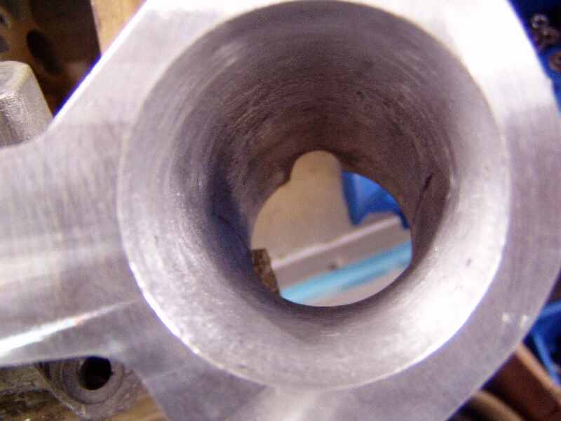

petert 616 Posted May 17, 2006 (edited) I'm not sure if it's just the angle in Martin's picture, but there appears to be a very abrupt change in diameter just inside the flange. I'm certainly not a flow expert, but I was taught that at no point should the change exceed 6 degrees. Here's a pic. of mine. It's a cut down Mi16 manifold fitted with 48mm DCOE flanges. Roughed out with a carbide burr, then finished with an #80 grit flap wheel. It's certianly not perfect and needs a bit more work. Edited May 17, 2006 by petert Share this post Link to post Share on other sites
Martin@PRD 0 Posted May 17, 2006 Aah, it being 45mm all through wouldn't help I guess, but then they should've known the port entrances are only 40mm! Would of bin perfect if it lined up center with ports 2.5mm removed from the lower part of the port and blended in with throat would of been nice with big valves. I'm not sure if it's just the angle in Martin's picture, but there appears to be a very abrupt change in diameter just inside the flange. I'm certainly not a flow expert, but I was taught that at no point should the change exceed 6 degrees. Here's a pic. of mine. It's a cut down Mi16 manifold fitted with 48mm DCOE flanges. Roughed out with a carbide burr, then finished with an #80 grit flap wheel. It's certianly not perfect and needs a bit more work. Just the photo angle peter, Well i carnt see the join nice work, can just make out the MI16 manifold in the background. hope you aint got pins and needles from white finger vibration like i did Share this post Link to post Share on other sites
