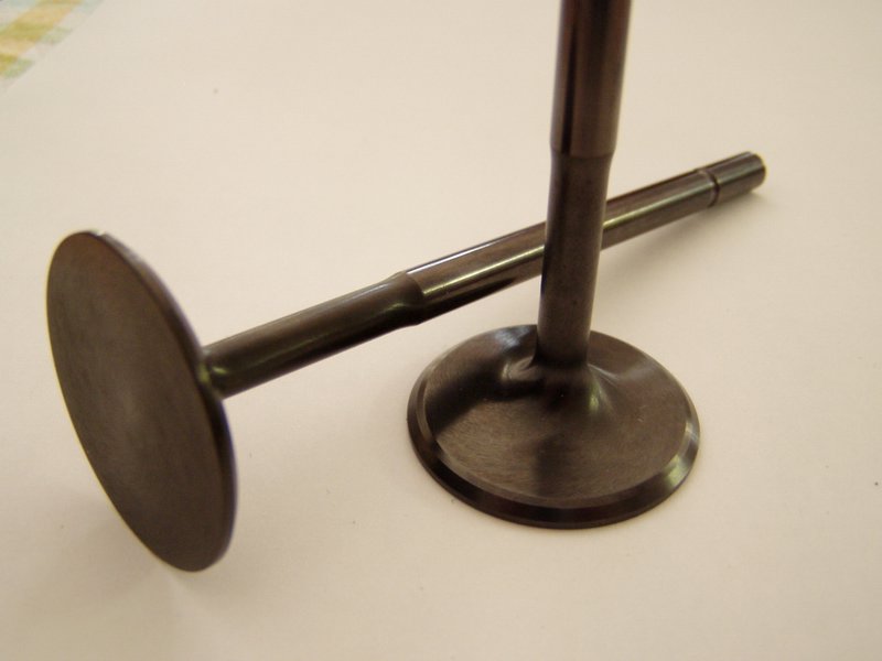

petert 611 Posted May 7, 2006 (edited) For some time I've been working on these new inlet valves. The development is almost complete and then I'll start selling them. In all development work there has to be compromises. Every effort was made to keep the weight down, maximise compression and yet retain acceptable flow. You'll notice the faces are flat, rather than dished, in order to maximise compression, which is so important in an Mi16 engine. Other key features are the 6mm wasted stem, 30 deg. back cut and the single collet groove, which enables the use of the more reliable Kawasaki Z900/1000 collet in the standard retainer. The valves shown are 120mm long stem versions, which weigh the same as the standard 105mm valve. The standard length valve weighs considerably less. Lighter, single groove exhaust valves will also be available. Edited May 7, 2006 by petert Share this post Link to post Share on other sites
B1ack_Mi16 67 Posted May 7, 2006 Looks nice Are you using all the standard Mi16 valvetrain components then, and just changing the the collets/locks? What will the price be, I have several Mi16 heads which have had the cambelt snap. Btw.. It's nice to have them in a dished version also, for us making 2.3 litre conversions it's actually hard enough to get the compression down to acceptable levels Share this post Link to post Share on other sites
PumaRacing 2 Posted May 7, 2006 I think you're developing things for which there isn't going to be a lot more long term interest. When I launched the 36.5mm valves for the Mi16 a couple of years ago they sold very fast. However I think most of the people who want a big valve head now have one and demand has more or less dried up, happily coinciding with the last of the original batch so it all worked out quite nicely. I can't see me investing just yet in another batch most of which might not sell. Also yours need special guides and collets (and maybe even caps?). The standard guides rarely wear so that's adding £100 or more of unnecesssary cost to the job. People don't generally want products that require a lot of work to fit. I've never seen a failure with a triple groove valve if the material is right so I can't see many people wanting to spend a fortune fixing something which ain't broke. Share this post Link to post Share on other sites
petert 611 Posted May 7, 2006 Sorry, my mistake earlier. They have the standard 7mm stem diameter, wasted, and thus take 7mm x 7 deg. collets, the same dimension as standard. Whilst the multigrooves don't fail on street engines, they do swell however, which can only lead to less than perfect locking. Most standard valves around now ream the guide on the way out anyway. Who'd put them back in? Given that the Z900/1000 collets are so cheap, and rated for 10,000+ RPM, I think they're a logical choice. Naturally, each set will come with a set of collets anyway, which enables them to be used with standard retainers. However, titanium retainers are also on the horizon. These are definitely aimed at a small segment of the market, being a serious competition valve. I'll put the prices on my new website when it goes online. Most Mi16 heads I do seam to need guides. It must be the warmer climate! Share this post Link to post Share on other sites

PumaRacing 2 Posted May 8, 2006 It should never be necessary to harm the guides when removing a valve. All that's needed is to gently file any burrs off the collet grooves first if they've lipped up. It's a common problem on the triple groove type valve because of the way the collets seat in them but it doesn't ever lead to a valve failure and it doesn't occur on properly heat treated valves. The Ford CVH and Pinto valves have triple grooves but are heat treated to a very high hardness spec and don't lip up. The Peugeot ones are heat treated to a lower spec and sometimes do have burrs on them. It's also why triple grooves should never be used on stainless steel valves because stainless can't be heat treated at all. I've seen some shocking groove wear on 'race' valves for the Pinto and CVH simply because people use the wrong material for them. I even know of one large Ford performance parts supplier who admit the problem on all of their stainless valves and say they intend to do nothing about it because it means they get to sell another set of valves every time a customer rebuilds their cylinder head. Share this post Link to post Share on other sites
