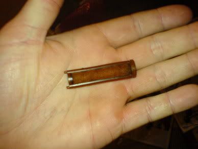

Right putting the head back together tonight and came across a small problem. I remember taking this widget out but can't remember where it goes or find any mention of it in the joke book.
Does this:
http://i30.photobucket.com/albums/c320/Vee...16/DSC00519.jpg
Go here?:
If not where does it go? :o
Cheers

pug309twin40s
its either that end or the opposite corner.
cant remember of the top of my head.
the whole it goes into is slanted at an angle.
but you ought to put in a new filter.
Ryan
That looks like the right place. At the timing belt end.

Ah result.
Well I'll give that one a damn good clean out tonight since I didn't get one with my HG kit that had everything else but the kitchen sink ;)
