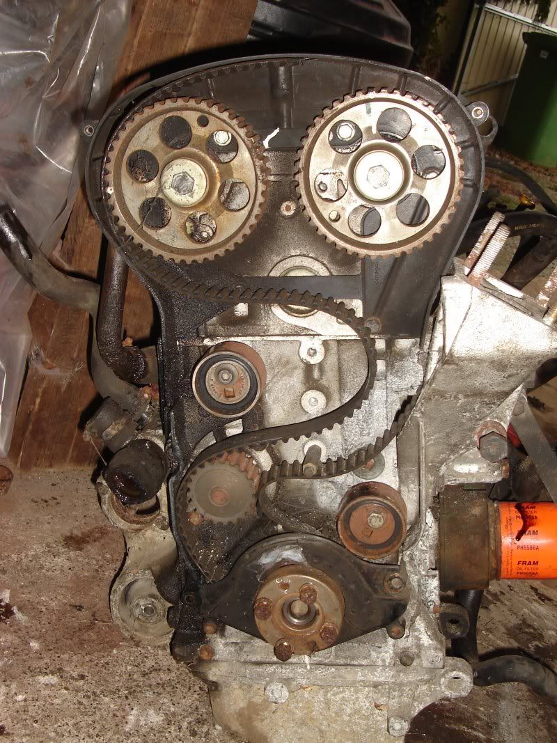

Engine is finally sat in my workshop. :)
http://i7.photobucket.com/albums/y259/sherly205/beltsnap.jpg

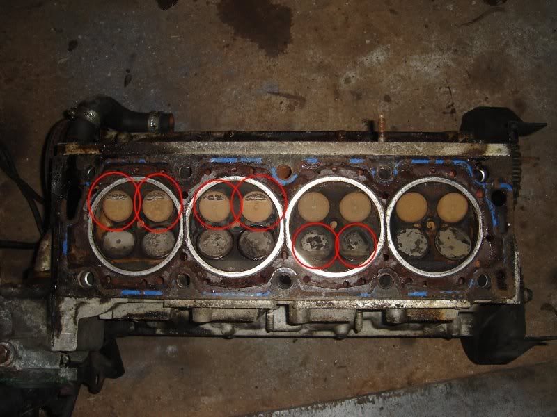

I've removed the head to see what damage has been caused and have discovered 4 bent exhaust valves and 2 bent inlet valves so not too bad........
http://i7.photobucket.com/albums/y259/sher.../bentvalves.jpg
........but I now have a busted headbolt to deal with. 2nd from last when undoing and it sheared off in the block. ;)
I've gained some ideas from searching on the forum and it seems that the majority of busted headbolts come out or can be repaired successfully, which has made me feel slightly better about the situation.
I plan to machine up a drilling bush to sit in the bolt hole to ensure the drilling is centralised and carefully drill out to the minor diameter of the thread and hopefully with some heat and persuasion the remains should come out (or retap) or helicoil if this fails.
or if anyones got any better ideas........... ;)
Mart :)
Higgy
The Mi16x4 I bought had 2 exhaust valves that 'kissed'.
To remove a broken head bolt, you should be able to get some long nose pliers on the thread as it sticks out in recess in the block on all but one of the head bolts (I think) and screw it out.
Hopefully as the bolt sheared it left a lip. Use the plilers again to 'grab' onto the lip and carry on unscrewing it from the head side.
The 'force' is between the head and the block. Now the bolt is snapped the force is gone, so in theory (and in my case) the bolt was 'loose' within the block. Just was a bit fiddly undoing it.
Could save you needing to drill and potentially damage the threads in the block.
