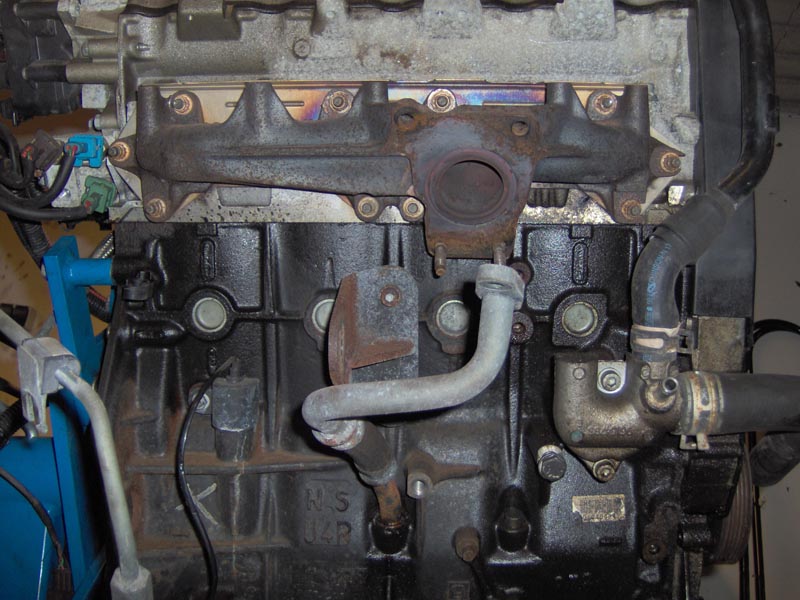

Heres a few photos, dont really show much because the engine is still in the car, it will be removed as soon as I get another engine hoist (old one was crap, it collapsed and put the light out in the shed!! :rolleyes: )
Pic1
Pic2
Pic3
Pic4

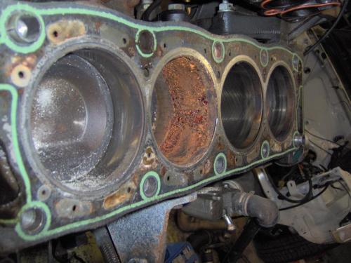

The fact that XU10J2TE engines have flat-top pistons can't be entirely true.
This is a picture of a XU10J2TE engine that a swedish guy bought for his 205 Rallye.
It clearly shows dished pistons. But that's maybe down to there's at least two different engine codes for the XU10J2TE.

B1ack_Mi16
The engine apparently came straight from the scrappy.
I've seen XU10J2 N/A piston myself, and they looked like this ones, but they certainly didn't have as deep dish as these XU10J2TE ones seem to have.
Another picture of the same engine as it came from the scrappy before head was taken off.
jacobs53
maybe the block was changed at some time?? to a stnadard xsi block?
lee
Guest CB-Dave
why would you have low comp dished pistons in an NA block?
there were two versions of the turbo lump, one that was 140-odd hp and one that was 155 or so (iirc), maybe the dished pistons are for the higher output engine to run a bit more boost, and the flat pistons are for the lesser output engine to make up for lack of boost pressure and as such keep the CR up to make the engine less horrible and laggy to drive
