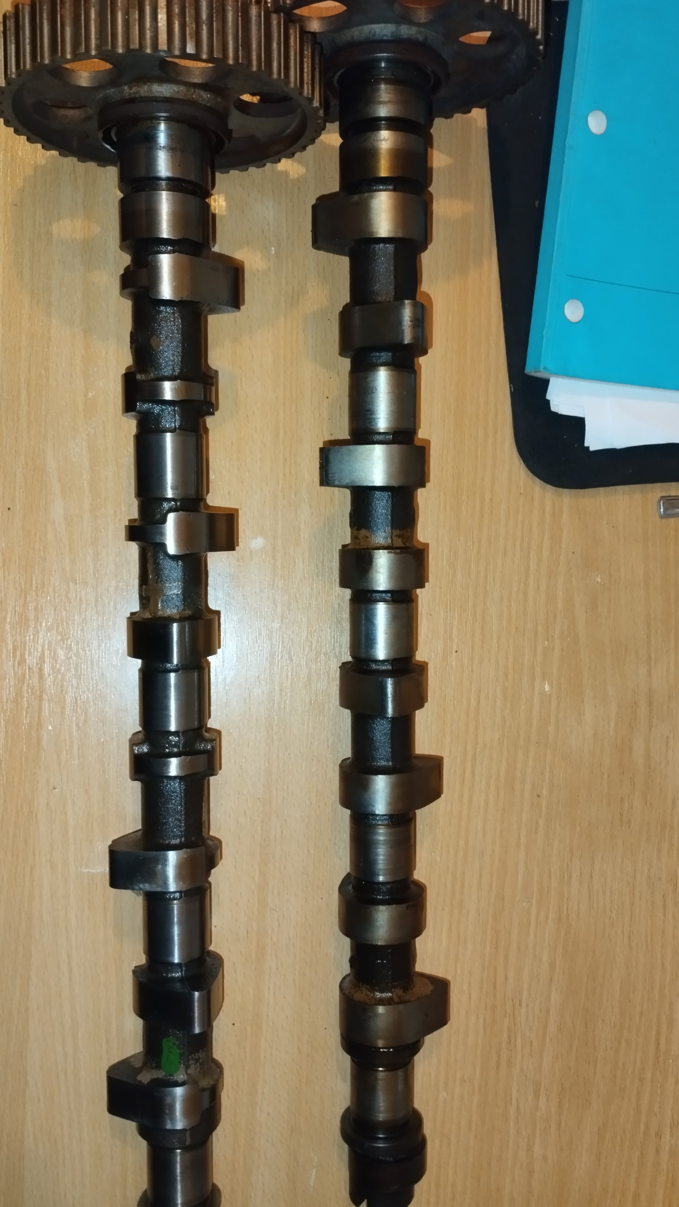

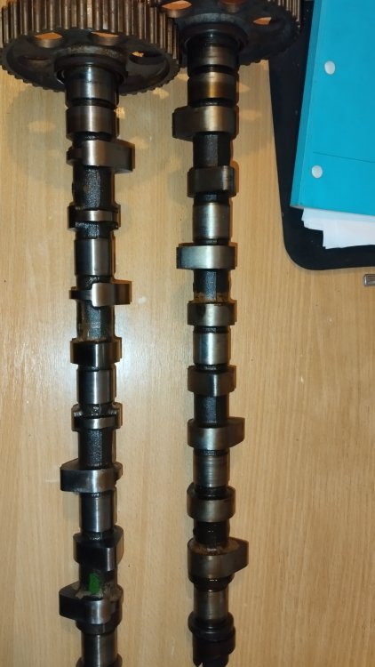

But what about DFZ cam ?
Went trough my pile of cams , and as it appears pretty much all of the three 2.0 T cams which i have have some sort of "issue" (pitting/corrosion) , one not as bad but not that great either .
Other than that i have at least three DFZ cams all in good condition , two DKZ cams with worn lobes so scrap value aka no use , one good RFX (XU10J2) cam and a few 1.6/1.9 Gti cams .

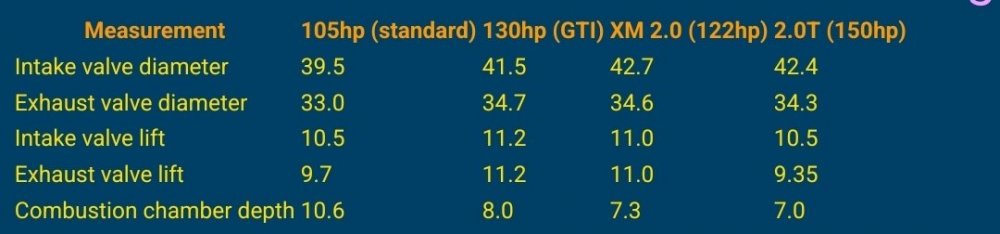

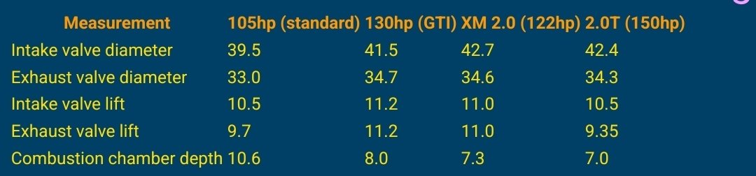

SRDT
DFZ cams changed since 05/1992 so first you can check if all of yours are identical. This cam started on the very first XU9 the XU9S and was retained by the XU92C, XU9J1, XU92C+ and even the XU9M.
This is not a performance cam, the 110hp XU9M is the most powerfull of them all.
I had a look through my notes. DFZ cam (circa '87-89) has 112º centrelines, so very tame on overlap and unlikely to cause you any tuning issues. RFX has 110º centrelines, so slightly more overlap, but seriously, still a very tame cam grind.
Edited by petert

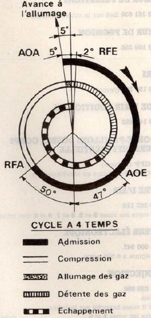

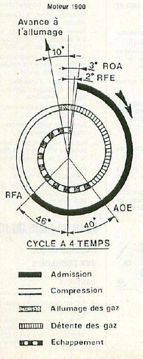

SRDT
Here is your XU9S/XU92C/XU9J1/XU9M diagram:
