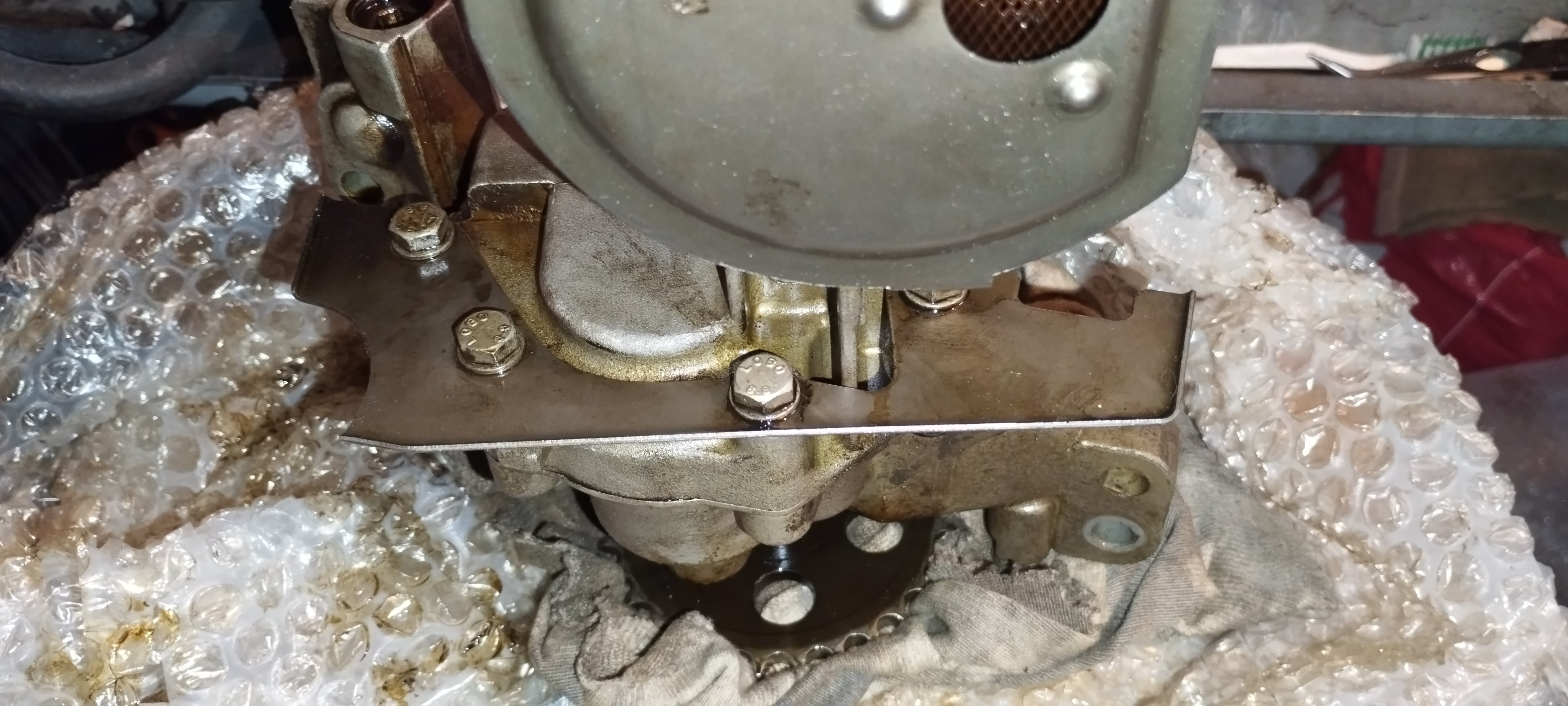

DamirGTI
As above , anyone remember how much Nm's where the 6 bolts which join the two oil pump halves ?
15Nm or 20Nm ? not sure !
are they m6 or m7?    m6 probably needs 13nm, m7 20nm.
DamirGTI
M6 !
It felt like about 15Nm whilst undoing ..

I tried my small torque wrench on the bolts of those spare oil pums and it clicks at about 11-12Nm , at 14-15Nm it starts to tighten so 15Nm is too much ..
So it's either 10 or 12Nm id say .

They don't really mind if you undo the bolts because they sell you some of the internal parts and also have small baffles that uses those bolts. Now it's true that the torque spec feels a bit like a trade secret.
I managed to find a value on the very first Citroën XUD worshop manual and it's 0,9 m.daN so yes it's close to 10 Nm.

11Nm for me and a dab of 243 Loctite. If one of those suckers comes undone it’s curtains. Ditto for the piston oil sprayers.
