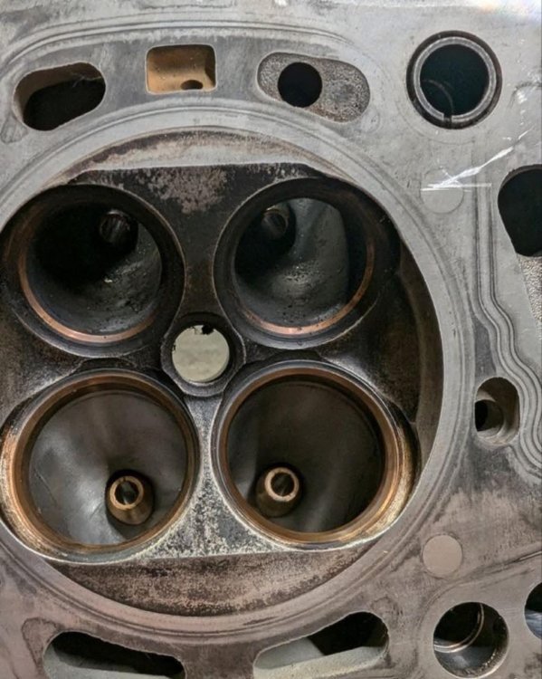

I was offered an XU10J4 ACAV cylinder head. I was told that it is prepared / tuned / maybe ported?  Since I cannot check it in person I got some photos and I kindly ask you too to share your opinion about this head if it is seemingly (!) really more advanced than an original unit.
SRDT
Isn't that beryllium copper valve seats on a machined combustion chamber?

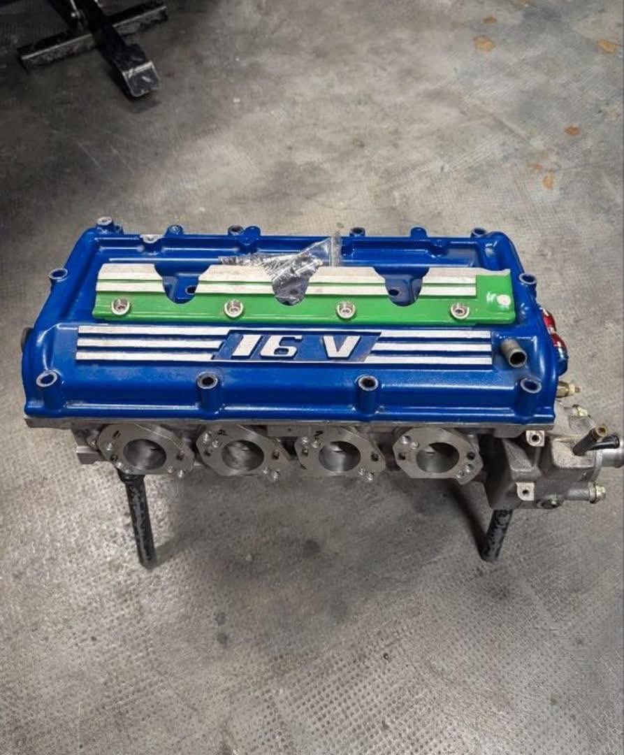

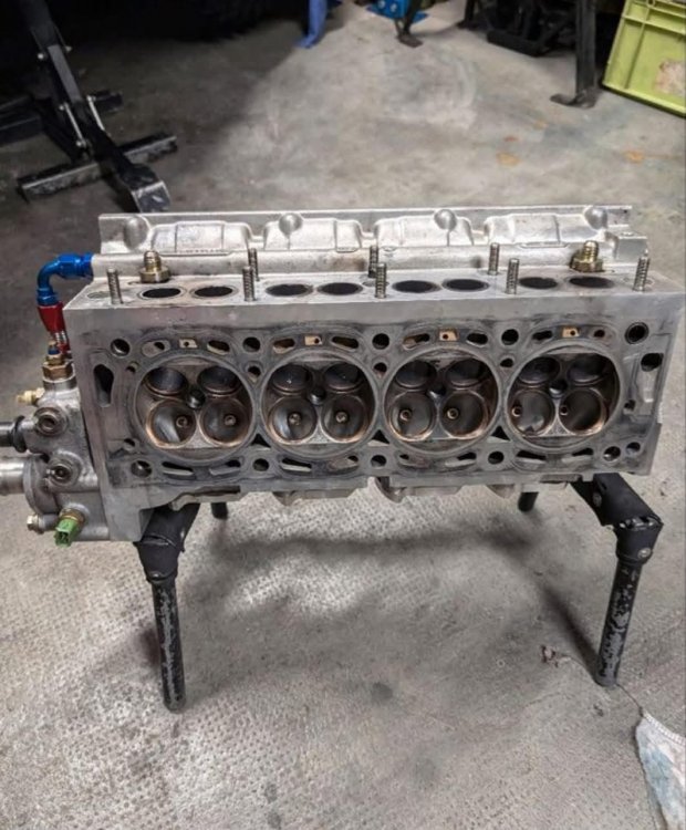

Anyway this head is very much not stock anymore. Look at the two external oil lines and missing studs on the exhaust side or the intake with adapter plates on each port.

Thank you for the answer that is inline what I know "Cylinder head for XU10J4, all beryllium alloy, for 35mm diameter tappets"
What do you think of it can be setup for (fast) road usage associated with an otherwise standard engine, or only for motorsport?
35mm tappets is a big job, most likely a solid tappet conversion for very long duration rally or race cams,   not suitable for a road car really.

Supertourers had Ø35mm buckets, so they could run massive lift and duration. Unfortunately, it leaves very little material between the bucket bores and the heads were very prone to cracking in these areas. I would run away.
I run Ø33 buckets in my heads. If I was building a new head, that had worn bucket bores, I'd use Ø32.5mm Evo10 buckets.
