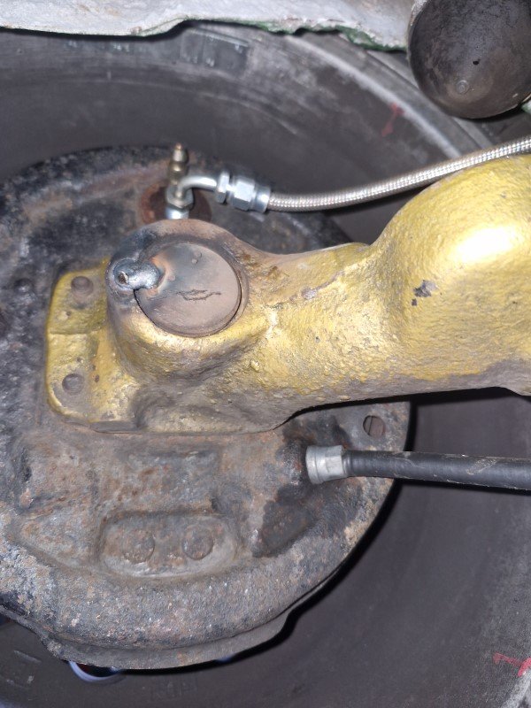

Bridgcraft machined the trailing arms to increase the negative camber, and as the bore then becomes larger than the original splined shaft, they press in an oversize non-splined shaft.  On ours, we did experience a problem with it rotating when we tried to undo a particularly tight hub nut.  I contacted Bridgecraft, and they said this was highly unusual; the interference fit never normally turns.  However, they said the simplest fix for us was to weld across from the arm to the stub axle.  I tried to do this so that it could be easily ground off should I ever need to:
The secondary benefit of the weld is that it acts as a telltale.  I can be sure nothing has moved.
