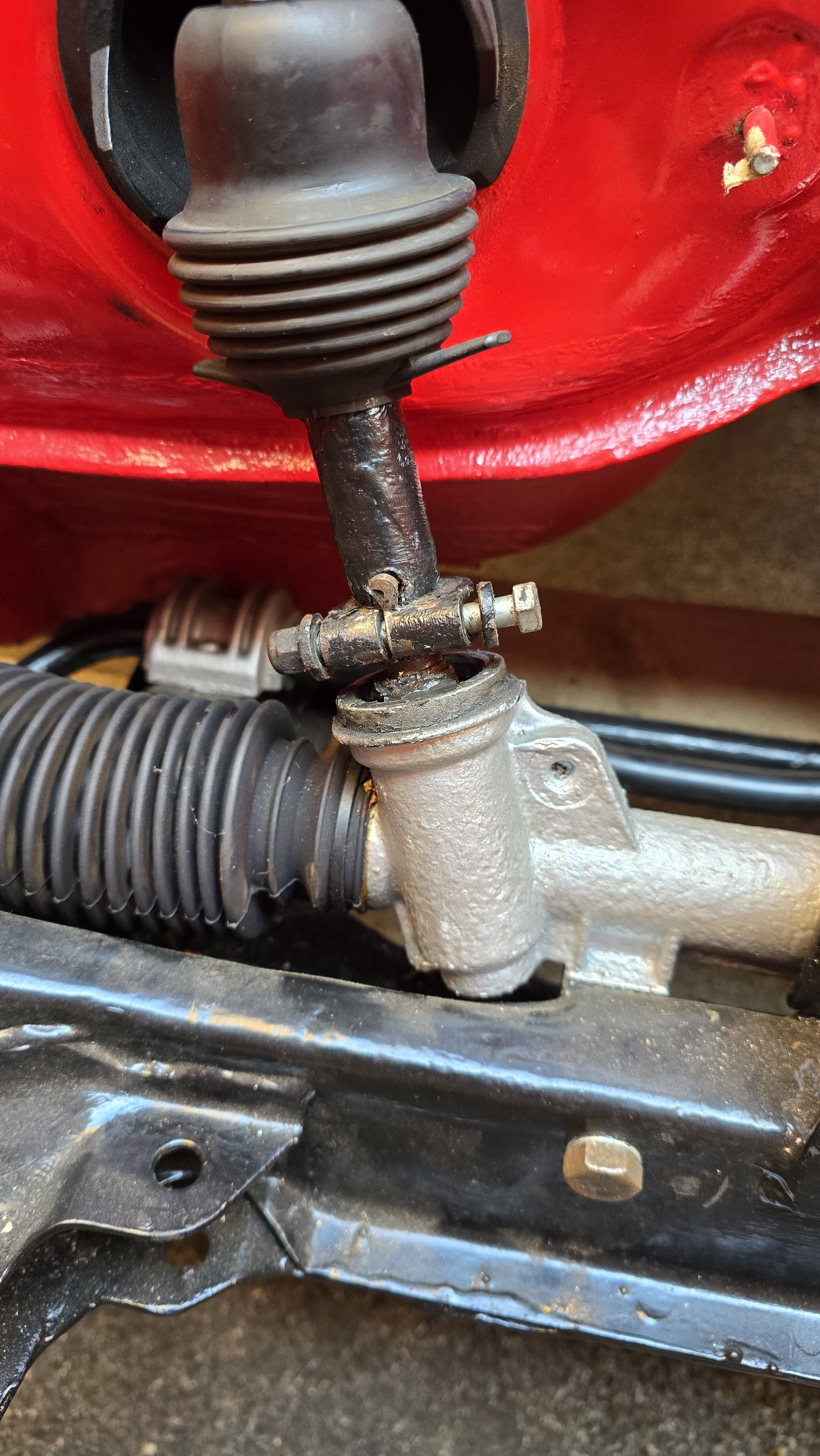

Does anyone have any advice on how to get this joint apart please? The blue plastic cover disintegrated when I cleaned it up while fitting the front subframe at the weekend so I need to split this joint, replace the cover and feed the steering column through the boot before re-fitting the clamp and bolt.
I've dislocated the little tab but I can't free the steering column.

Do You mean that You want to disconnect the lower steering column from the rack`s splined pinion shaft?
If so:  Remove the M8 clamp bolt from the split clamp on the pinion end, slacken the M8 clamp bolt under the column by the drivers knees. Now tap a wedge such as a cold chisel into the gap of the pinions split clamp to ease its hold, then whack the bottom of the clamp upwards with a drift driving the lower column into the car.
Its simple as You have access in that photo, a bit more difficult to access on a built up car.
I have no idea what blue plastic part or which tab  You mention.
Thanks Jay - all sorted now; I discovered that the pinion is notched to take the clamp bolt and I had left the nut and bolt loosely in place for safe keeping.
Once I'd fully removed the bolt it came off really easy :-)
