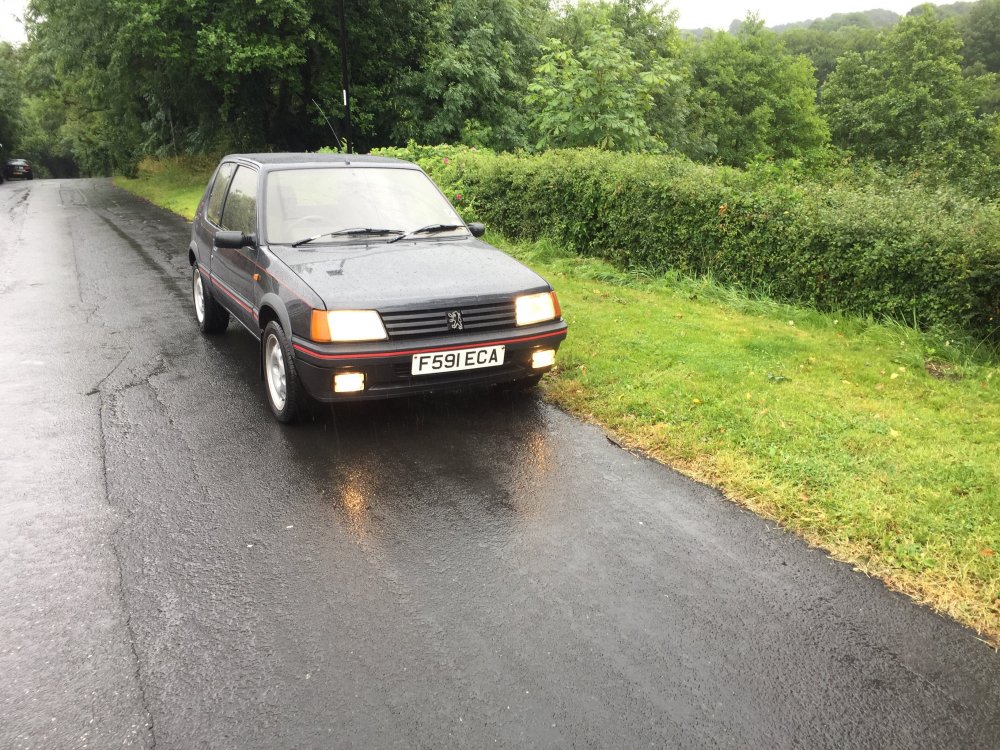

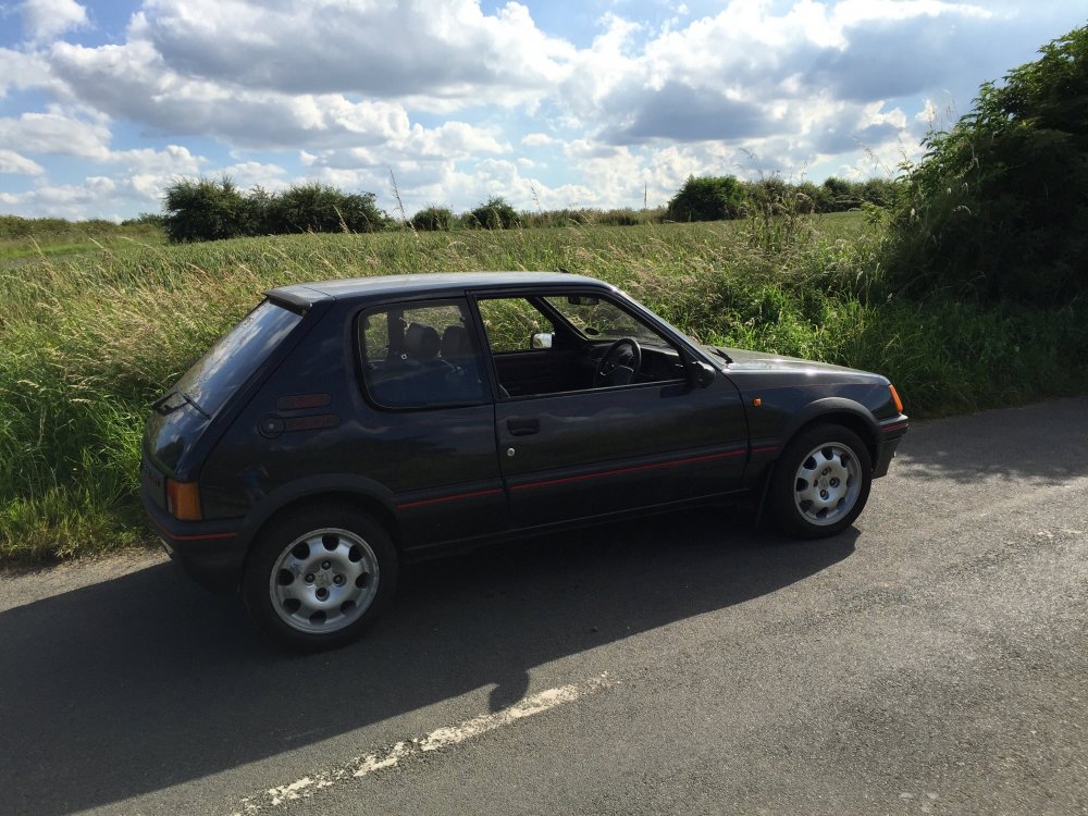

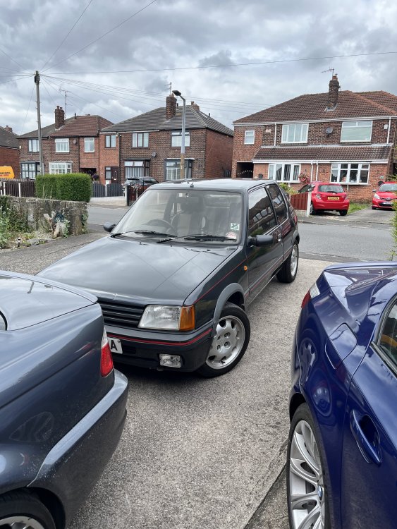

So a couple of photos here from summer 2016 when I went to look at it and agree the deal.
Then then a couple more from early 2017 when I actually collected it into my ownership.

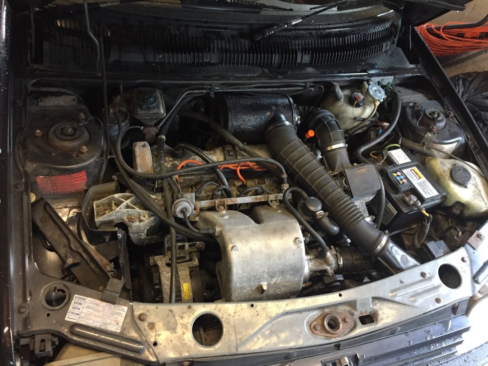

Engine bay looking typical for its age, but all there and not messed with.

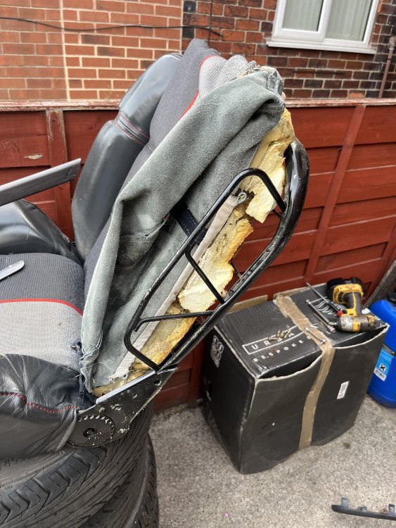

Drivers seat with typical wear and foam bolster fallen to bits.

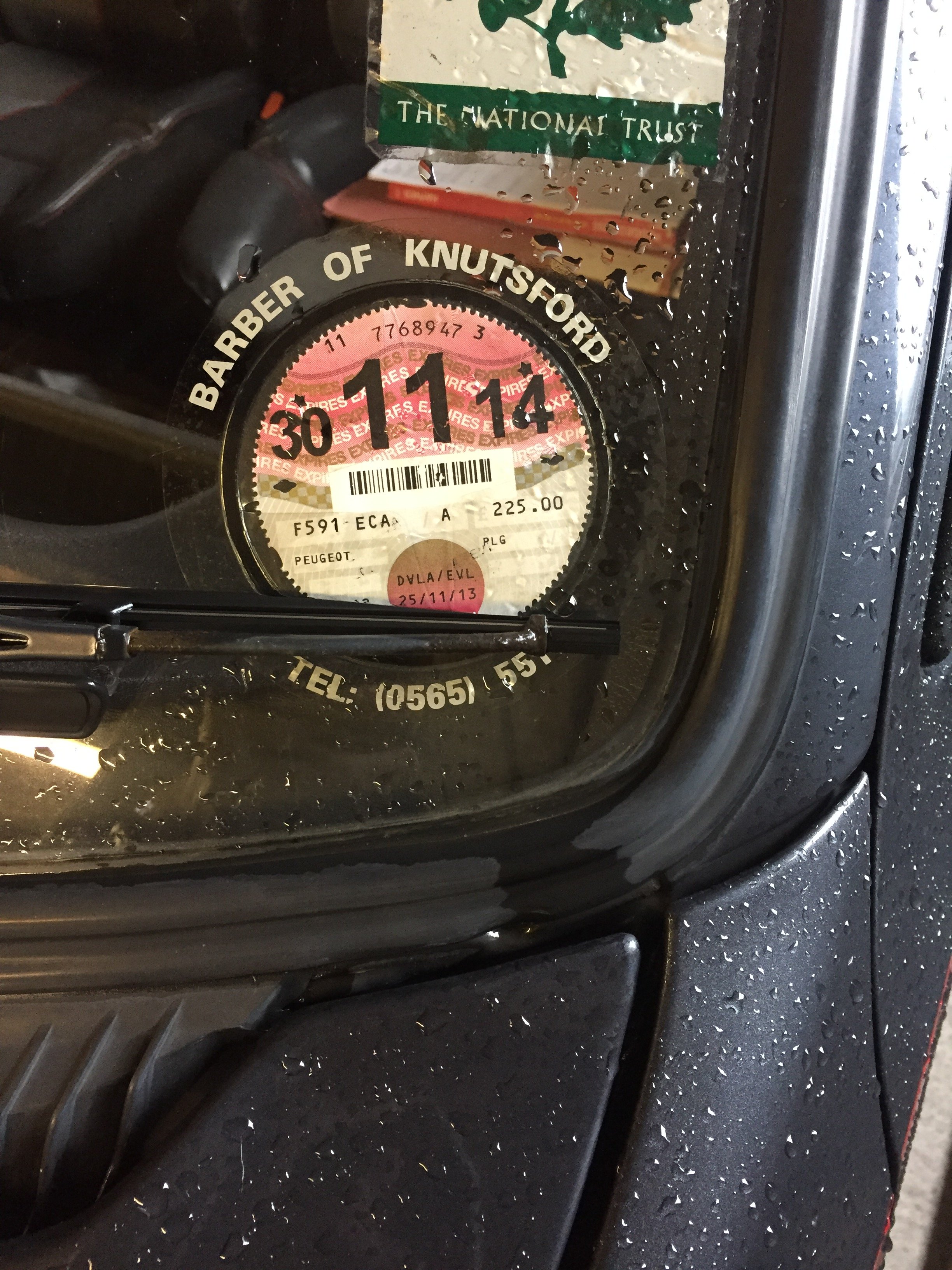

Dealer tax disc holder and rear number plate are still there which is a nice touch.

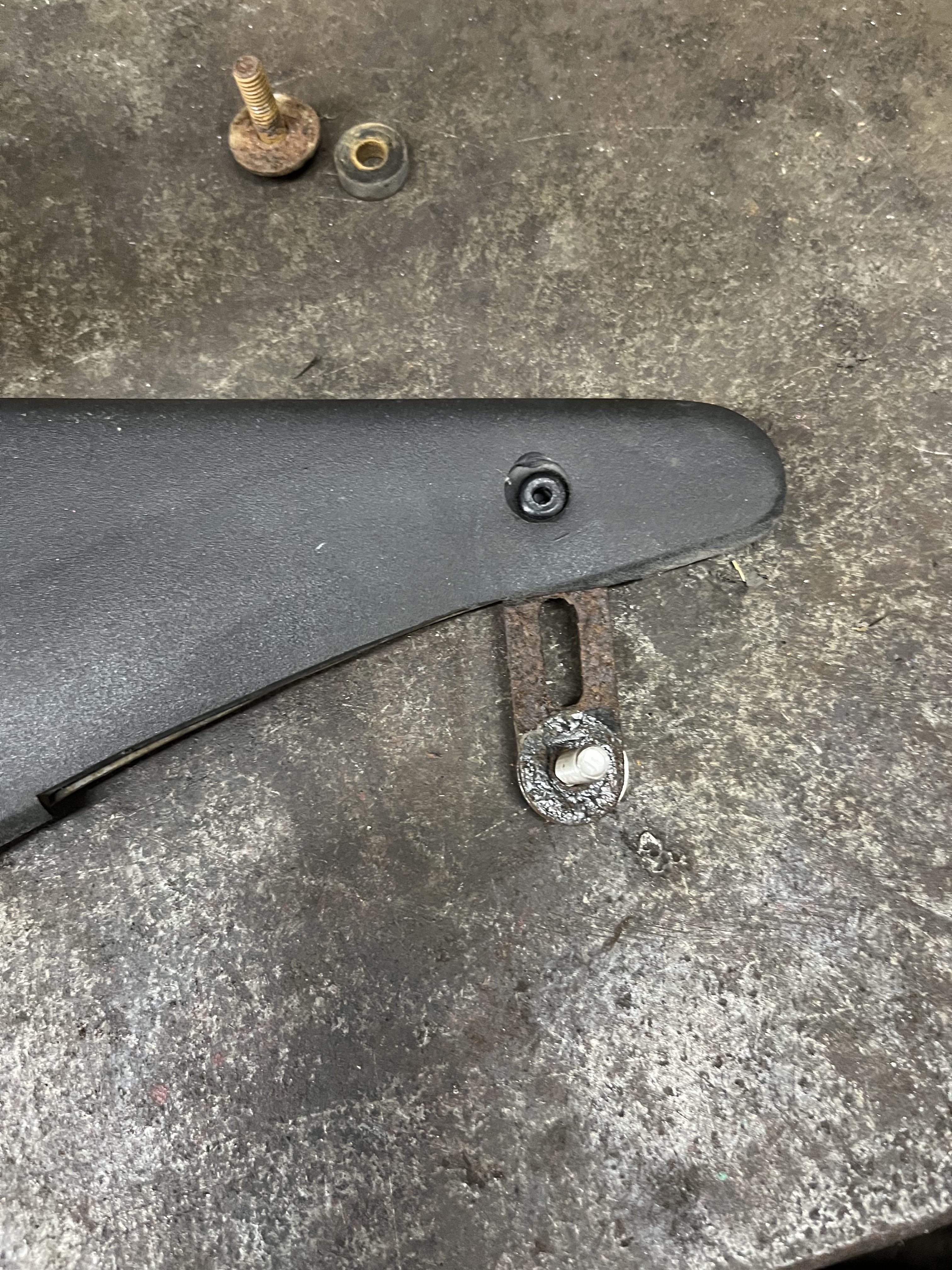

The next bit I noticed which is an odd one to be honest, the drivers door has a big rotten hole near the front corner behind the door card!

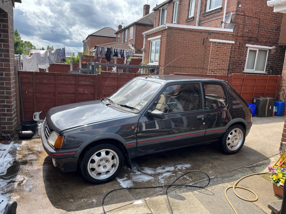

I retrieved it from the lockup and got it home, gave it a wash for the first time in my ownership and then set about it.

Home for work to begin in earnest, only 8 years since buying, you can't rush these things

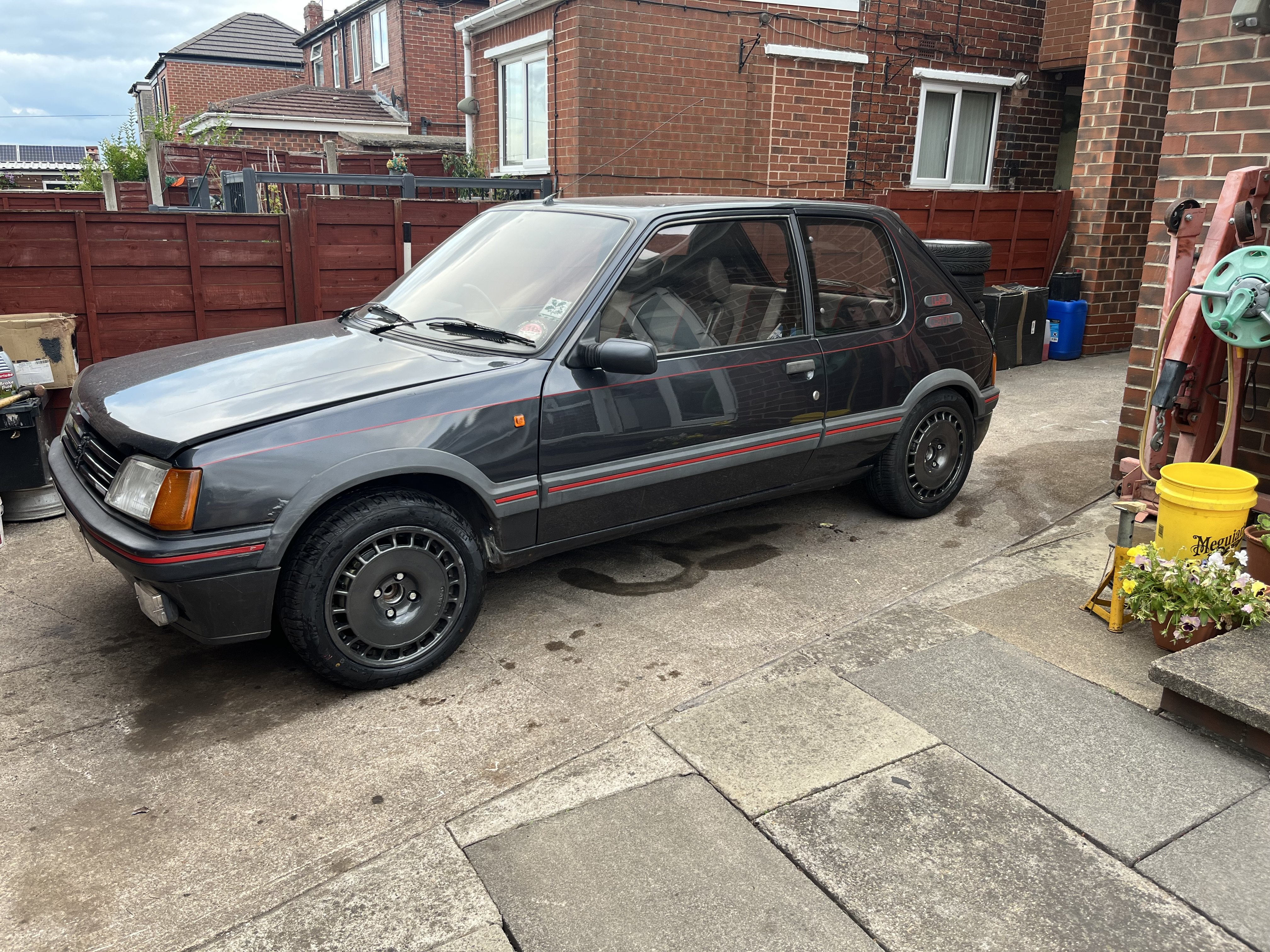

Looks presentable and shiny here, but as said most panels show their age in one way or another

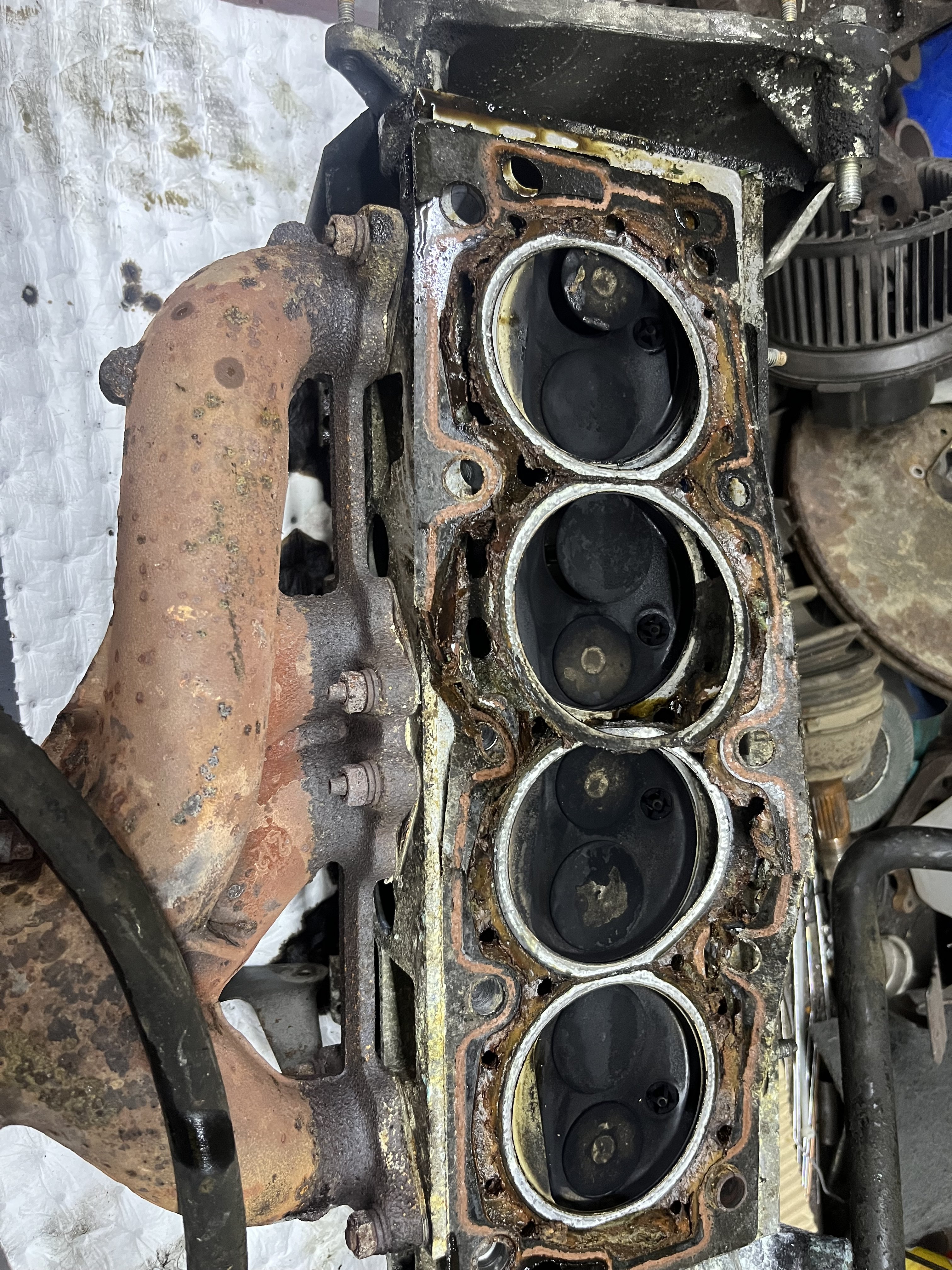

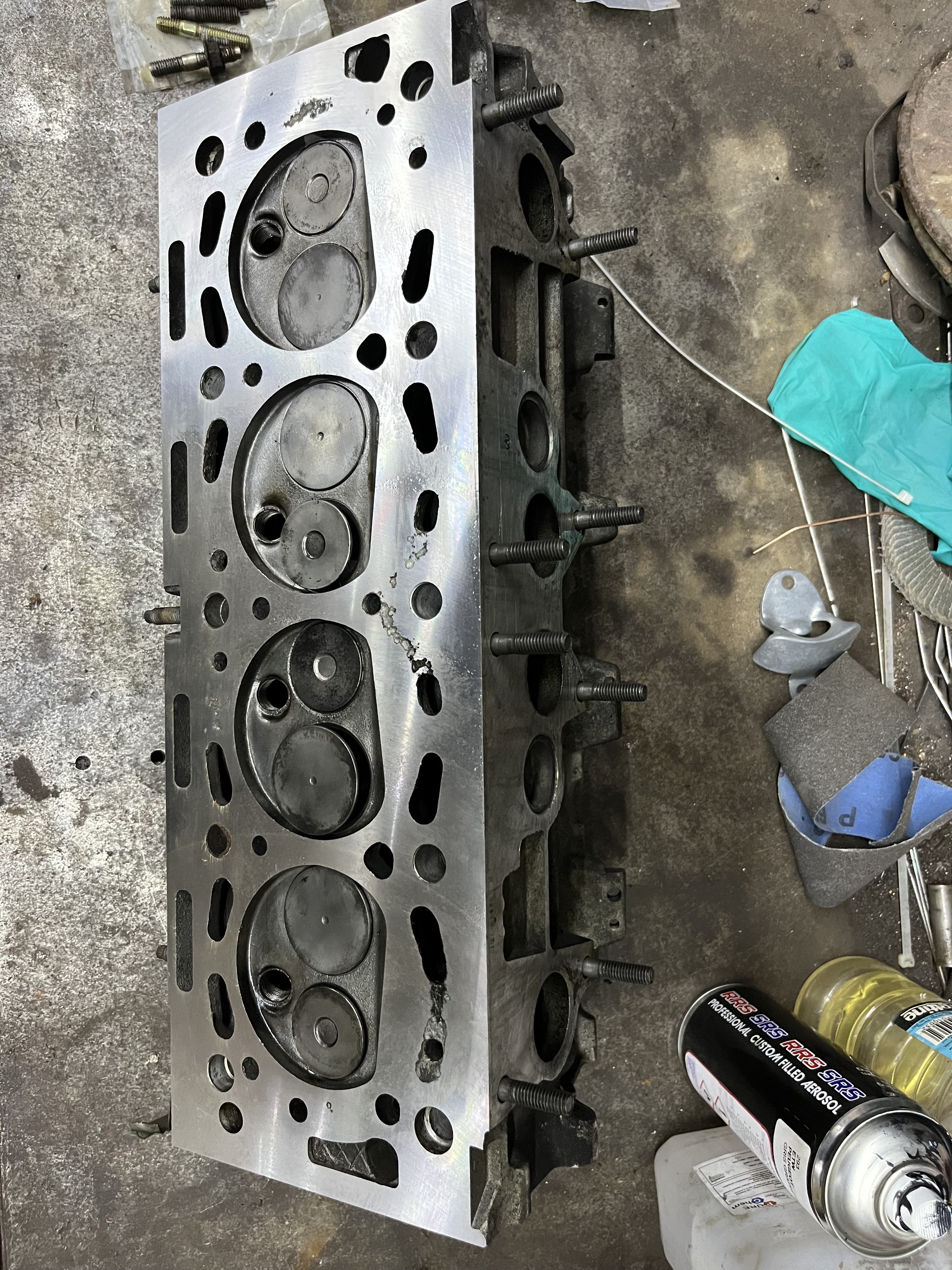

Head off, looks grotty
Head gasket looks extra grotty

With the engine and gearbox out of the car, I first of all took the head to the local engine machine shop, it needed a skim and at 160k I was quite sure it probably needed some other work, XU petrols seem prone to wearing the exhaust guides out in particular, as it turned out this one had done exactly that.

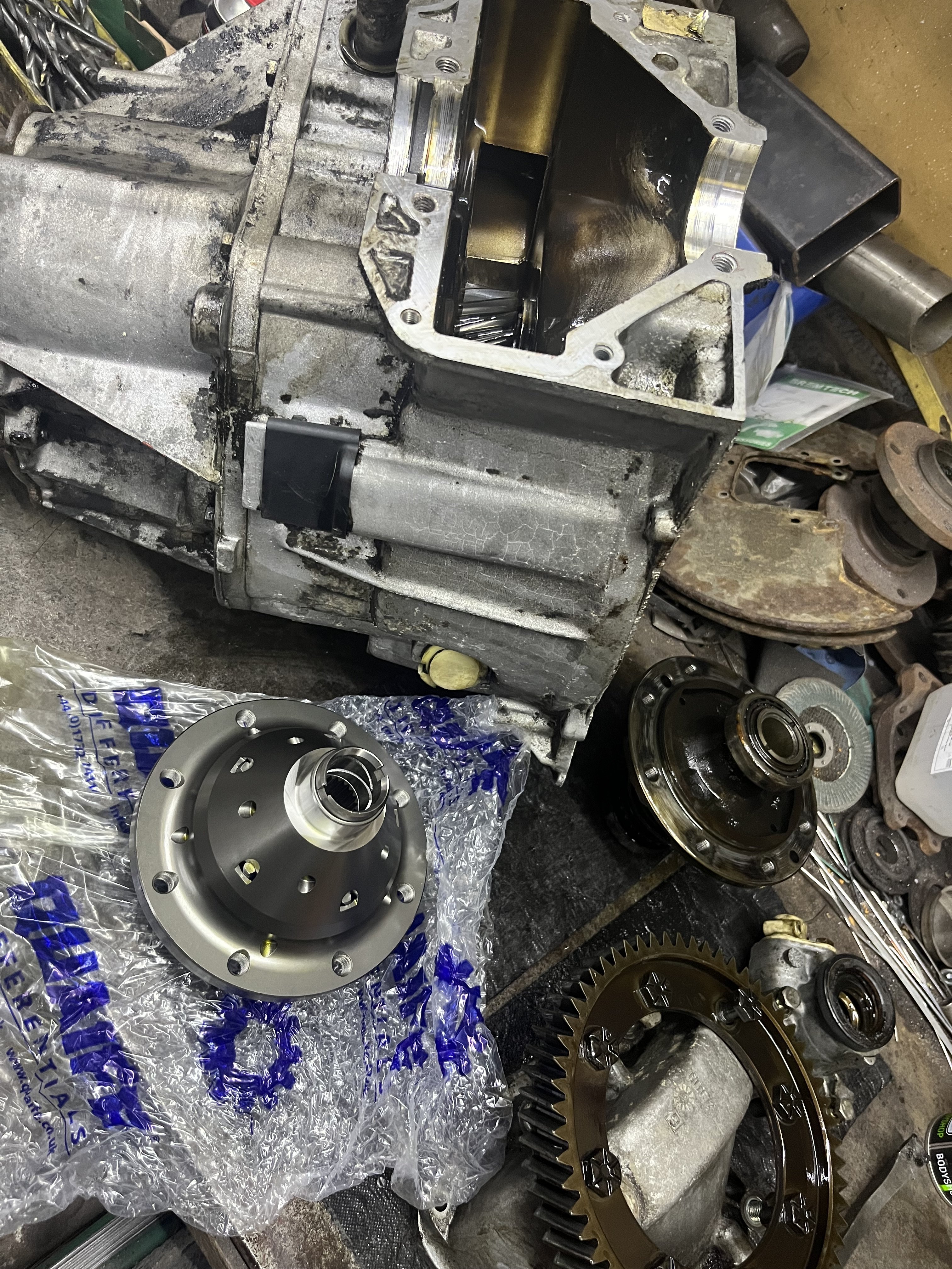

Next was a LSD, now is it absolutely needed on an otherwise standard running gear 205 GTI, probably not, but does an LSD make every FWD car better, in my experience yes. Allied to the fact I had a Quaife on the shelf doing nothing in particular, I decided it was going in the gearbox,

Gearbox having the diff fittted

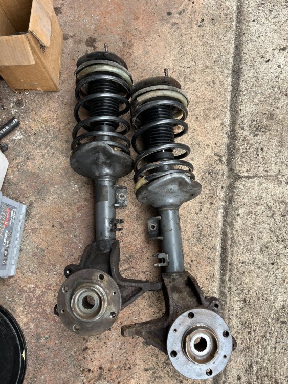

Front legs fitted with Eibachs, the dampers are Monroe and seem fairly recent, they will do for now at least

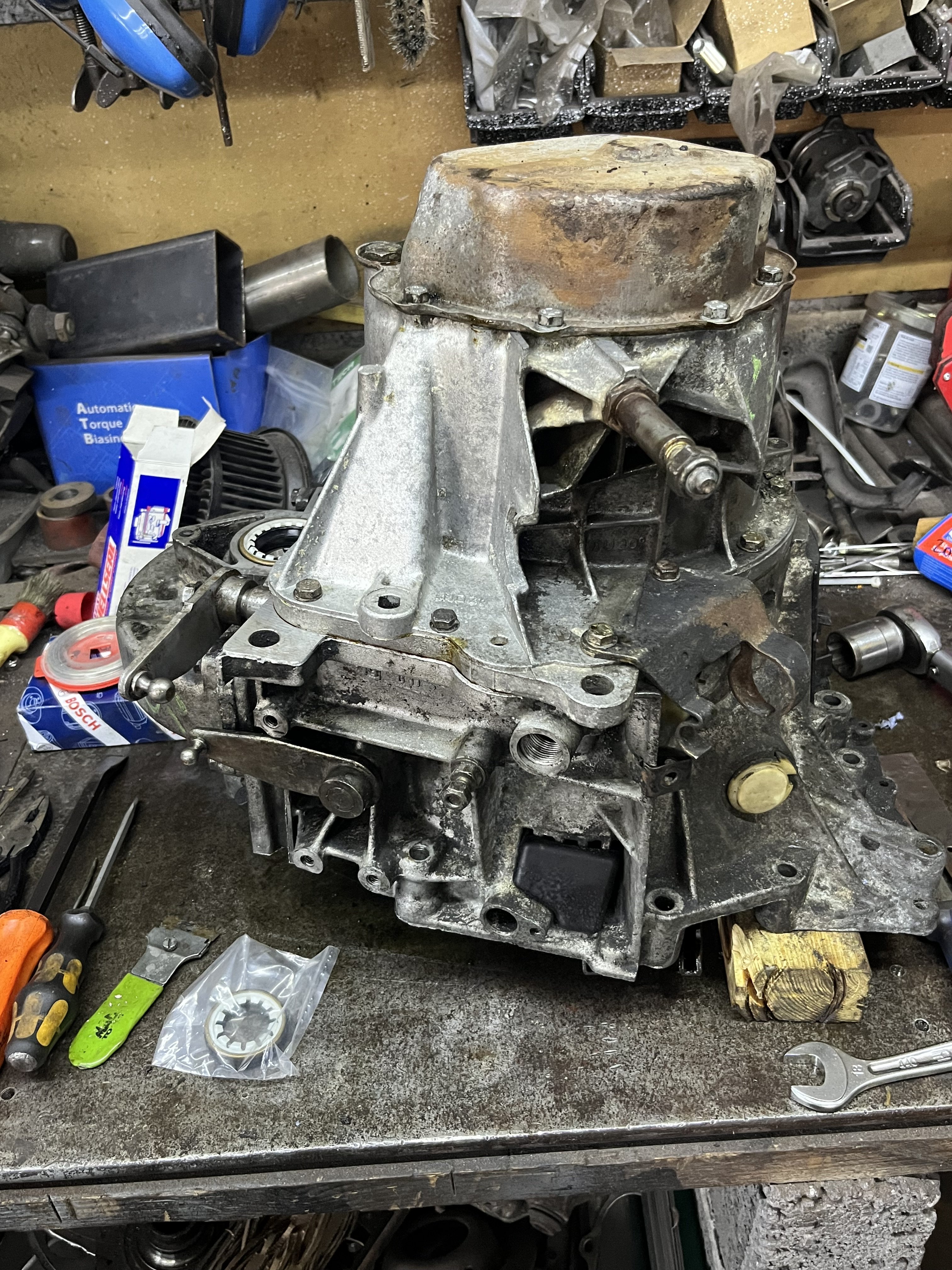

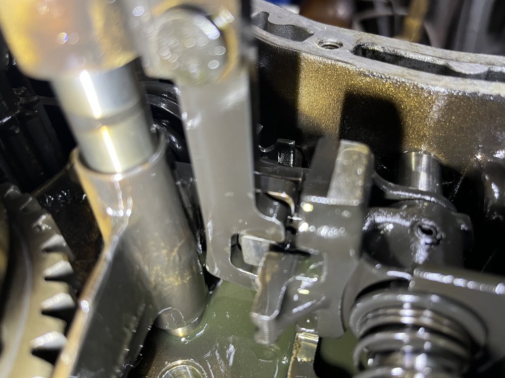

So whilst doing other things I remembered that the gear linkages certainly felt really quite sloppy. Looking at the link rods they were all good and tight and looked quite recent, I suspect Barry had noticed the play and had tried to improve it.
Operating the gearbox selectors with it on the bench showed there was quite a bit of slop internally in the 3/4 gate but the rest of it wasn't bad for its 160k.
After a bit of debate as to whether to tackle it or not I decided I'd kick myself if I didn't sort it whilst the box was out of the car so set about taking it to bits.
Its been a few years but like riding a bike you soon remember how to do it. With the box and selectors in bits I found the selector fork for 3/4 splayed open. As to how this could happen I have no idea, the forks are really quite a robust thing made out of maybe 8mm steel, quite how you could bend it I don't know, even if you jumped on the gear stick with both feet I don't think you could bend it.
Anyway, with it removed from the box I pressed it to straighten it and made it the same as the 1/2 selector.
Reassembled with the usual gearbox jenga game and the backlash was gone and all gears selected nicely, Pleased that I did it, I would have regretted not.
Main casing removed
The fork piece should be a close fit to the selector. You can probably see maybe a 4mm gap and that the fork is splayed open. This 4mm by the time it was at the gear knob in the car was a LOT of play
1/2 and 3/4 selectors next to each other after having pressed 3/4 straight. Now both a similar gap.

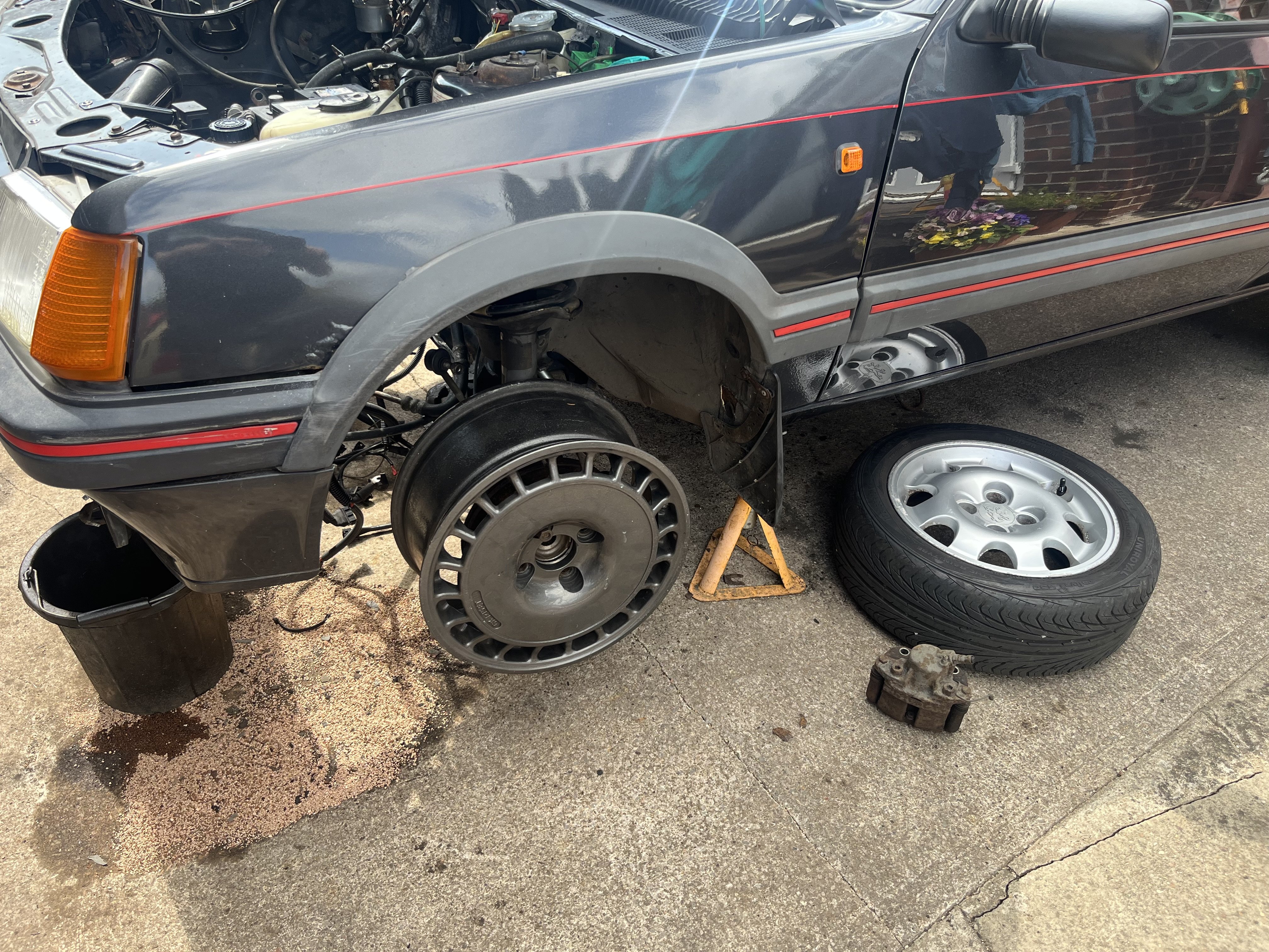

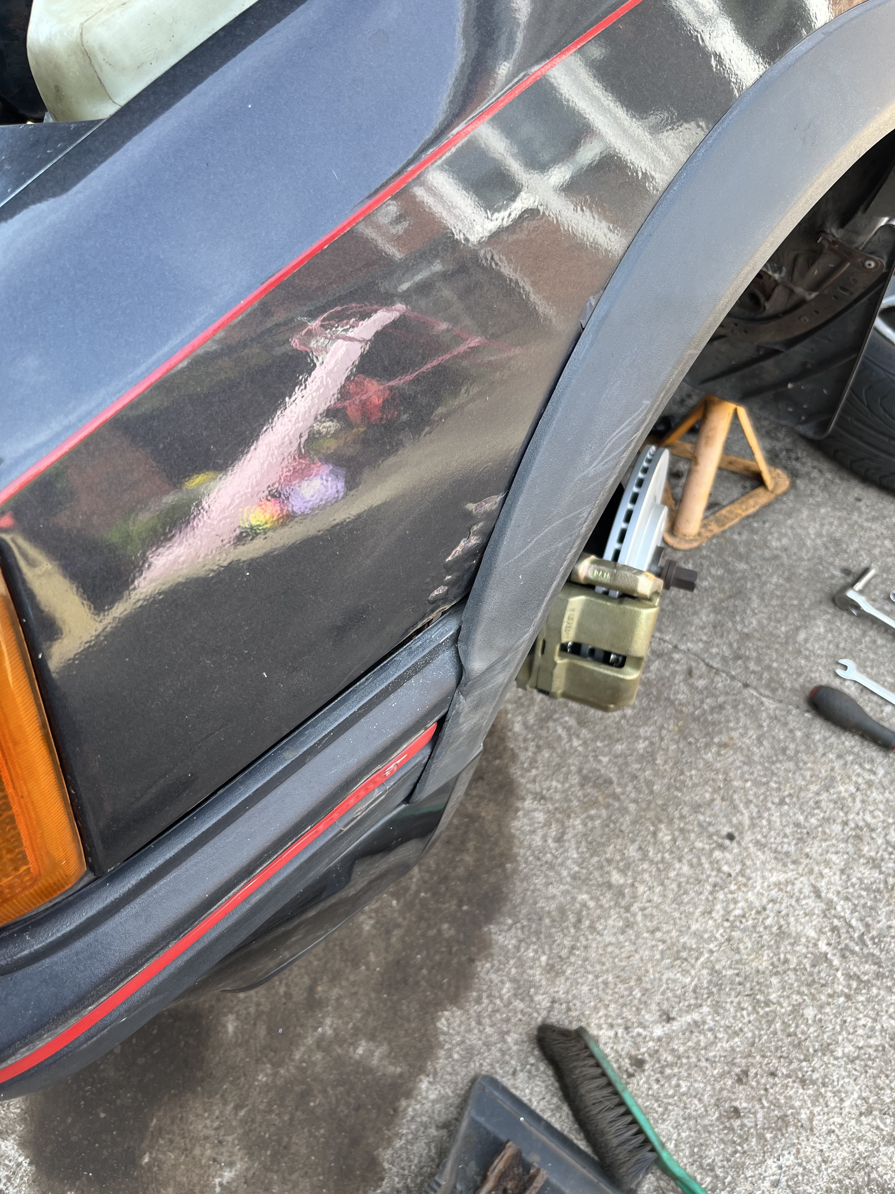

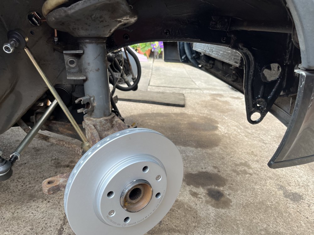

Whilst in the front area, I refitted the front legs, new Mintex coated front brake discs, and some calipers I had previously stripped, blasted, had gold zinc plated, and then rebuilt with new seals and pistons etc. Not pictured but I also bought a set of stainless braided brake hoses, more so for longevity as modern rubber is not good quality and does not last well in my experience.
Having known a few people experience master cylinder failure and hence no brakes in 205's, I'm always wary of master cylinders of unknown age, for a pretty cheap and easy to replace part I like to change them on my own cars just for peace of mind. New cylinder fitted and a new brake pipe to the OSF
I then found a small hole in the passengers arch area, so removed the mudflap which also needed a repair, and made and welded in a small repair piece.
Still waiting for the engine bits I then did the really important work to a car with no engine or gearbox and fitted a more modern bluetooth stereo and some better front speakers. I intend to fit some component speakers to the front doors at some point in future.
Front legs back on. Drop links are recent, wishbones look OK and no play
Caliper and braided hose fitted

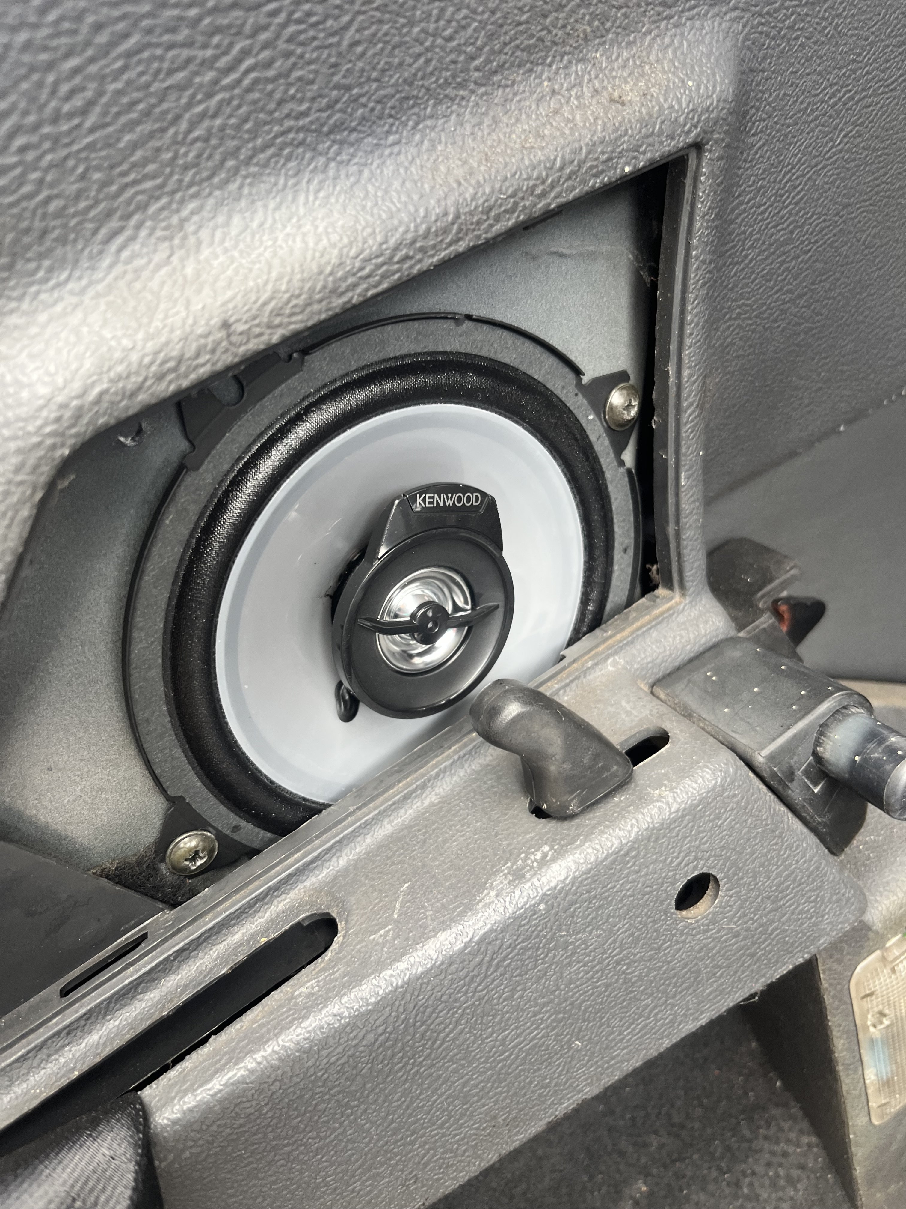

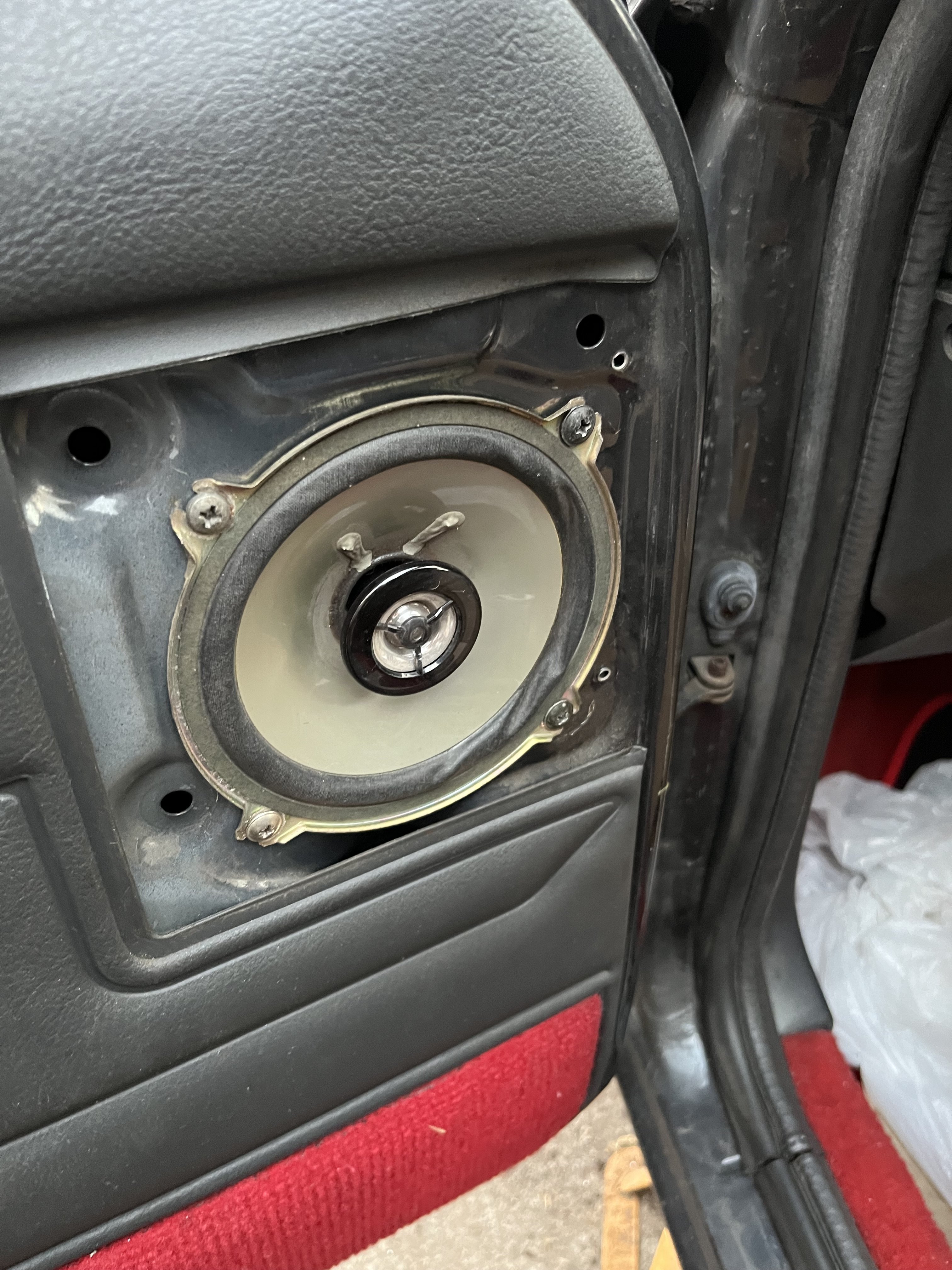

Stereo
And speakers

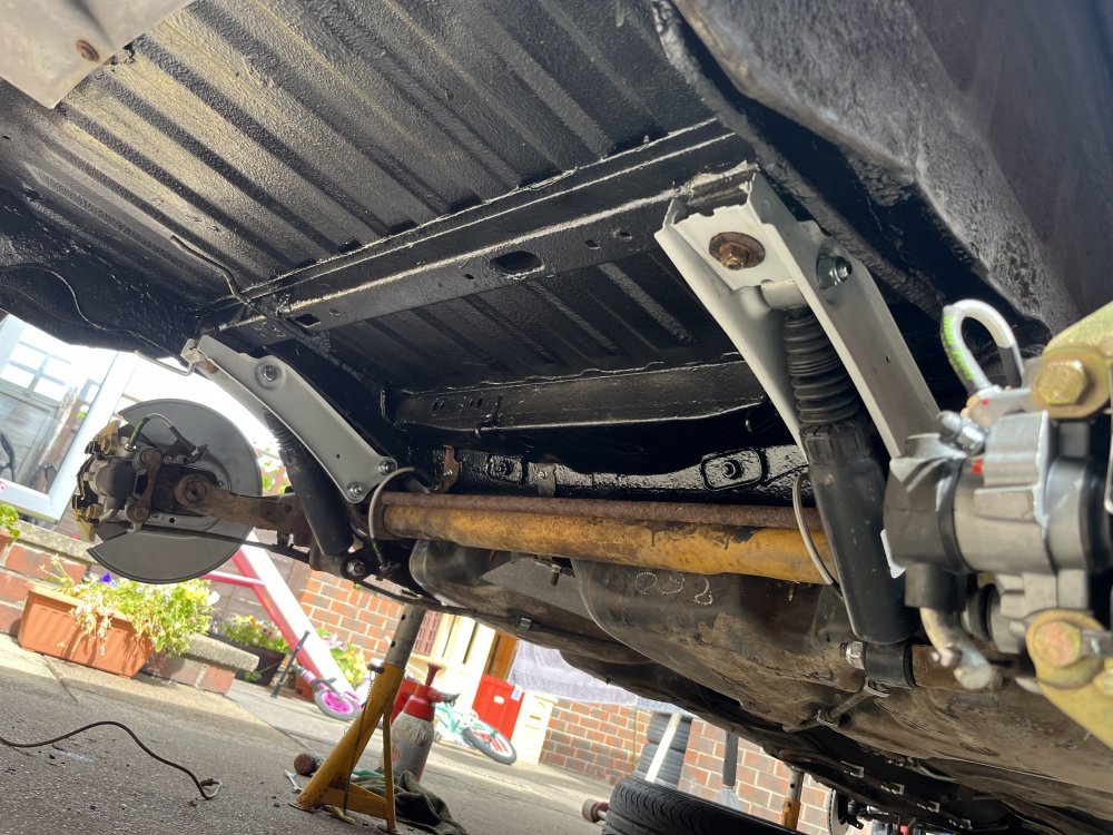

With work about done on the front end for the time being I turned to the rear. Engine parts not back yet.
First job was a beam service, with the Eibach springs I needed to lower the ride height anyway. I do a lot of these beams and have most parts to hand so decided to get it apart then assess what was needed and repair it as needed. As it turned out all it really needed was an outer bearing on one side, then new seals and carrier rings. The torsion bars a good clean up and re grease and then reassemble at a ride height to match the front. I intended doing it on the car, but the boot floor area also had previous corrosion advisories so again whilst you are there. Removed the beam and did the work to it off the car, and then set about the boot floor area. With the beam off the rear brake hard pipes over the tank looked horrid so you know what is coming next. Tank off. Wire brush/Hydrate80/Epoxy primer and then black shultz for the rear underfloor. I haven't the enthusiasm to go to the lengths of my green car on this one, so tidied up and mechanically good, is good enough.
Beam removed, this is actually after I'd serviced and adjusted the ride height. Some powder coated damper legs as the originals were awful.
A small hole above the beam, where the brake pipe bracket attaches. A patch made and butt welded in place, this is before grinding back,
Underfloor cleaned back and part way through epoxy primer. Not perfect but good enough to protect it
Black shultz

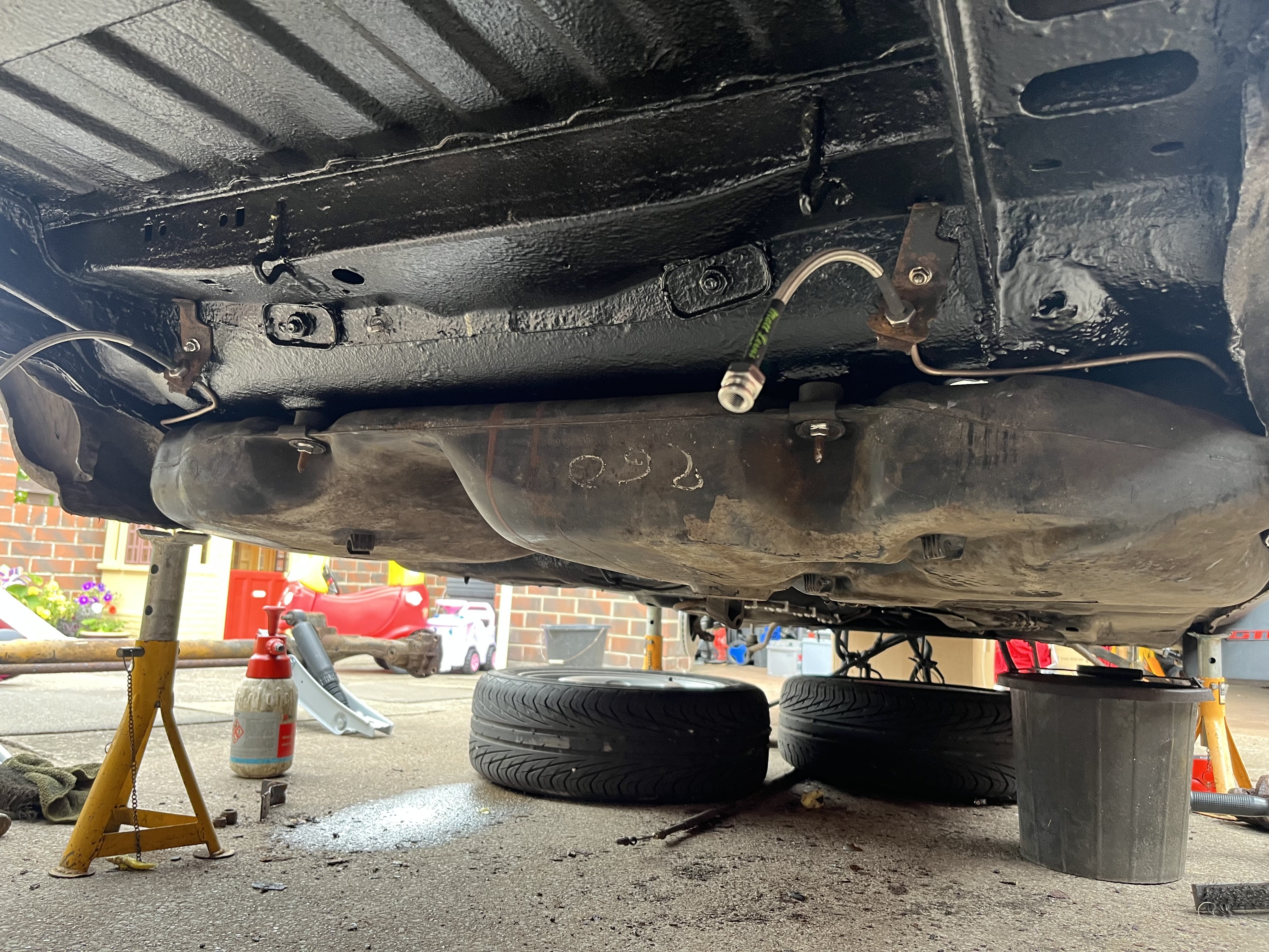

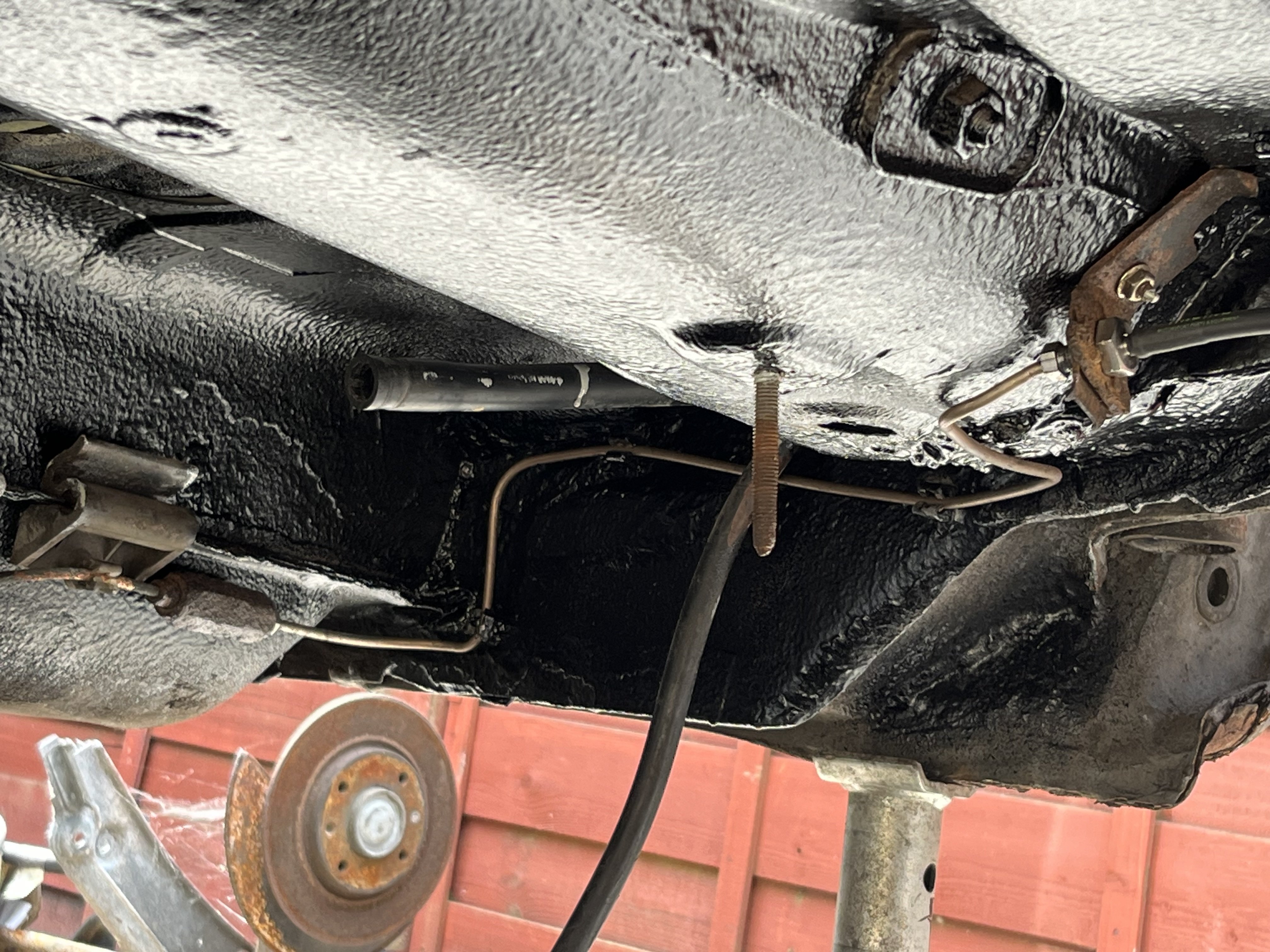

Rear brake pipes past the tank re made in kunifer. As a weirdo I quite enjoy the fiddly task of making brake pipes.
Tank refitted and rear braided flexis in waiting for the beam to go back
Beam refitted, rebuilt calipers and new rear discs also
New backplates fitted as well as I had them in stock

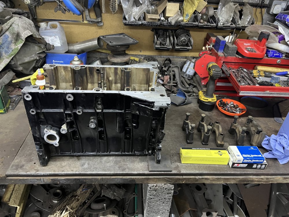

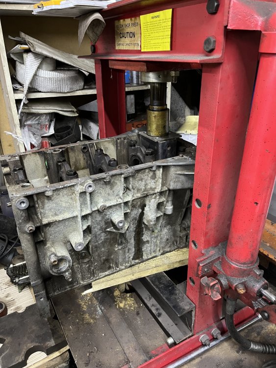

First the block came back, I'd f***ed up here really as one liner was stuck in, I should have got it out before getting the head bolt drilled out.
It took the press to get it out, it was heavily silted up and I mean heavily, I've seen plenty of these but not as bad as this.
With the liner out and cleaned up the area found the liner seat badly corroded away. Game over for this block, despite the fact it ran OK when in the car it almost certainly wouldn't when reassembled.
So luckily I have a selection of collected crap  carefully curated spare items and had a 1600 alloy XU engine that my true to type Scottish friend had negotiated for me some years previously, when the guy selling a gearbox with LSD would not move from the £250 asking price, so Rob came away with an engine to sweeten the deal :D
So stripped another engine to get a good block, tapped all the head bolt threads out to clean up, and started on the usual cleaning and checking process.

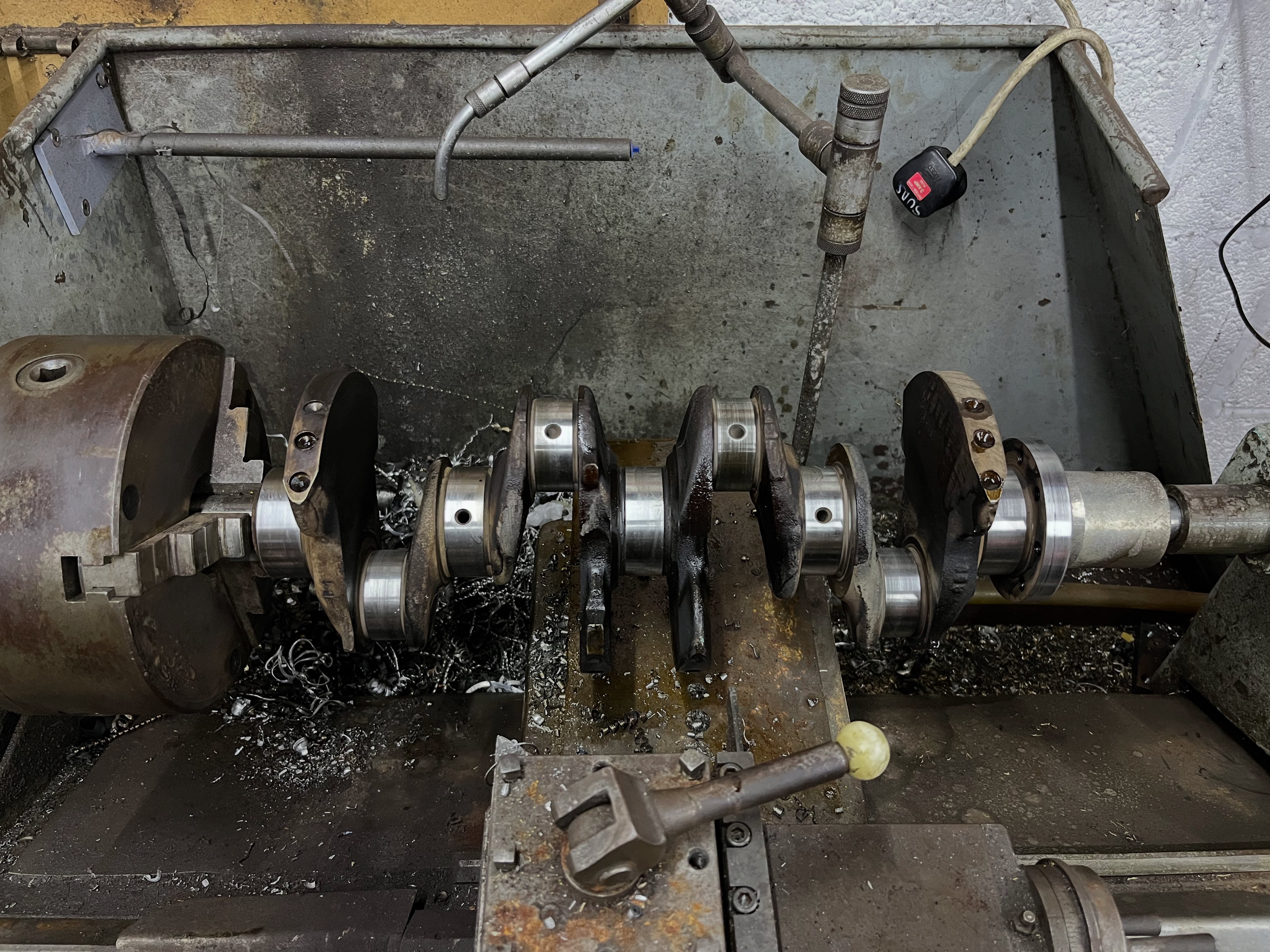

Crank in the lathe to polish the journals, mic'd up the journals and all within spec at STD/STD.
Pressing the liner out, usually they will knock out with a hammer and block of wood.

Finally the head came back, 4 new exh guides as predicted, some corrosion to the face but outside the fire rings so not hurting anything

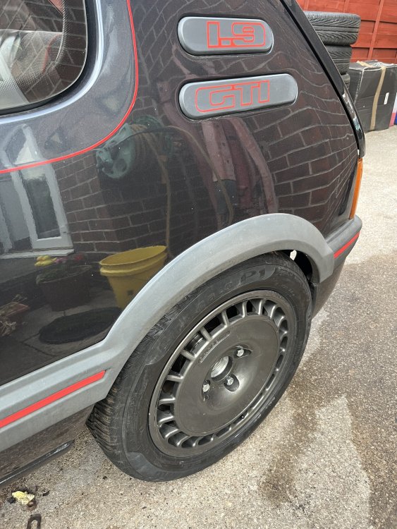

Another side project while I was doing it all was wheels, the 1900 wheels on the car were a bit tatty, also the tyres were a mixture of 20 year old uniroyals, and a Jinyu and Rotalla both with about 200 miles on. None of which filled me with confidence to use! I also have a set of Compomotive TH living in the garage loosely intended for my red 205, so you can guess what is coming. I'm sure many of us have bought sets of the ex-Ginetta Michelin PS3 in 195/50/15, however these have dried up and they've now moved to Pirellis. I bought 4 part worns for £94 which seemed cheap enough to me, so with a tyre machine I'd never fully got to grips with in the garage I set about them.
Engine and box ready to go back in the car. A few ancilliary bits left off that can easily go on once it is in.
Test fit of a Comp, some spacers needed to correct the offset as I think they are Ford offset
First tyre fitted. I was very pleased with this :D
And no engine or box in but couldn't resist putting it on the deck to see how they look. I've always been staunchly in the, "wheels must be silver" camp, but I have to say I like this.
With a 15mm spacer I'm happy with how they sit on the car.

With the engine back in bits, obviously stereo is very important so I fitted some replacement rear speakers. The originals absolutely pumped.
So with all the bits here I set about the engine, again. I decided I didn't dare take the risk of just doing the 1 liner seal, so ended up pulling them all. As it happens the other 3 were OK but I couldn't face going round this loop again if another was no good.
And with it all reassembled, I'll put fluids in it later and fire it back up to put myself back where I was about a week ago :/

I've never opened a gearbox proper so seeing inside makes it more approachable

What did you set the rear axle height to ,I set mine to 312mm I think it was but with a full tank of fuel and 1 rear passenger its on its a*se , it actually has contacted the front of the arch a little  when I hit a big pothole mid roundabout and needs raising up a bit , looks fine with nobody in though .
Interesting to hear a different (totally valid) viewpoint, to me this was never a breaker being not messed about with and quite original, but I guess to some it might have been.
Beam I set to 312mm which is my usual to match Eibach springs. Usually sits them just right. A couple of thoughts, are yours definitely GTI torsion bars 18.9mm, there are 18.5 and 18.1mm bars out there, doesn't sound much but they are a lot softer. The other thought, what rear dampers, some seem to be too short for a 205 so you end up pre loading the torsion bars even at a lower ride height.

A bit of interesting (maybe?!) info was that is was supplied by a dealer Barber of Knutsford, still has some of its dealer info with it. Out of interest I tried to search the internet and see what I could find out about Barber, the answer was very little. I found a Facebook group of Knutsford town history and so posted on there to see if anyone remembered where the dealer would have been etc. Got loads of great replies, the dealer is no longer a car dealer, but the petrol station forecourt is still there, and as it happens I've been past it a couple of times. More interestingly was a guy that replied to say he'd worked there, and that it was very likely it was either him or his mate that would have done the PDI on this car when new. He recalled that there was a mix up with number plates and two cars, this being one, went out with a mix of number plates front and rear! They had to get them back and sort it out obviously! I had thought that when it is done, I might go for a ride to Knutsford in it, and take it back to where the dealer was. I love to know some history of the cars, maybe just me. I'm lucky that with a few of my cars I do know quite a bit of the history of them.
Anyway. Ran her up last night, it starts and runs well with a bit of adjustment to the throttle body idle stuff. I haven't run it for long, as the new rings really need to be run under load to bed them in, letting it idle for any length of time won't really do it any good at all. Thankfully most of the fluids seem to be staying in their intended places. I say most because it seems the PAS pump has sprung a leak and is pissing PAS fluid out. To be fair it was a used pump of unknown age and tbh I can't even remember where it came from. So expecting a lot really for it to be OK, although often they are. I've ordered a new one anyway which I'll fit when it arrives.
With that done, I turned to a check of a few other things with a forthcoming MOT in mind. Usual 205 fayre such as the front washer pump not working, pretty standard. However the rear of the drivers side sill had been bugging me a bit, the returned lip looking like a prod would make it fall to bits, and lo and behold it did. Whilst you are doing it and all, so I've ordered a sill and a lower quarter panel repair section to sort it out. I think maybe doing the rear half of the sill will be enough, join it in the door aperture somewhere, I don't see the point of disturbing the rest of the factory spot welds and sealer if I don't need to. I didn't want to start grinding and fabrication work with the engine in bits, so now that is done, this bit of bodywork is next. I'll sort the washers out in due course as well, I fitted some new wiper blades as the ones on the car must be over 10 years old and rock hard.
Running through my list of other stuff, I've a few outstanding odds and ends to tie up, but the drivers seat outer thigh bolster was desperate, the leather actually OK but the foam felt like it was dropping to bits. I had a search through my stuff and found I'd saved a used good bolster foam some years before, so decided to fit that into the seat for now. Call me a weirdo but I'd rather dismantle and repair a gearbox than a seat, but it did go OK! I've got some hog rings and pliers which do make things a lot easier, the bread knife out of the kitchen maybe a bit more left field choice of tool but works quite well here for cutting the old foam away. The seat does want some stitching repair to the upper part of the cover, but that can be done at a later date, the bolster repair at least makes it a bit more useable for now, and moreso will make sure I don't damage the leather where it was rubbing on the steel frame.

Other than the obvious books etc in with the car , is there any way of finding where / which dealer supplied a car ?
A few of mine came with nothing and the shell came .bare but would be nice to do what your planning and take them back to their original starting points
