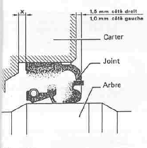

SRDT 256 Posted June 27, 2025 Did you install the driveshaft seal correctly? It should not be all the way in nor flush. Share this post Link to post Share on other sites

Leslie green 166 Posted June 29, 2025 (edited) The not going all the way in with the seal refers to earlier be1 gearboxes I believe ,1.5mm right hand side and 1mm left hand side as shown above by SRDT I put my be3 seals flush from what I remember and they seem ok , 3 mm out seems too far out as the seals are not very wide to start with. Edited June 29, 2025 by Leslie green Share this post Link to post Share on other sites

Leslie green 166 Posted June 30, 2025 (edited) Its won't be because its overfilled as it will come out the top breather at worst , 150ml won't make much difference to the actual level.It leaks while driving as thats when the oilis thrown about and most likely is the seal isn't in square as its difficult to do in situ as you are not pushing it in till it seats .If you had a piece of metal the seal could fit though 1mm thick that would sit against the gearbox flange to guarantee its in square once to get it started in the bore or just use a 1mm washer at the side of the seal to limit how far it goes in each tap when you are near seated. Edited June 30, 2025 by Leslie green Share this post Link to post Share on other sites
