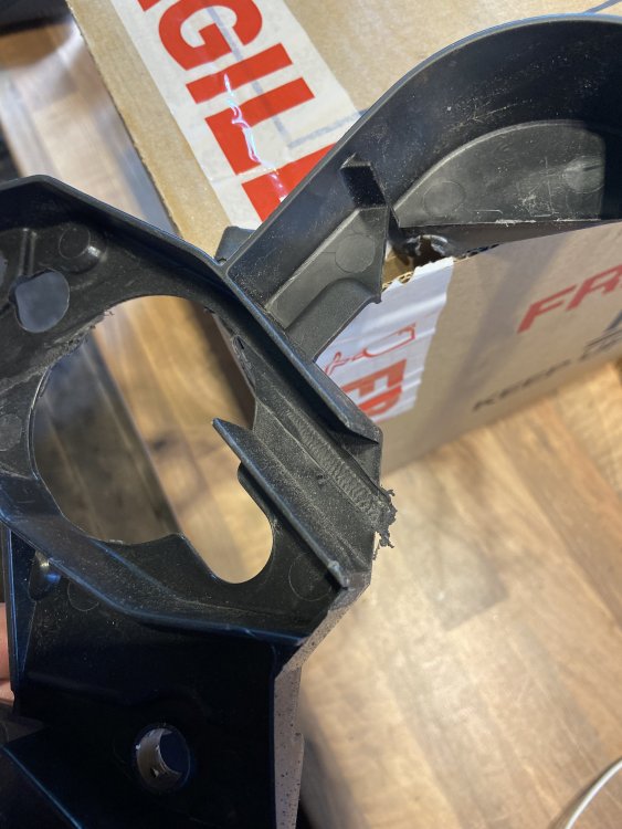

LucasDunkley
Thanks for the advice, I think I have now found the problem.
It’s the inner cambelt cover and it is rubbing in the water pump area. You can manipulate the cover with the car running and the sound goes away.
Does anyone have any tips as to how to remedy this. There’s only a handful of fixings that hold the cover on so not sure what I can do differently.
Cheers
Leslie green
Posted (edited)
The inner cover is very flimsy and relies on the outer cover to hold it in place , I have original earlier style covers on mine and I think they were better.Its a while since I fitted mine as the ones on the car were all rubbed too and had broken tabs. There isn't much room when the engine is in the car to see what you are doing and mine were fitted before the engine went back in.
