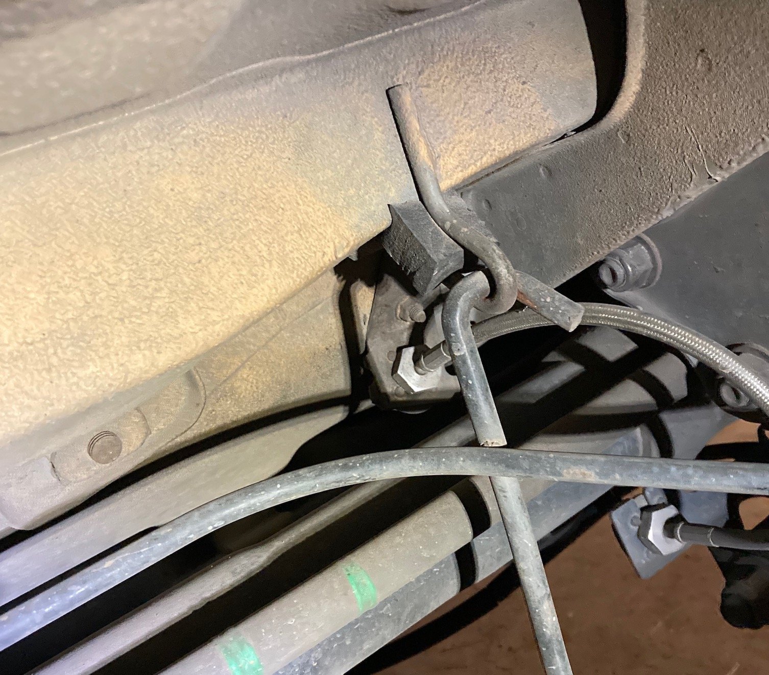

surfer69 2 1 Cars Posted March 5, 2025 Hi everyone,right,I’ve just had to remove my spare wheel carrier but to remove it I had to remove a plastic clip to allow me to lift the hinged side up and to the side to drop it down.On removing the plastic clip it snapped.Any ideas on where to get another one or even what it’s called.Huge thanks in advance. Share this post Link to post Share on other sites
Tom Fenton 1,633 Posted March 6, 2025 It might be available from the main dealer, I've never tried. A bolt and nyloc nut and a couple of washers fitted in the loop will perform the same job and stop the cage from being able to get out. Share this post Link to post Share on other sites
Gohn 73 Posted March 6, 2025 part number's #761906 if you can order it or mine was missing when purchased a few years ago I cut a rubber wedge and its good Share this post Link to post Share on other sites
Leslie green 162 Posted March 6, 2025 (edited) I never even knew there was such a thing , will probably just employ the nyloc as well but I dont have a spare tyre yet just the alloy so leaving it off for now Edited March 6, 2025 by Leslie green Share this post Link to post Share on other sites
welshpug 1,723 Posted March 7, 2025 The cage wont fall out if it has a wheel clamped in it, the clip is just there to stop it rattling around when empty. 1 Share this post Link to post Share on other sites
