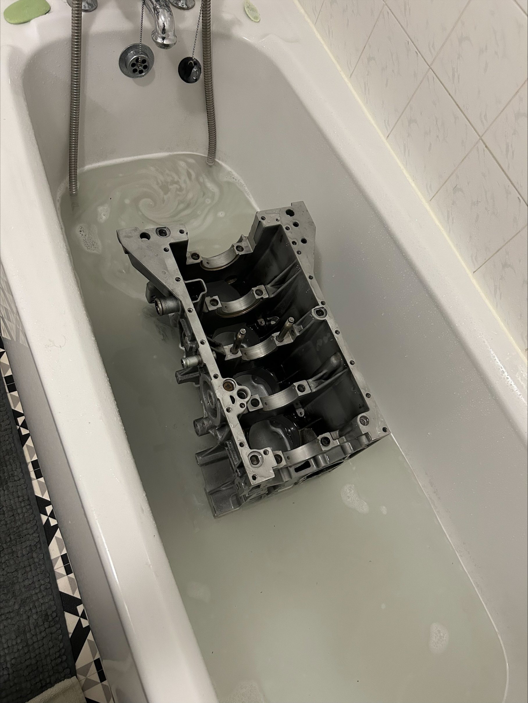

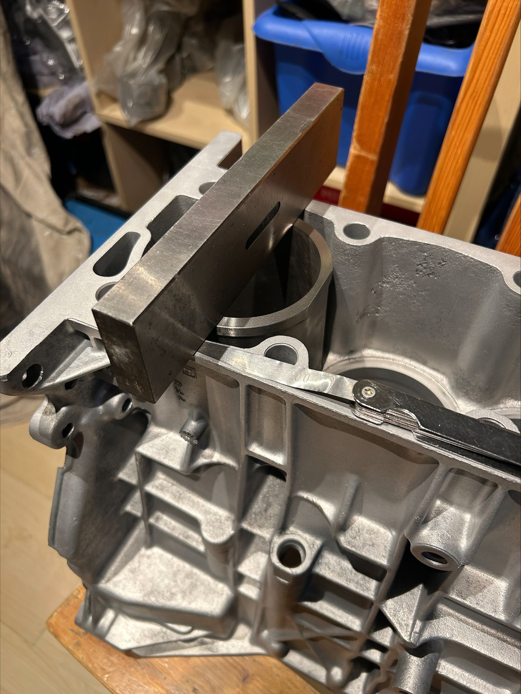

The 1215 that i bought seemed to have the same spec as the one you recommended , just the colour was different . I am going to paint the cam covers in black VHT wrinkle paint , i am currently experimenting on a piece of steel and i can't get it to wrinkle at all at the moment , 3 coats on as instructions state and no wrinkling so have put a 4th on and will check in the morning . Will use satin black engine enamel if i have no joy with the crackle finish . The block is mint after wet blasting and i am not taking any chances with the glass beads so it was in the bath with the shower head cleaning out all the oilways with the help of bottle brushes . Liner ( Goetze ) protrusion looks good as well , i have a bit of pitting from corrosion of the inside of the block , is there anything worthwhile to apply to protect for the future .

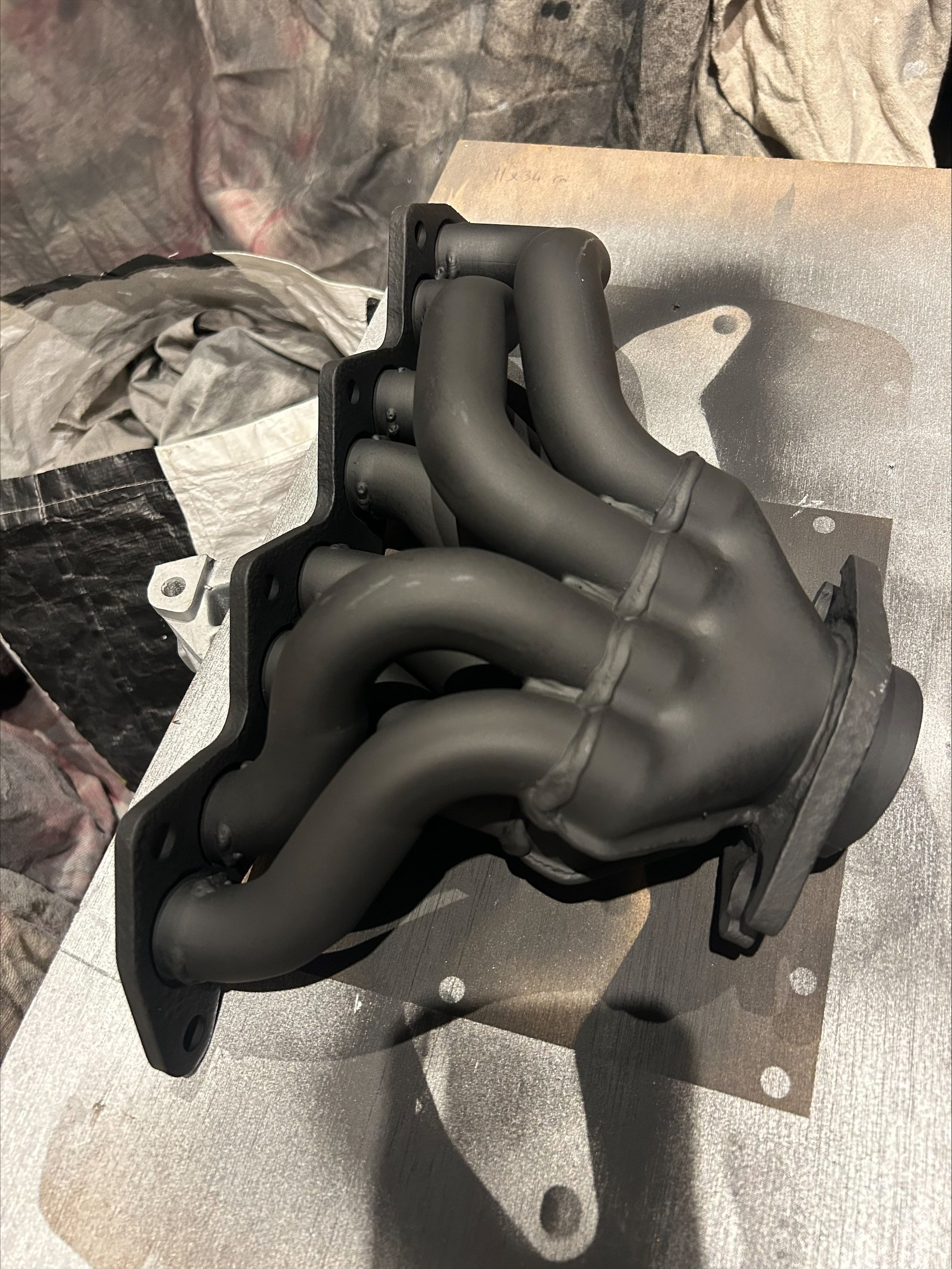

Have put several coats of black VHT paint on the exhaust manifold and cured it in the oven ,
Black ceramic coating would have been nicer. It's not too late.

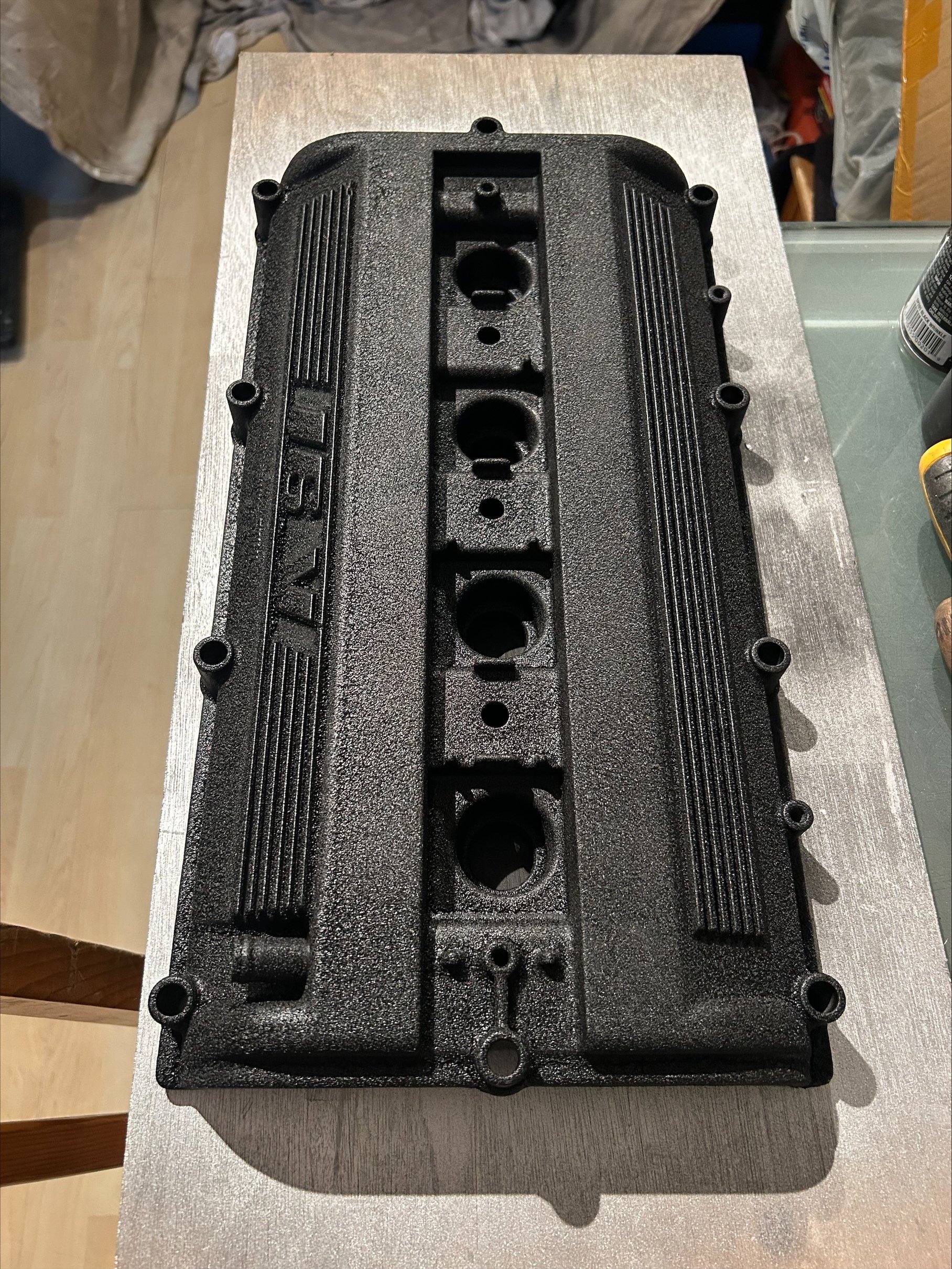

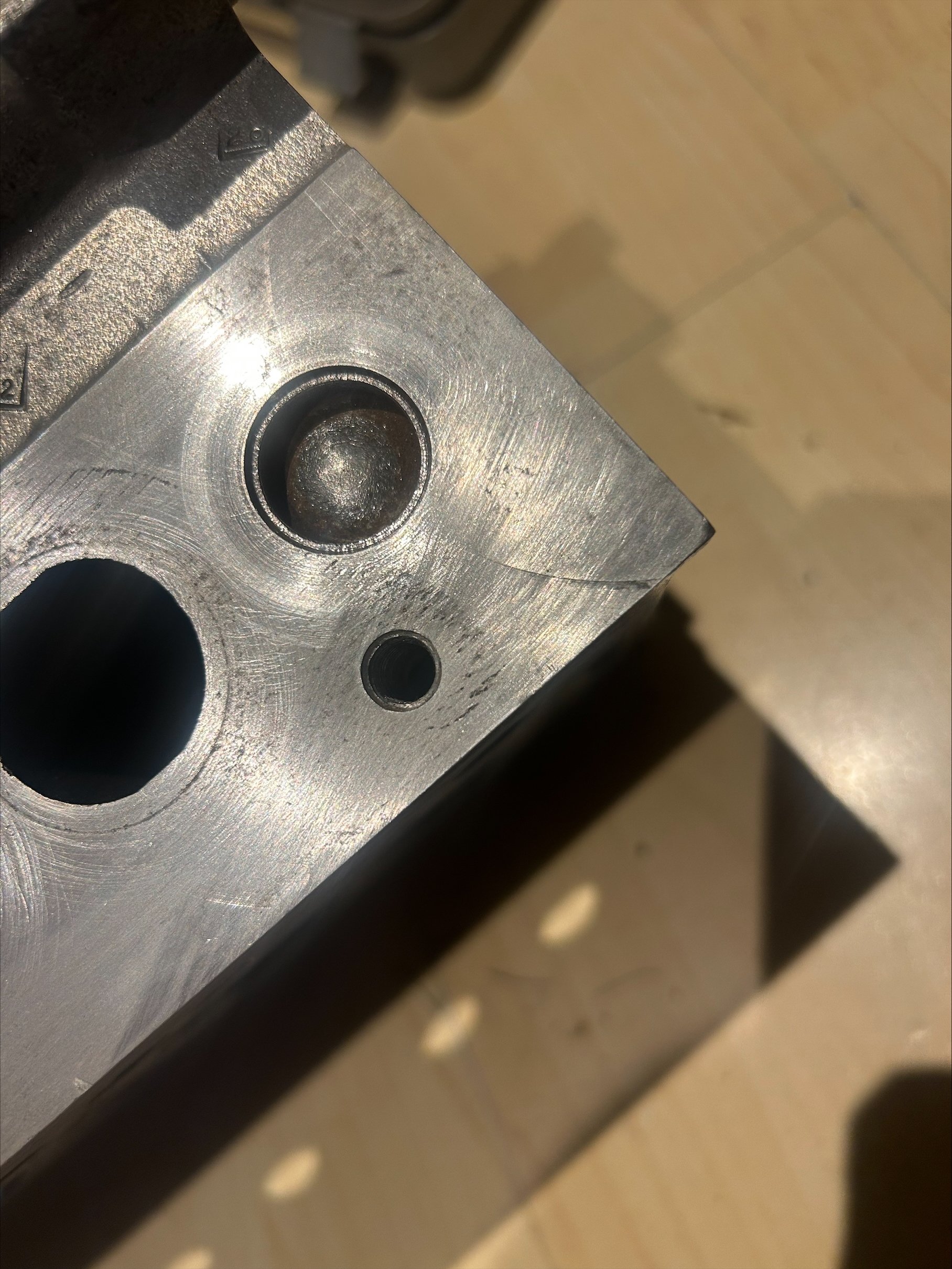

After i cleaned the head up properly i gave it a proper look over as the popped out core plug is a possible sign of the engine freezing up , sure enough i found a hairline crack running from one of the small core plugs ( which had not pushed out ? ) i had thought it was just a sharp scratch on the casting . Put this head back on the shelf and have stripped another which is in better condition all round . Tried the VHT wrinkle finish paint on 2 cam covers , it didn't look like it was going to 'crackle' but it did overnight . I put 3 heavy coats on as per the instructions but in places its probably too much so if i do another cover it will be 2 heavy coats . Have wet sanded the ribs .
mmt
Looks mint. Well done.

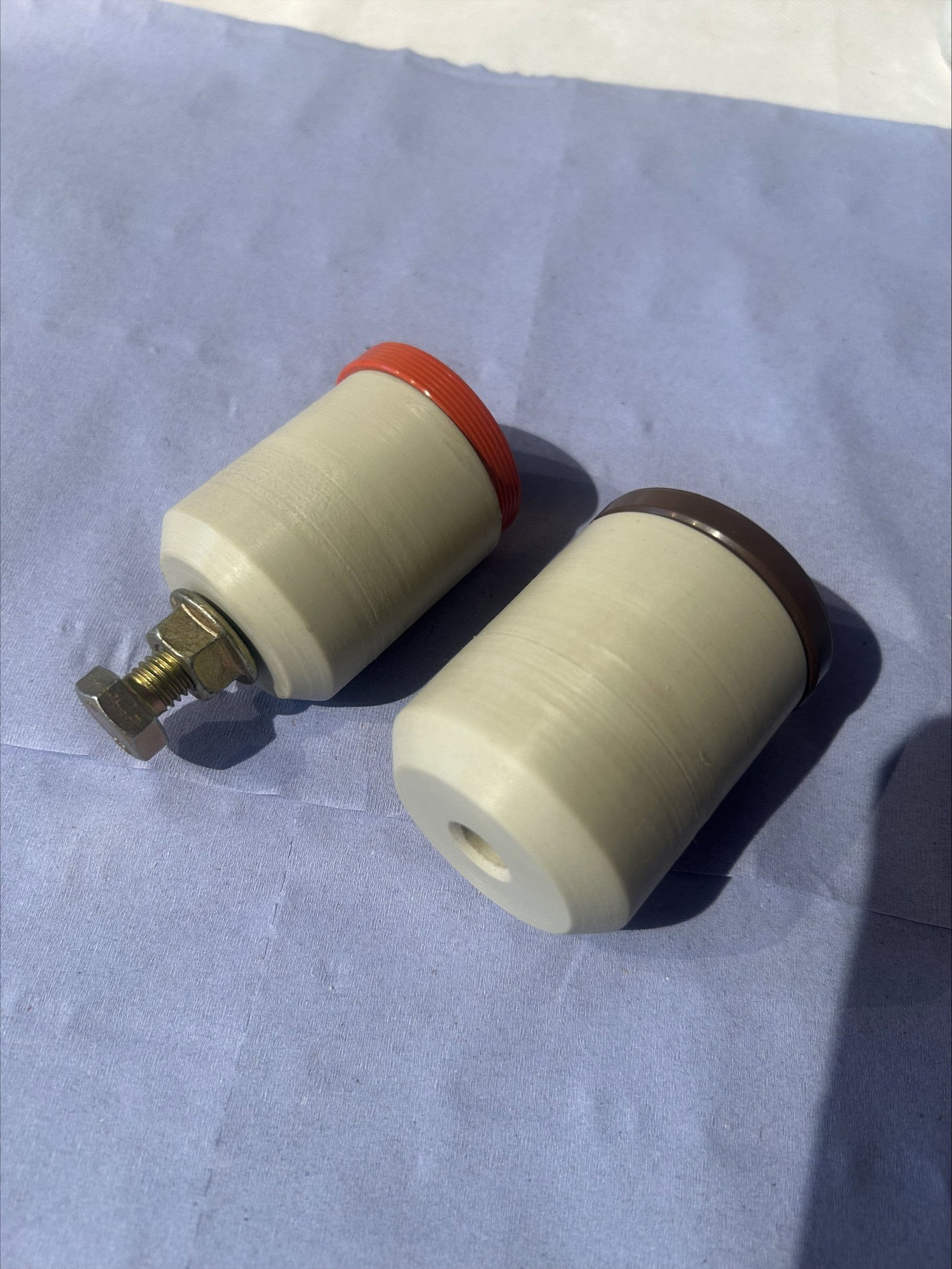

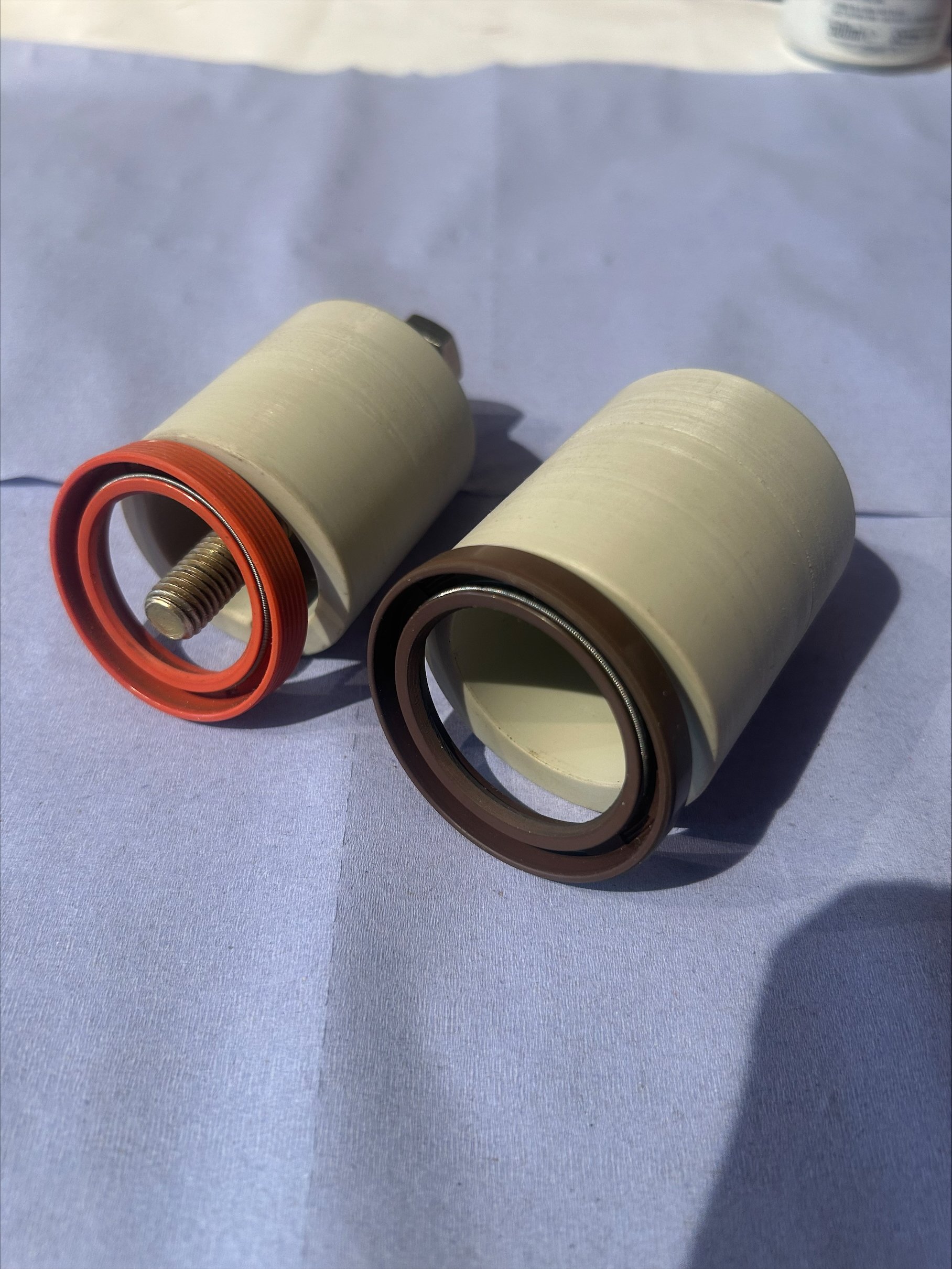

Turned up a couple of tools out of nylon bar to help fit the camshaft oil seals so they go in nice and square .
Nice! I have a tool which makes them finish flush with the outer face, thus they have to be square.

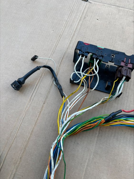

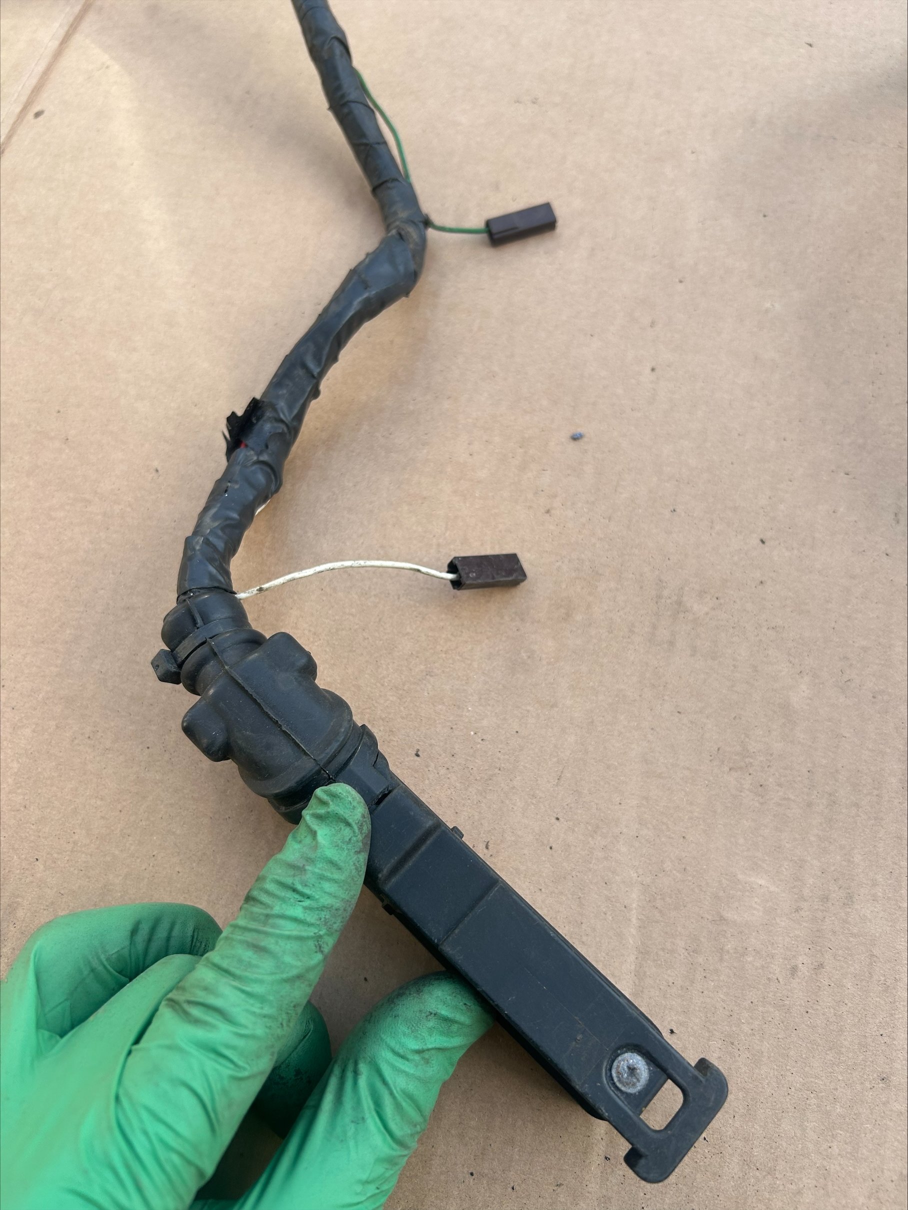

I have been having a good look at the loom that i picked up with the engine and box , it was cut where it goes thru the bulkhead i think but is in pretty good shape and after stripping the tape and plastic conduit off of it i have found what most wires are for by referencing the Haynes 405 manual . Mice have been at a couple of the wires to the injectors and some plugs have been damaged by forcing them off without removing the wire retainer , i have loads of spare black ones but will need a green 2 way for the injectors . The layout of it all is quite different to a 309 GTI loom and until the engine is in the car i will not start cutting anything but i may have the ECU in the glovebox area or near the steering column . I have a number of wires that seem to be used for diagnostic purposes ( black 2 way and single white wire near relays )+( 2 single wires near ECU plug )  and could well relocate them close to the ECU , i have found the wire in the loom that goes to the diagnostic light on the dash of a 405 , i assume i could use a spare light space on the 309 GTI binnacle that i have fitted to read the flashes etc . If these diagnostic connections are obsolete and of no use i am happy to remove them all but if they are still useful they can stay .

The 309 instrument cluster can have the correct engine light if it isn't too old, it's on the top right corner of the rev counter.
match-peugeot-309-gti-16-308-gti-2018-39
The diagnostuc 2 way connector is limited yet usefull, if needed it can be used even without the light on the dash.

When I convert a GTi Jetronic car to Motronic, I use the choke light as the engine management light. It's wire #75 and usually just hangs there, behind the cluster, doing nothing. The later GTi's in Aust. are all Motronic anyway, so they're a relatively easy conversion.
