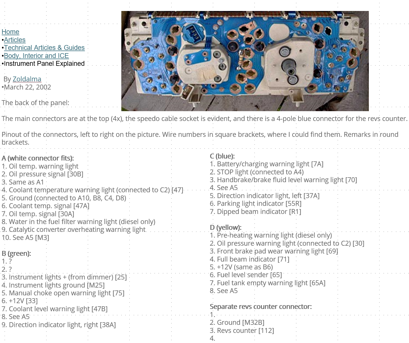

ArthurH 8 Posted September 16, 2024 I'm building a new loom for our car. I'm retaining the original gauges, so I am starting with Zoldalma's excellent 'article' - Instrument Panel Explained - from 2002! Most of it makes complete sense to me, but I am confused by having two pins for the oil temp: A1 is the Warning light and A7 is the Signal. Can someone please expand on this? Similarly two separate pins for for the coolant temp and another two for oil pressure. Again, D6 is the Fuel level sensor and D7 is the Low fuel warning light. Are there two wires from the sensor? Share this post Link to post Share on other sites

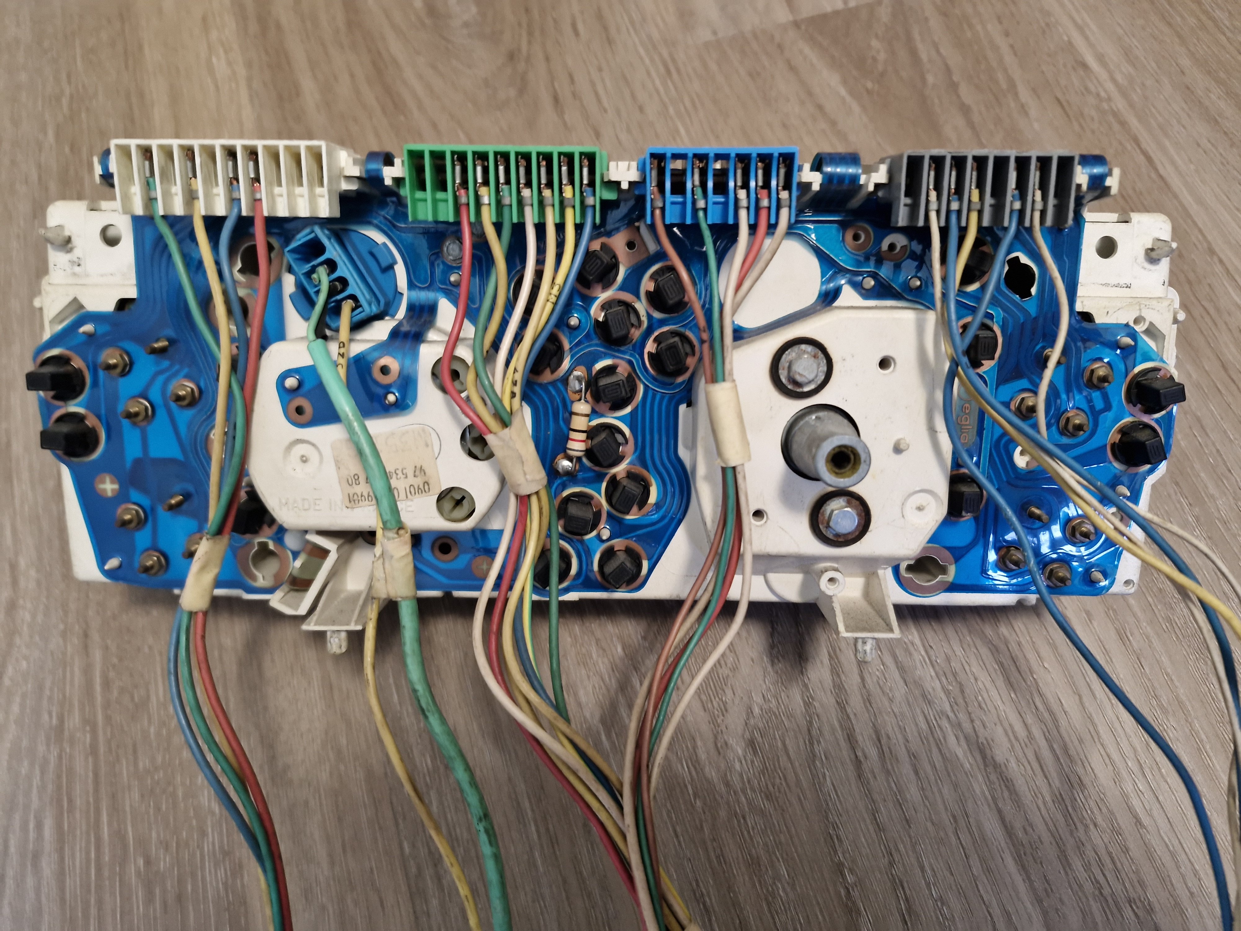

ArthurH 8 Posted January 7 Now that I have finally come to wire up the dash (having spent literally weeks on the wiper autopark ) I have discovered that my dash connector wiring differs from that posted by Zoldalma above. Many of the wires he describes are simply missing from mine, but I don't think mine has been modified or tampered with. Could someone please post a photo of the back of a Gti instrument cluster - but with the edge connectors still in place so I can see the wire colours? TiA Share this post Link to post Share on other sites
ArthurH 8 Posted January 8 This is what my own dash and connectors look like: The fourth connector is grey (not yellow) but I doubt that matters. Zoldalma describes these five connections as 'Ground': A5, A10, B8, C4, D8. Where I am currently concerned, is that only one of those is present in my connectors. A yellow wire in B8 - which doesn't look like a ground. The Tacho connector does have a black ground connection at E3, but I doubt that is used for the whole cluster. Share this post Link to post Share on other sites
ArthurH 8 Posted January 31 To my surprise, I have managed to work out which of the connectors I need to do what I require from the dash. The only one I am struggling with is the dash illumination. According to Haynes, this is wire 14 (green connector #4), I have this wire and indeed, it used to go to the dimmer. But if I provide 12v directly to G4 nothing lights up. I want to buzz it backward from the bulb 'socket' on the PCB but, embarrassingly, I can't tell which bulbs provide the dash illumination (as opposed to warning lights). Could somebody please mark up my photo above? TiA Share this post Link to post Share on other sites
