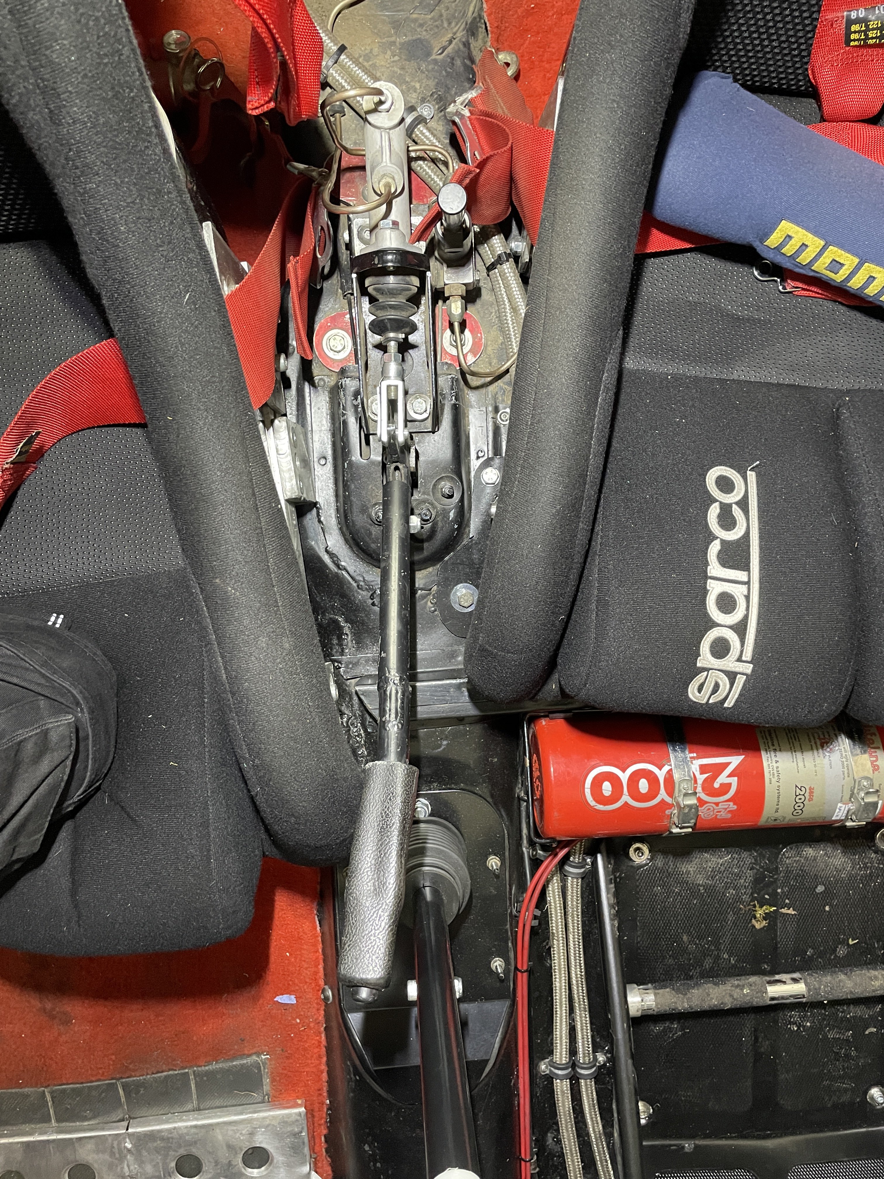

This is my set up at the moment. Extended and strengthened standard lever, to a0.625 cylinder and standard cables, on drums. The lever is converted to fly-off.
A definite improvement. An earlier version was even longer and actually not bad, but required too many compromises with gear lever position.. my first step will be to fit standard discs and calipers from a donor axle that I’ve sourced. This will be with a vertical set up hydraulic lever. I’ll retain the standard lever for MOT. Conscious of Tom’s advice, I’ve got a screw adjustable bias valve for when/if I have to change the rear calipers. I’m not sure that the AP Valve will give me the precise adjustment to control the foot brake with the bigger piston caliper. I’ll be making the vertical set up over the next few weeks.
