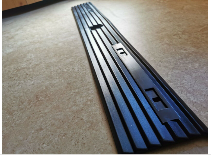

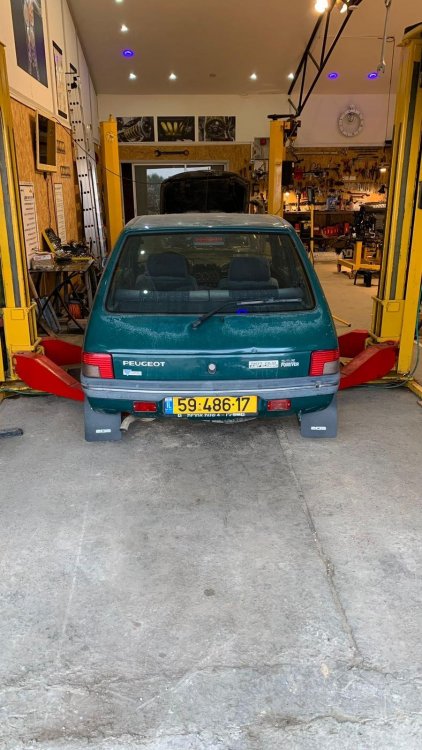

amitai12 1 Posted June 26, 2023 does the pegugeot 205 gti Tailgate Panel also fit to the peugeot 205 1.4 forever model 99? attached photo of my car and the part i want to buy: thanks. Share this post Link to post Share on other sites
j_turnell 137 3 Cars Posted June 26, 2023 Yes it will, although you will be relying on the sides and boot lock to hold it on. Normally there are rivets and clips under the badges, also a small hole for the plastic peg to go through that you won’t have. Share this post Link to post Share on other sites
