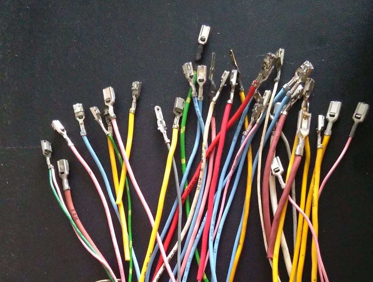

Ryan 99 Posted July 18, 2023 I don't know to be honest. The last time I asked was maybe 2014, and I didn't buy them because the ones I wanted were £1 each and only came in bags of 50. I don't have any new terminals, but I've got a few 20-30cm loose wire ends I stripped out of old 205 and 106 looms that I kept just in case I needed them. I can stick a few in an envelope if you want? 1 Share this post Link to post Share on other sites

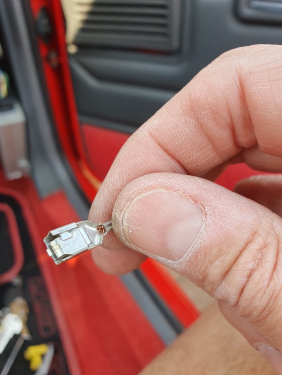

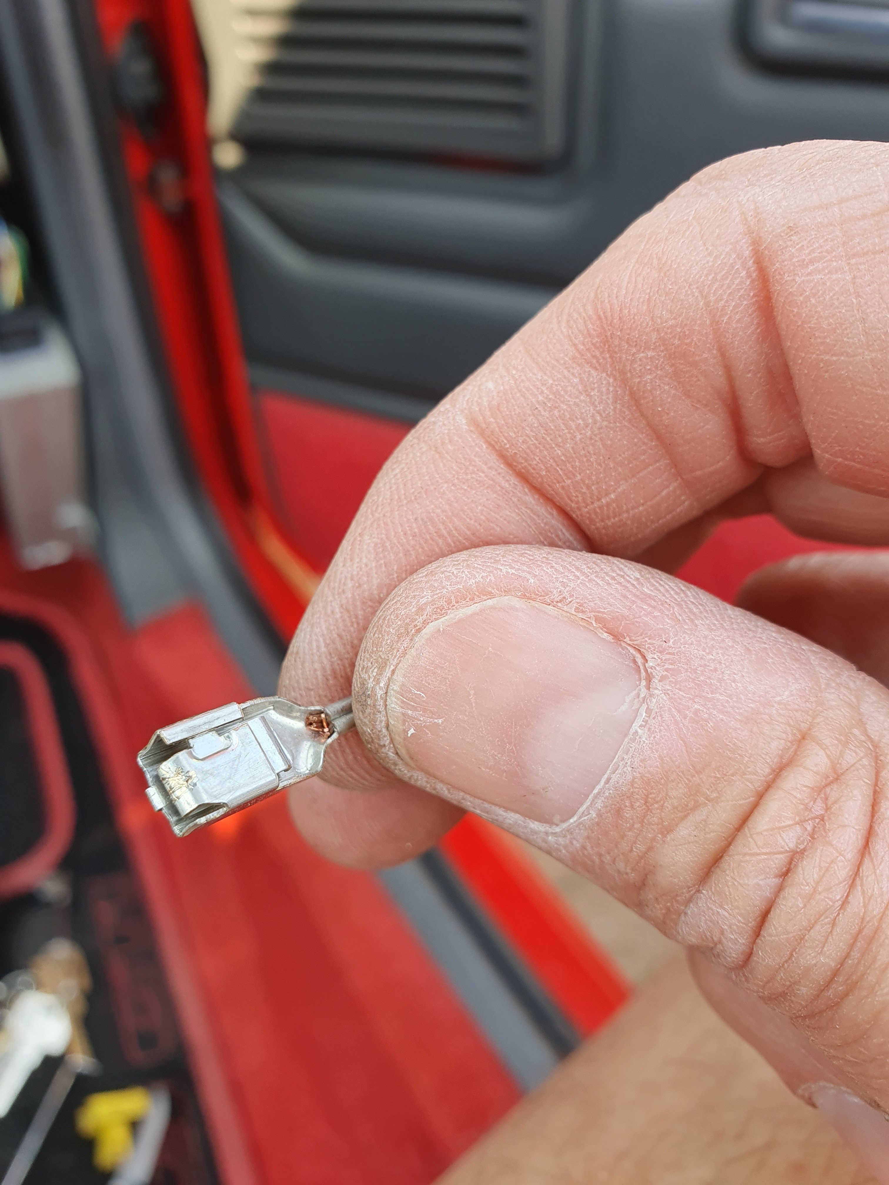

Phil Gti 11 Posted July 19, 2023 What are the chances of that, someone else posting the same question I was going to ask. I need x2 of them for the brake fluid cap connectors. Share this post Link to post Share on other sites
Ryan 99 Posted July 22, 2023 The connections on the brake fluid cap are just normal 6.3mm spade terminals. They're not the odd Peugeot-specific ones. Share this post Link to post Share on other sites
Phil Gti 11 Posted July 22, 2023 The ones I have seen in motor factors are to fat to fit into the original plastic connector and don't have the tab to secure them. I assumed these were Peugeot specific as I have also searched online for them and can't find the correct ones. Share this post Link to post Share on other sites
